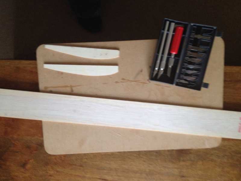

Well I have done a little bit tonight I have cut from ply 2 blanks as has been suggested and then I have roughly cut out some of the wing ribs ready to be sanded all together.

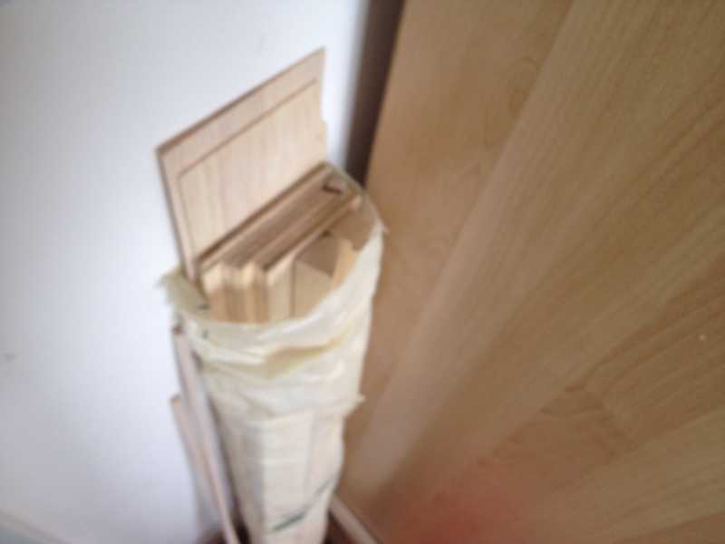

This is the small selection of balsa I got given

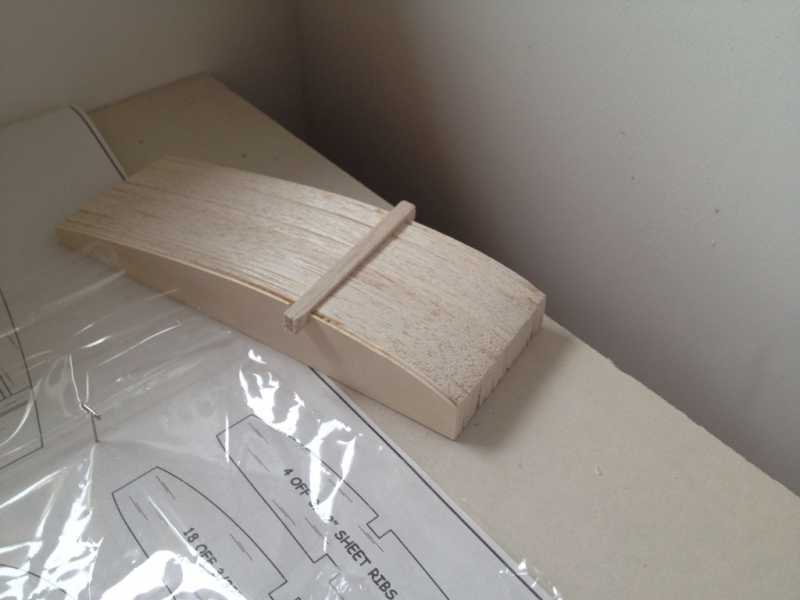

The ribs clamped together and sanded to shape just in the process of doing the cut outs for the front and rear spars.

  • Dean M
12 Jun 2012 00:47 #13 by Dean M
Replied by Dean M on topic Re: Sandow build
After being whipped by the boss :lol: :lol: :P I have done a bit more.
Ribs all sanded to shape and spar cut outs cut out! :whistle:
And something that looks wing shaped, this is just dry fitted.
I know this is no where near as complicated or fancy as anything like what Tony, Grumpy etc build but I am really chuffed with how good all the bits are fitting together and the fact I made the bits!!
Thanks for all the advice so far.
Dean
I nearly choked on my latte.
