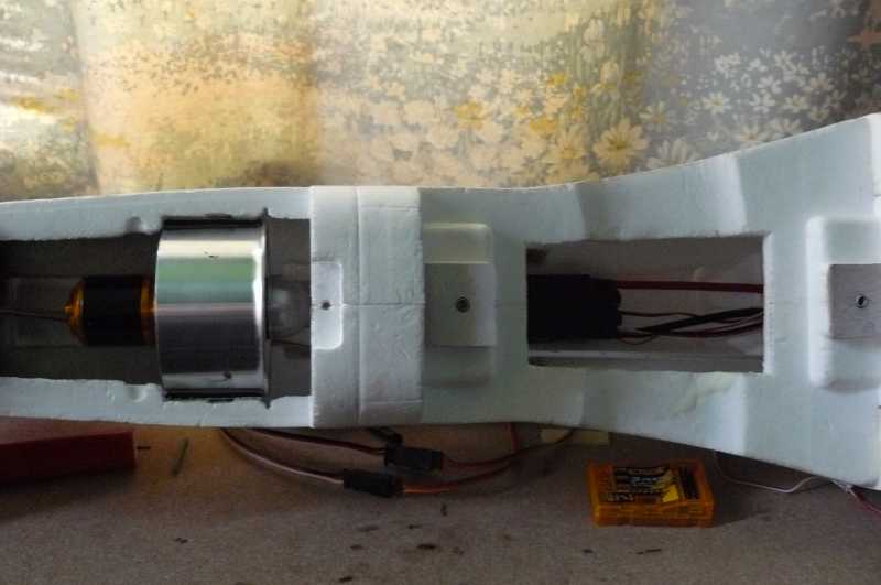

this is what i doing its a t45 goshawk or bae hawk it has a 64mm lander fan 80amp esc i have disabled the bec and running a ubec. the other bits are retracts,lights includes a afterburner light.

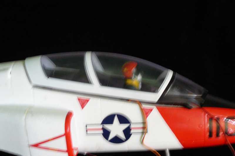

  • a4kskyhawk
04 Nov 2012 01:28 #5 by a4kskyhawk
  • a4kskyhawk

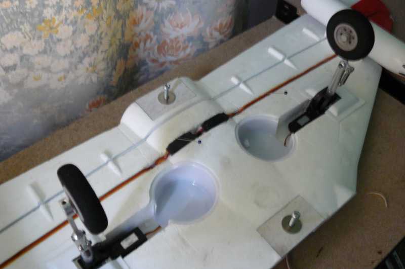

04 Nov 2012 06:09 #6 by a4kskyhawk
Replied by a4kskyhawk on topic Re: edf bae hawk or t-45 Goshawk rc lander

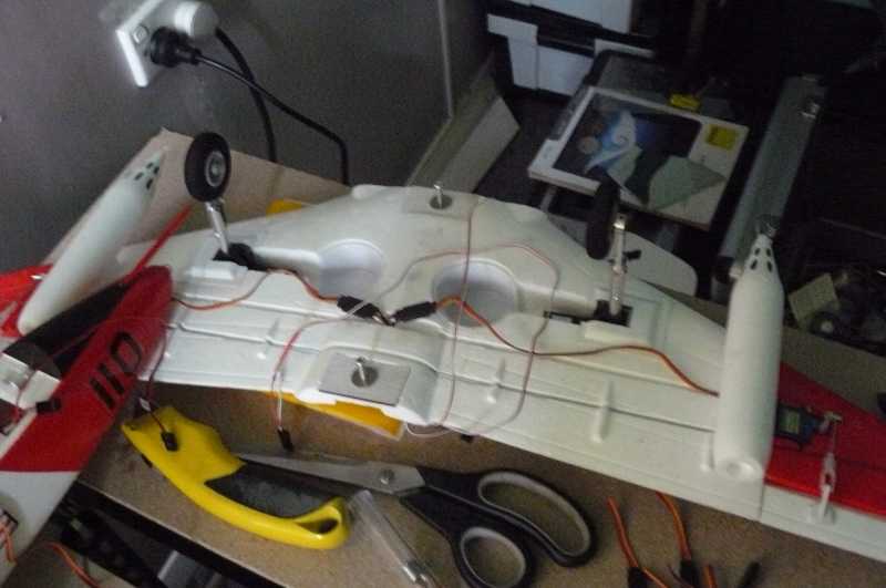

done some work on it placed the wires and glued them in place, done canopy

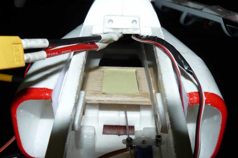

test fit the wing and wires covered wing servo wires , now make up a plate for stabliser.

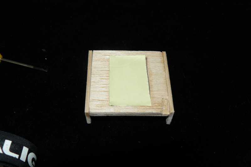

  • a4kskyhawk
05 Nov 2012 08:16 #10 by a4kskyhawk

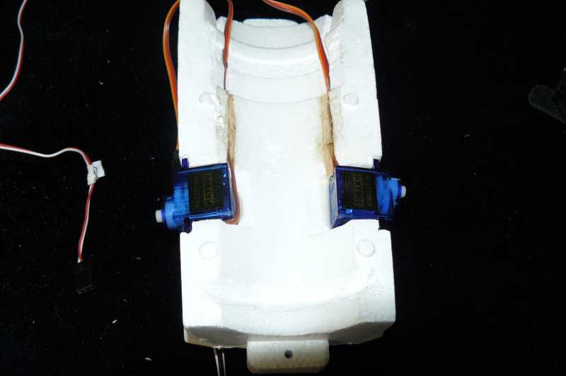

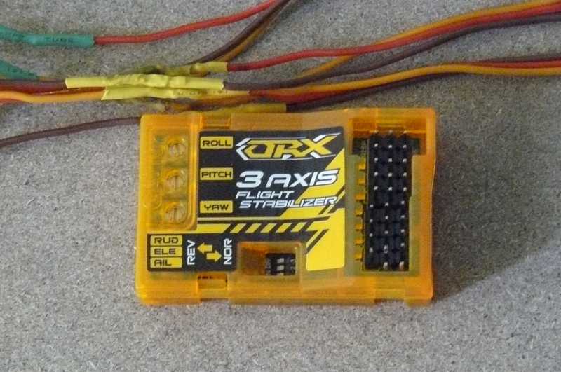

done some more today made mount for gyro stabliser, put servos in tail mount i have reversed them so i dont have to buy a servo reverser.
07 Nov 2012 00:33 #11 by Phil Wood
Replied by Phil Wood on topic Re: edf bae hawk or t-45 Goshawk rc lander
a4kskyhawk wrote: done some work on it placed the wires and glued them in place, done canopy
Probably worrying too much here Sky, but a little concerned about this "glued in" wiring.
The wires look very neat, but they also look stretched to full extent.... those wings will flex a hell of a lot more than you may imagine ... especially with a hard landing .... this may mean the wiring needs a bit of slack so it doesn't pull on the joints. ???? :S
  • a4kskyhawk
07 Nov 2012 03:22 - 13 Nov 2012 15:31 #12 by a4kskyhawk
thanks poly for concern , just above the wheel well there is about 5 to 10mm in a trench and above that is a rod the length of wing
