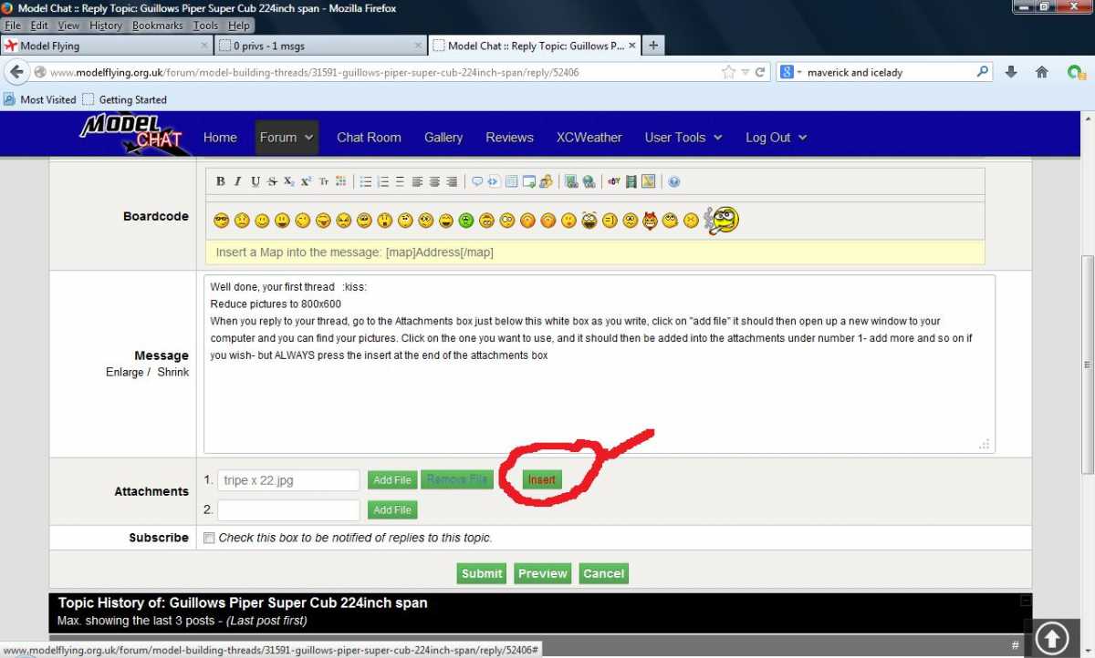

05 Feb 2014 20:58 #3 by Sarah-Jane Smith
Replied by Sarah-Jane Smith on topic Guillows Piper Super Cub 24inch span
Well done, your first thread :kiss:
Reduce pictures to 800x600
When you reply to your thread, go to the Attachments box just below this white box as you write, click on "add file" it should then open up a new window to your computer and you can find your pictures. Click on the one you want to use, and it should then be added into the attachments under number 1- add more and so on if you wish- but ALWAYS press the insert at the end of the attachments box
and it should add your picture into the text box itself.

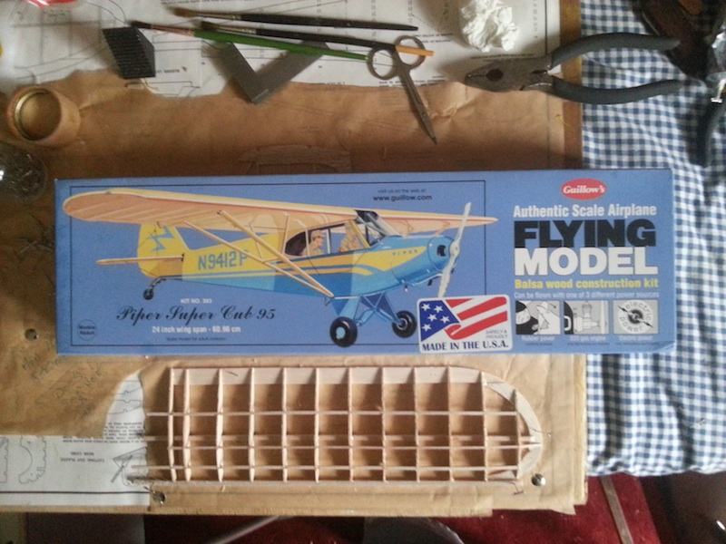

06 Feb 2014 16:28 #9 by Gary
Replied by Gary on topic Guillows Piper Super Cub 24inch span
Ok so now I have a couple of pics, I shall post them to see that the system actually works.
This is the Guillows Piper Super Cub and the plan and contents are dated 1965. I bought this kit a few years ago and put it to one side in my workshop. I want to fly scale type aircraft in our gymnasium with electric power and this size of model came to mind. I hope to use two micro servos an rx and an outrunner motor. This is the kit and I know that it is still available in Hobbycraft stores at around £18.00.

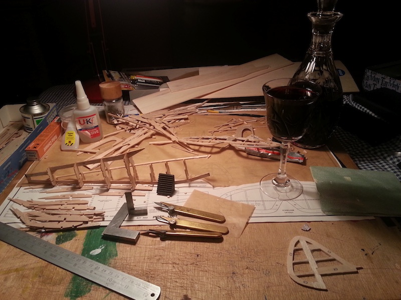

06 Feb 2014 16:37 - 06 Feb 2014 17:47 #10 by Gary
I was trying to explain to Sarah how a small model can be put on a board and moved around without disturbing the build. This shot shows the ribs cut out, the fuz partly assembled, and the tools that I am likely to use for the build.

06 Feb 2014 16:57 - 06 Feb 2014 17:13 #12 by Gary
That M'dear is where you is going wrong. Not just any port but a decent vintage LBVP.
Sarah, you asked about polythene the other day. You can see that I use greaseproof paper shiney side up. This makes the plan a little less clear, but nothing sticks to it including port splashes.
Gary

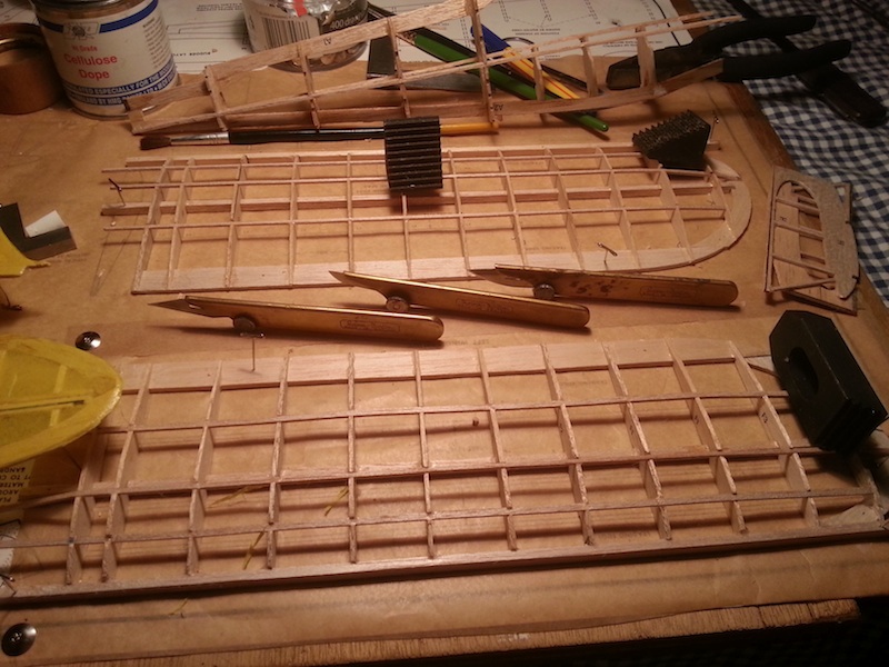

06 Feb 2014 17:06 #13 by Gary
Here are some pics of the wings being put together. It can bee seen that I am quite happy to put pins through the wider balsa components and use pins either side of the thinner section secondary spars / leading edges. I do pin through the leading edges that extend past the point where they will be cut off as any pin damage here is irrelevant. I then use small metal weights to keep these pieces in place for glueing with balsa cement. These weights are any old item I have available in the workshop. The ones shown here are from a Picador clamping set.
Cyano also gets used from time to time for it's ability to hold rapidly.

06 Feb 2014 17:17 #14 by Gary
A view with the pins in place
