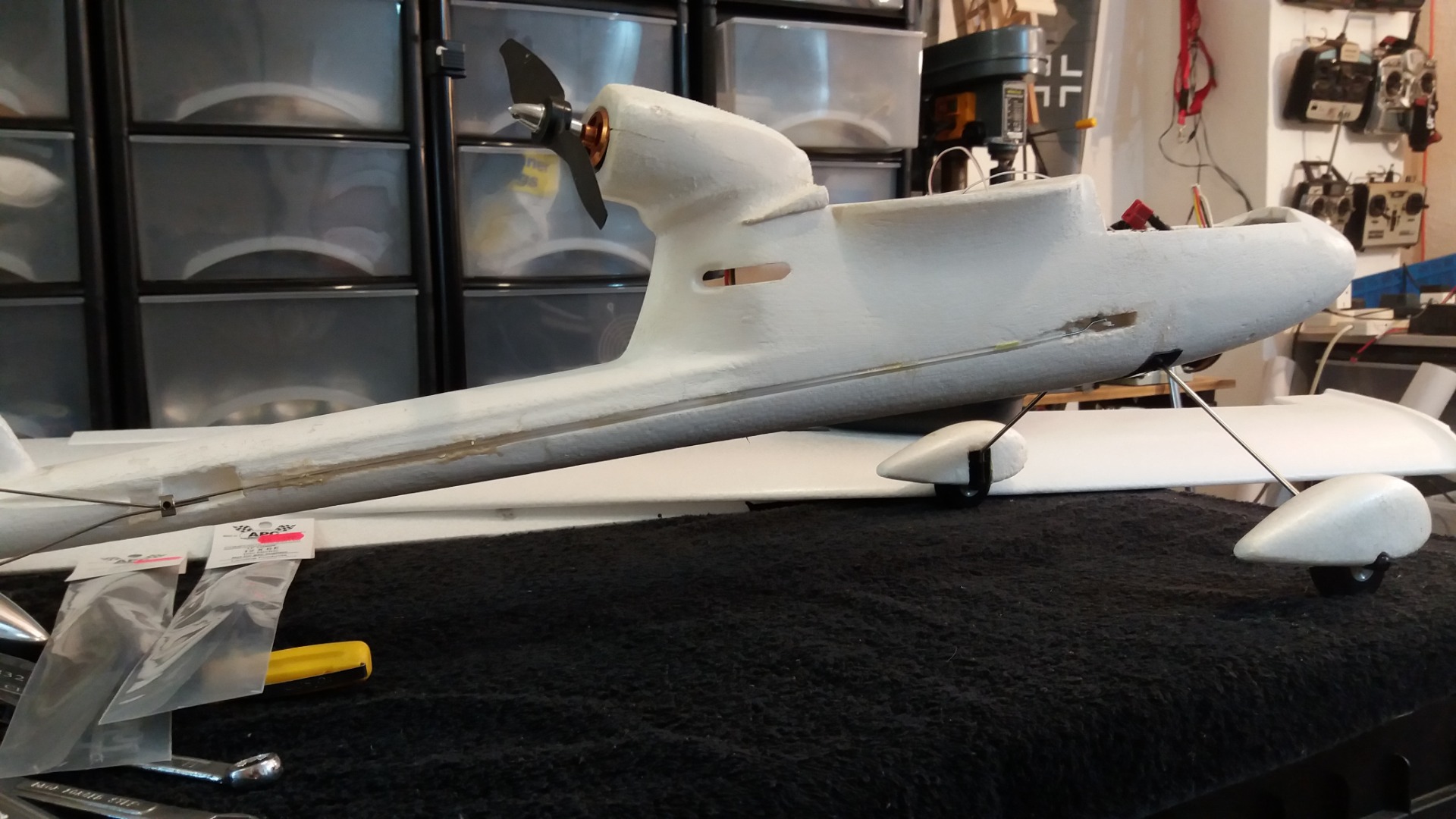

I agree with acrylic, household emulsion and water based gloss are also a type of acrylic paint, the key point is that they are water based and not solvent based. I broke the fuselage of my Bix 3 completely in half and repaired it with a carbon fibre tube and epoxy. I then used white emulsion to paint over the join, sanding between coats. ..... It was very rough brush job and I'm sure I could have got a much better result with a roller or spray, but I just wanted to get the thing flying again quickly.
The break is just under the motor where the Fuz goes narrow. As you can see, with a bit more sanding it could have been a nice smooth finish. A coat of clear lacquer might have helped as well. ..... You have a great range of cheap colours by buying the little emulsion tester pots as well. :lol:

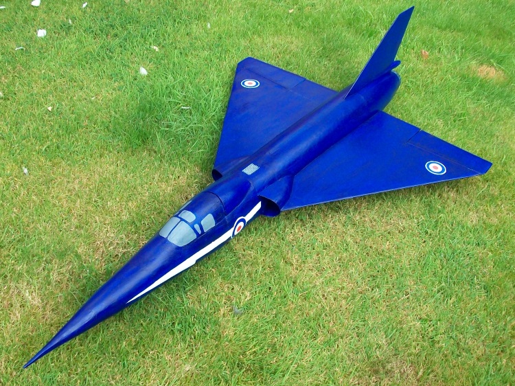

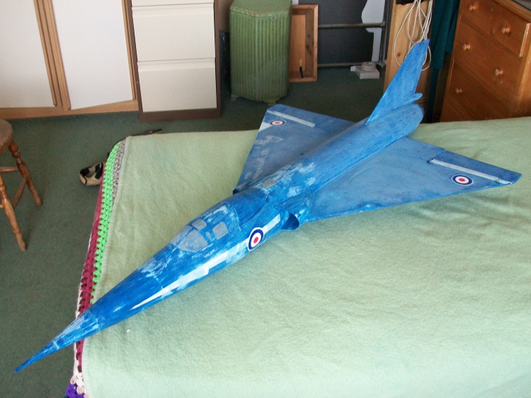

I have sprayed acrylic painted Depron with car clear lacquer to get a glossy(ish) finish but only by using very light coats and being super careful to avoid creating local 'wet' patches as these soften any previous lacquer coats, then the acrylic paint, allowing a chemical attack on the foam. Whilst not usually structurally serious its does rather ruin the gloss effect you are trying to achieve!
The only recovery I have found is to leave it for several weeks to fully harden and then to 'start again' rubbing down with wet and dry.
My Fairey Delta had the benefit of this approach.
It went from this dead matt (actually emulsion) as built.
Sanded to this.
To this acrylic paint + lacquer
And it probably helped that the original paint had dried for 2 years before it was repained!
