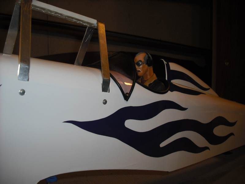

Hi Tony I use a few differnt kinds,I like Poly-Cover think its from over ur way,It was called Oracover n changed names a few years ago,It is a low heat covering sticks good to it self n
shrink's good also,U will need a covering iron and a heat gun for shrimking,I also use Mono-Coat
lots of colors but takes alot of heat to activate to adhesive n shrink,there is a bunch of videos on You Tube on covern thats where I learned some Kool stuff,Your a half a world away n I dont no what u can get but I will try n help,Here's a pic of the fancyest one I've done It's coverd with Mono-Coat Medium Purple n White,Was a bear to get it stuck took alot of heat,It's a Sig Hog Bipe,
Thunder Tiger 61,This Plane was my second Kit that I built n coverd,I will Help u all I can!!!Thanks Les
