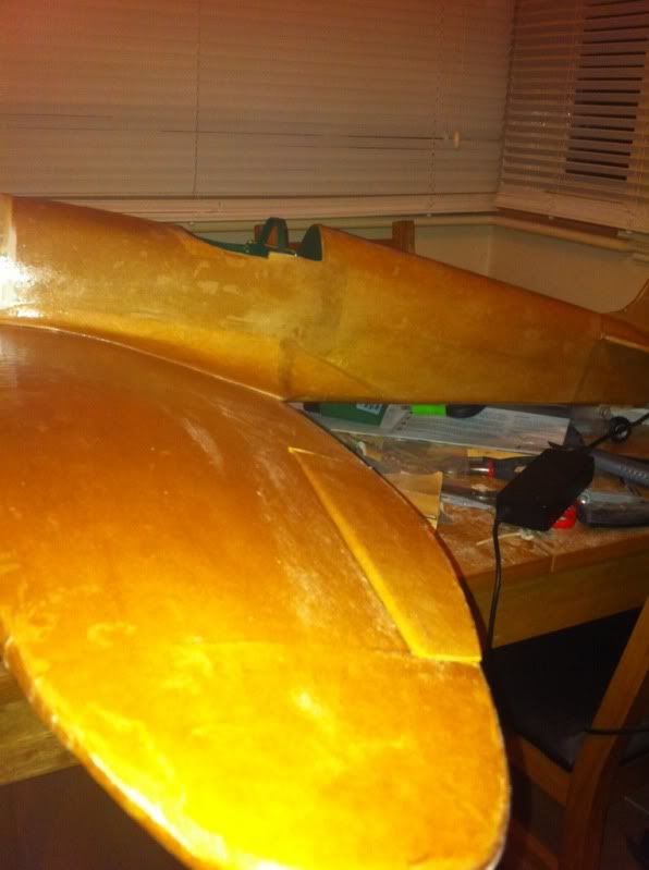

Little offering up of the fuselage to the wing section.
File Attachment:

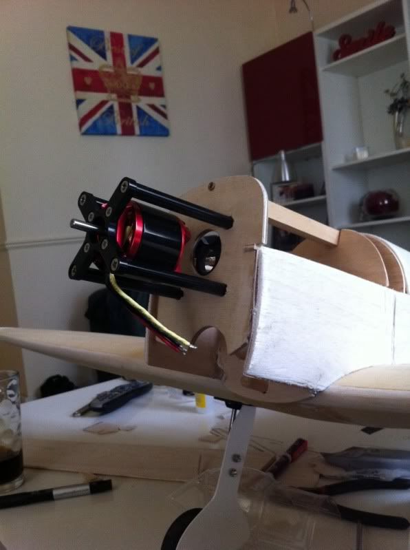

The engine fitted....this is a major problem because I don't think it's powerful enough and needs to be changed...???
File Attachment:

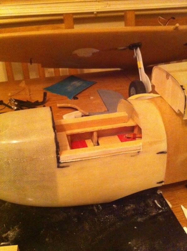

My butcher job on a battery hatch.

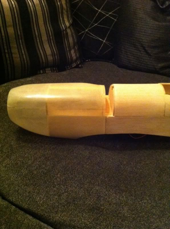

Nose section...testing spinners.
File Attachment:
Misunderstood someones advice and put dope at full strength over wings and body...oops :woohoo:
File Attachment:

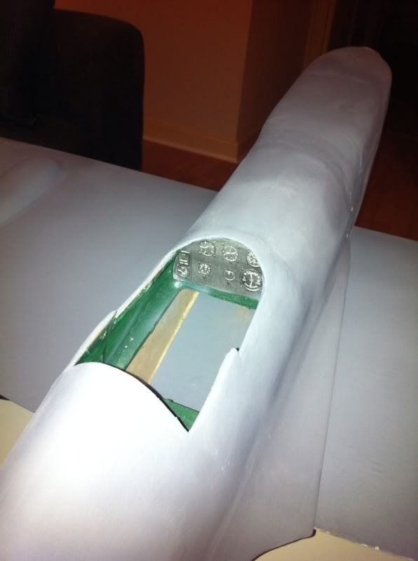

Inside isn't too detailed but a cockpit will go in of sorts.
File Attachment:

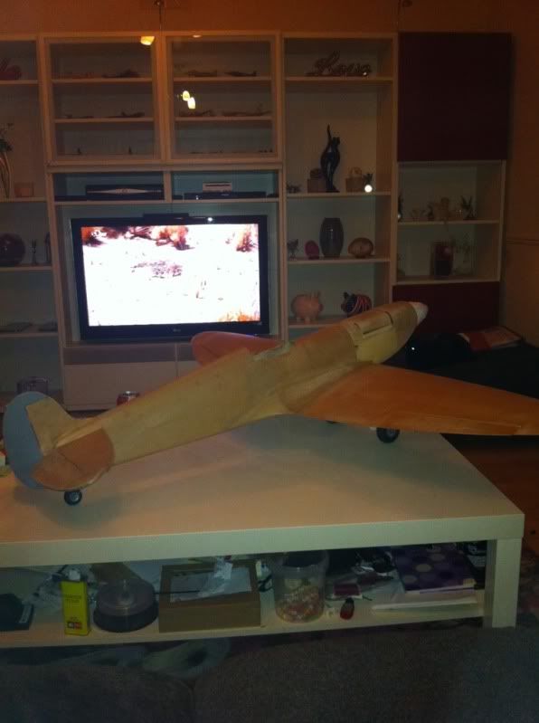

Smoothing the nose section...making it look more "right"
File Attachment:
Really wasn't happy at this stage because the nose looked horrible but I got it nearly right further on.

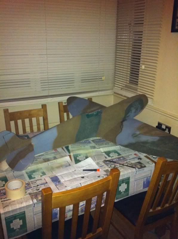

Spraying the underside duck egg....not a good idea in a little flat.... :sick:
File Attachment:

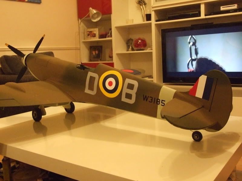

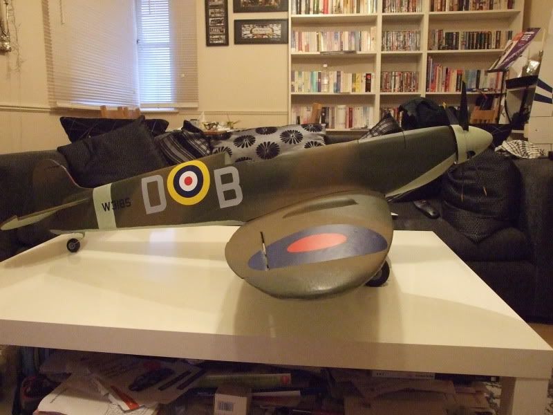

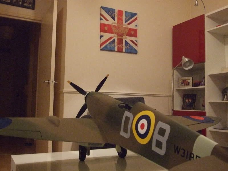

OK are you ready to see where I finished up ? Now bare in mind she's never flown and still in the state you see next... :blink:
File Attachment:
File Attachment:
File Attachment:
File Attachment:
Not great but not bad for my first ever build.
Sorry I have lost many of the in between build photo's and these are all I have left. She need's butchering again now to get the engine out and replace it , I'm not looking forward to that job :unsure:

10 Feb 2014 12:19 #9 by Phil Wood
Replied by Phil Wood on topic My Warbirds Spitfire Electric Conversion.
Can you remember the motor spec's Tony?
One thing that springs to mind is that heavy coat of dope, undercoat & top coat ..... you may be a bit over the expected weight, but nothing that a load of power won't sort out.
Am I correct in thinking they are foam veneered wings? .... you'll probably be lucky, but doping veneered wings can sometimes cause problems if the dope soaks through the veneer. It sometimes causes the veneer to come unstuck from the foam. .... Drop a bit of dope onto some scrap foam & watch it dissolve.
Leave the motor & battery until last & get an "all up weight" first ..... the rest is easy to work out.

Tony F wrote: Sorry I have lost many of the in between build photo's and these are all I have left. She need's butchering again now to get the engine out and replace it , I'm not looking forward to that job :unsure:
Tony
You'll need some system of being able to gain easy access to the motor, you may want to alter side or down thrust after its maiden .... you may even decide to change it at some point.
Don't forget to allow for airflow to cool the motor as well. Obviously you don't want to go too far from scale, but you don't want overheated motors on every flight. ;)

10 Feb 2014 15:31 #12 by Garry Pollard
Replied by Garry Pollard on topic My Warbirds Spitfire Electric Conversion.
Nice job Tony F. As has been said before, let us know the weight complete with lipo and we will have a good idea of what motor to fit. An underpowered Spit is a recipe for disaster , ask me how I know :woohoo: :woohoo:
