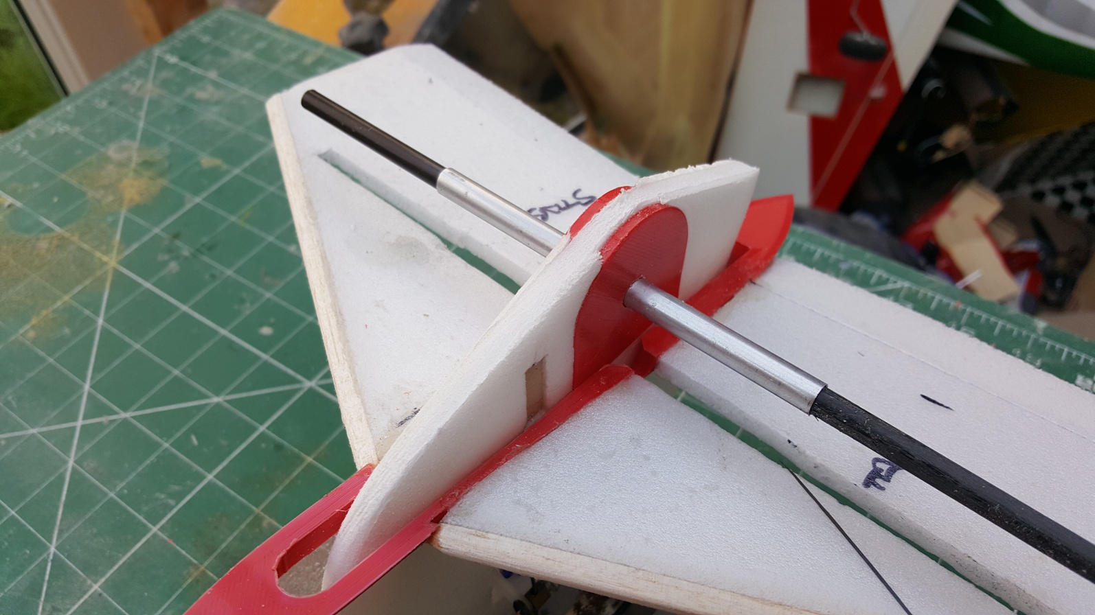

I did work on the tail fin and tail plane. The Buccaneer has an all moving tail plane and Craig has designed the model to have the same.
So I cut out the depron parts and added a 6mm square balsa leading edge to each tail plane. This is to provide some form of protection to the depron leading edge. Minimal weight increase. sanded them to shape then epoxied them to the underside piece of the tail plane fairing by putting them on a clingfilm covered glass surface. Let them set.
Added the pivot pieces to the tail fin and aligned them by putting the ally pivot tube in and supporting it with a V block. This ensured it was square to the tail fin. Inserted the push rod from the inside onto the lower fairing. I also added a piece of ply as a rubbing / securing face for the pushrod. It wont come out!! Then removed the tube and pushed the tail plane onto the fin, put the ally tube in with carbon rod. Lifted the tail plane up to the tube and tested it. Works nicely. Ready to epoxy the ally tube to the fin and the carbon rod to the tail plane. A nice, neat design.

05 Apr 2020 22:49 #8 by Quorneng
Replied by Quorneng on topic Jetworks Buccaneer
The weight of the balsa leading edge will also act as a mass balance to reduce the chances of flutter.;)

06 Apr 2020 07:59 #9 by Eric
Replied by Eric on topic Jetworks Buccaneer
As will the asymmetric areas either side of the pivot.
I thought the Bucc used conventional elevators for pitch control, the AMT was used for trim and was tilted to an extreme 'up' position for landing and take-off/launch.
I'll have to find that book again, and re-check.
