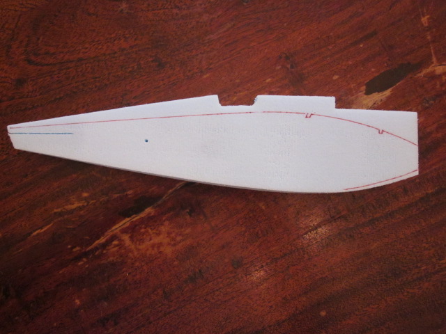

I am no expert by any stretch but I will share how I build with blue foam with my new Oeffag 50.14 in 1/20 scale.
Most of what I do has been pilfered from others but I do have moments when I come up with something good.
I start by drawing out the top and side views on a block of blue foam. I like to drill the peg hole and the stab slot first so they end up square to the world, the block is split vertically and spray glued back together.
I next cut the top view and spray glue the offcuts back in place then proceed with the side view cutting.

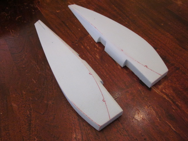

Here are the file folder patterns I use.
Next picture is the rough shaping, then pop the halves apart.

This is my super hi tech hot wire foam remover I use it to remove the majority of the foam then use the cup brush in the dremel to finish it up. I started out just using the brush but it was time consuming and made a big mess.
I forgot to mention to trim your fingernails before you start or you will mark the foam up.
Also if you blow a hole in the fuselage when you are hollowing it out just cut a tapered foam plug and glue it from the inside.

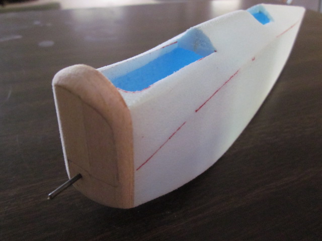

The nose plug is in place with a couple of 1/8 magnets for extra security. With the nose in place more sanding to refine the shape.

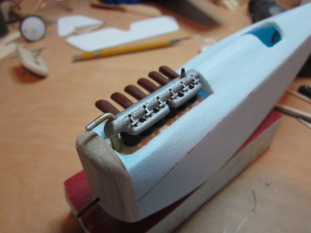

Today I spent the morning building the Daimler engine to keep me motivated on the build. It's an interesting engine with 2 intake ports per cylinder. I think it's okay being only 2" long. I don't know how the plastic model guys built them even smaller.
