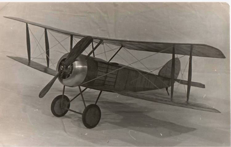

31 Oct 2024 10:36 - 31 Oct 2024 10:51 #6 by Quorneng
Replied by Quorneng on topic Sopwith triplane rubber power.
Tom
That is one beautifully made model. I am envious!
However it could be argued that the Sopwith Triplane is about the worst full size plane to copy for rubber power.
The 9 cylinder Clerget was very heavy compared to Sopwith's super light weight construction thus its very short nose and the narrow chord wings make the CG position rather critical. The broad chord wings of the Pup are rather better in this respect although the "proper aerofoil" wing section of the Fokker Triplane is even better in terms of docile handling characteristics.
It was the fact that electric motors are so heavy compared to balsa and tissue that suggested to me WW1 rotary engine types suited electric power. In my case this was for indoor Round The Pole flying. This meant plenty of "electric" from a mains transformer no batteries required. I chose to model a Sopwith Pup.
18" span and light, just under 2 oz, of which the electric motor accounted for 50%! Geared so the high revving 12V slot car motor could turn a scale diameter and pitch carved balsa prop. As the "electric" required two wires the final feature was to make it control line as well. Not to do aerobatics, the lines were far too short, but to be able to fly and land "gently"(some of the time!) to protect what was a very delicate model.
It actually flew pretty well but its scale thin under cambered wing section possessed a wicked stall if you tried to fly too slow nose high just as did the full size.
I built several RTP planes along the same lines. This was all done nearly 50 years ago long before the current super powerful brushless motors and LiPo batteries but it did teach me how to build light.
If your Sopwith Triplane is anything to go by I eagerly look forward to seeing pictures of some of your other planes.
Simon

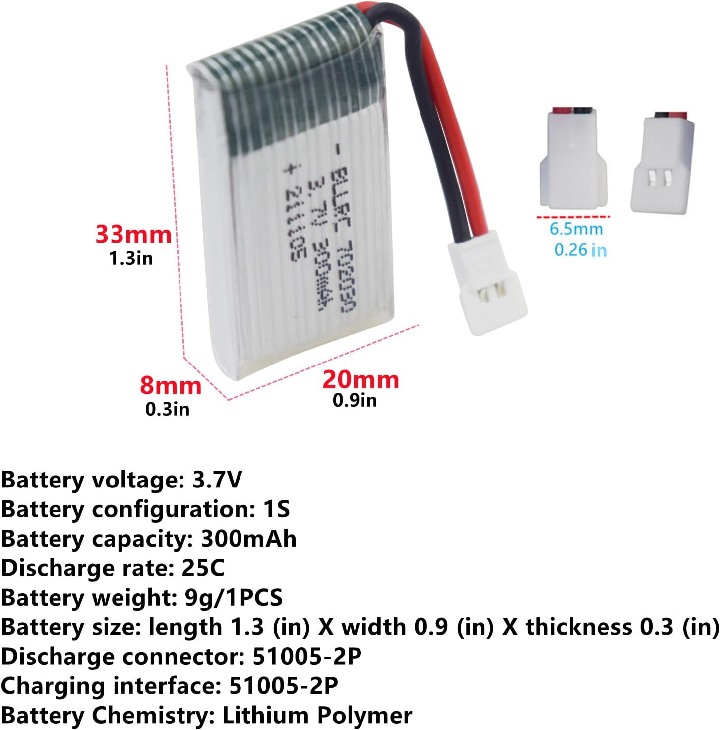

01 Nov 2024 13:45 - 01 Nov 2024 13:58 #14 by old ugly
Replied by old ugly on topic Sopwith triplane rubber power.
i am not sure it i am quoting this correctly.
i have found batteries on amazon that the motor supplier recomended  but they have a differnet connetor and i would have to change it.
can you identify and tell me what type of connector is on those battery so i can try to find and change them onto my timer?
if so that would be great.
