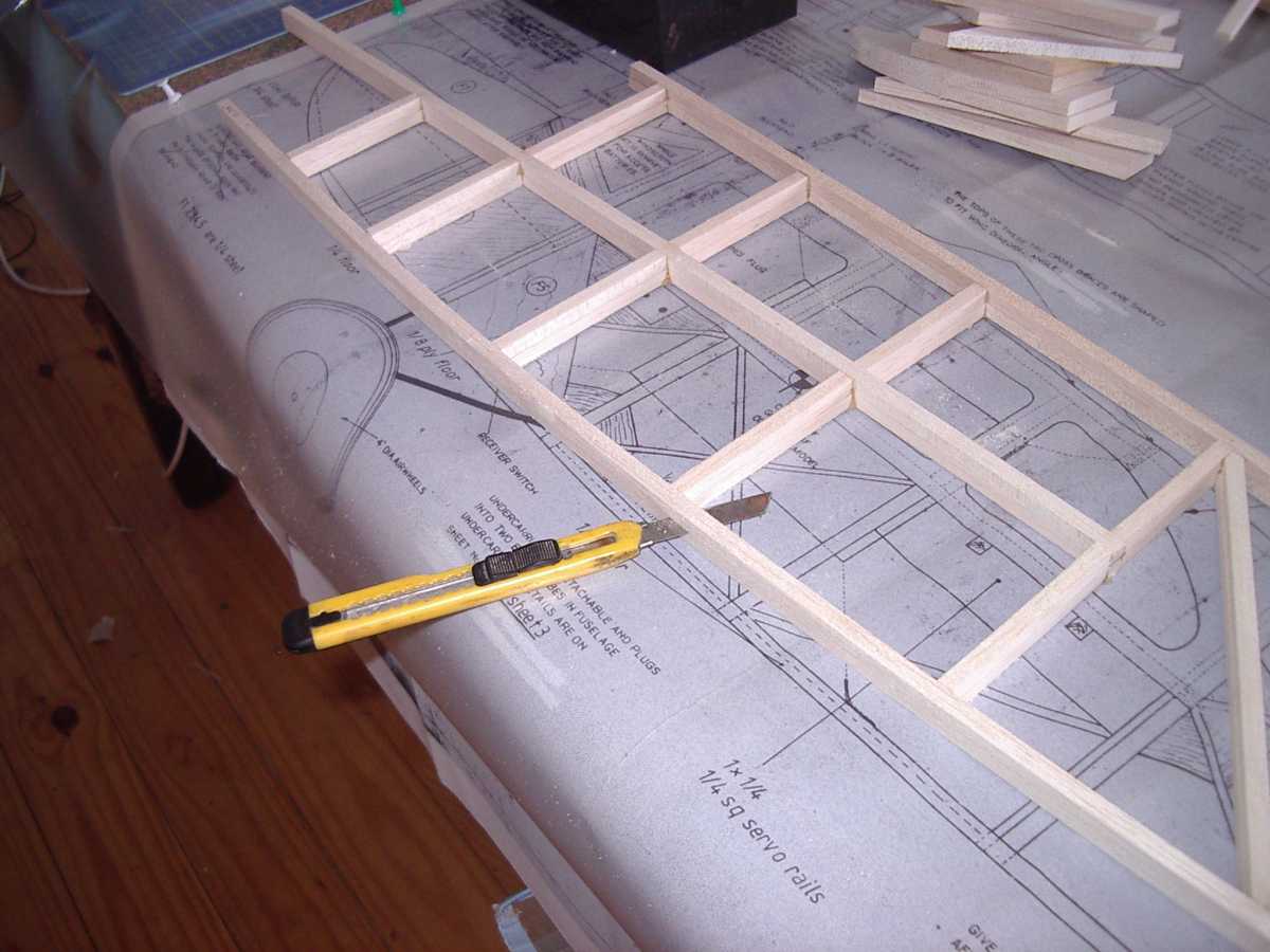

08 Feb 2013 15:09 #14 by Klipkopwildlife
Replied by Klipkopwildlife on topic Radio Queen
I keep getting 'side tracked'! Because it's a 'beginners' build I keep realising that I'm using words and techniques that are not referenced elsewhere in the site, so I have to go off and do that!
I find this is the easiest way to do the splitting, but be careful, the blade is designed to break off, so don't apply too much pressure!
Two identical sides.
Thanks: Eric, Dean M, Ex-Member, THE BLACKBIRD, Sarah-Jane Smith
