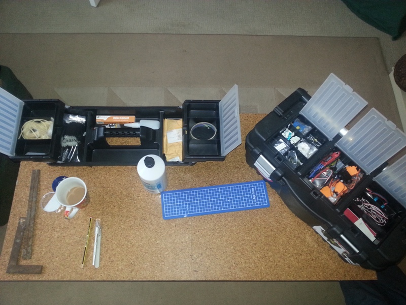

Ok, so plans covered in cling flim and taped to the board in preperation
First bit of construction is the tail. Cutting the leading and trailing edge strips slightly over length as the instructions erm...instruct ha! I pinned these to the board using the Andy/Eric cross pin method (thank ye chaps!)

What a nice well ordered tool box!
I work on the principle I remember (some of the time) where I put every down last time I used it!

OCD comes in handy sometimes- can always find something easypeasy hehe
