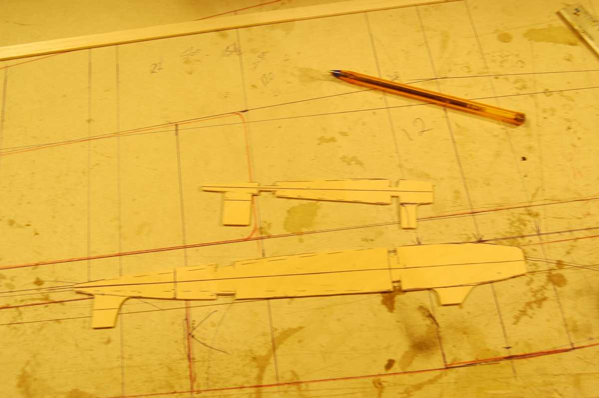

I drew the plan for the wing straight onto the bench and cut two rib templates

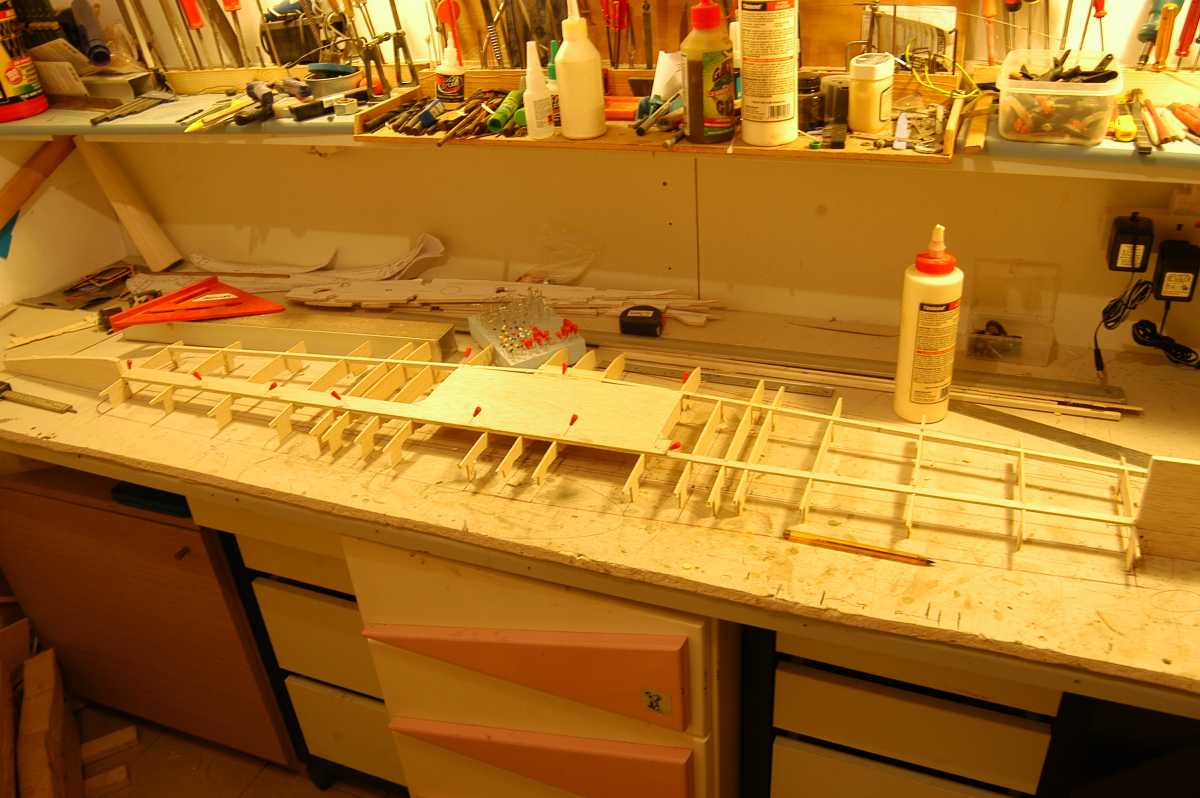

Cut the ribs and started the build, as the wing leading edge and trailing edge both narrow at the wing tip as does the wing thickness i put tabs on the rib and am building it off the board
6mm ply braceing each side of the spare
Started the sheeting but ran out of 1/16th sheet , will try to find some tomorrow

Finished sheeting the top of the wing and put the cap strips on,

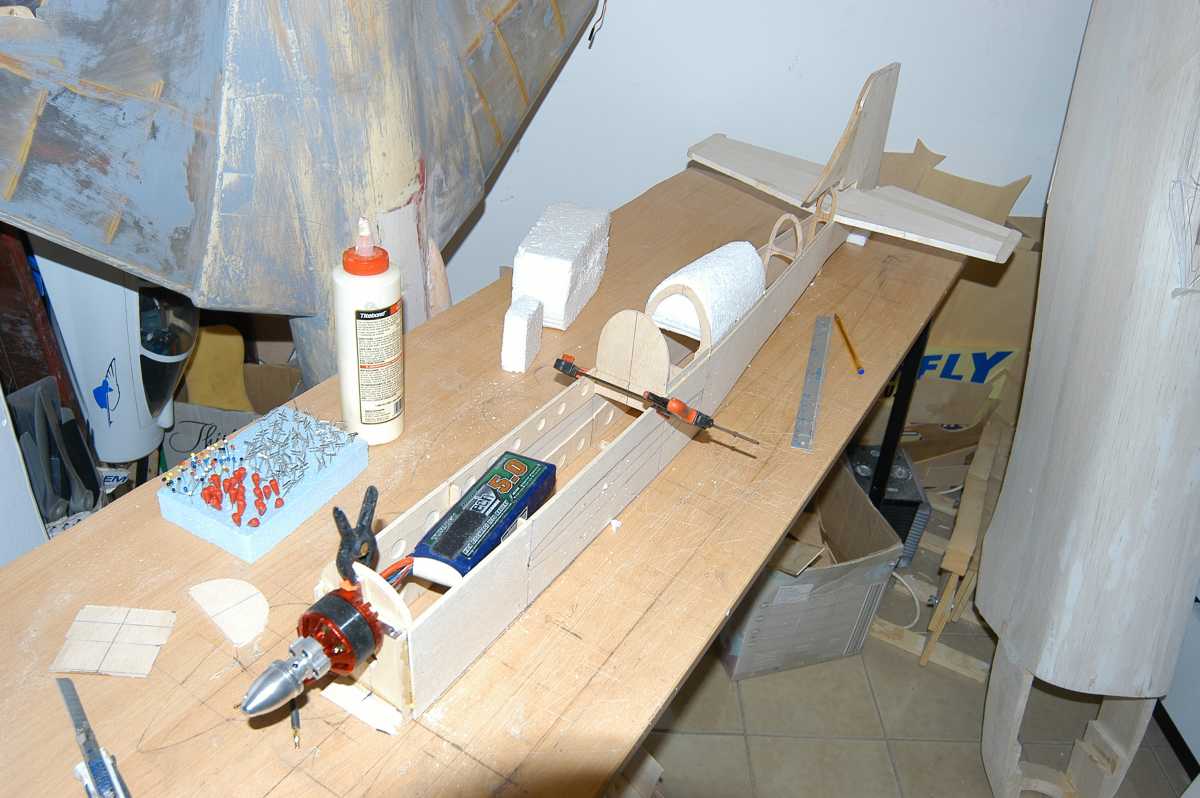

Laminated the fuselage sides and ply strentheners, then glued the formers straight on to the bench over the drawing a made
Cut out the tailplane and finand rudder, the tailplane is from 3/8th balsa and the fin and rudder i laminated two sheets of 3/16th together, i want to shape them all into an airfole section, and taper them to the tips

This is where i am with it tonight the white foam i found on the road, thought i would fit it in the turtle deck to add some light weight strength,
But it might be in the way as i want to do pull pull system for the rudder and elevators

While the fuselage was glued to the bench i glued the tailplane on and set it up level
shaped the foam to something like
Fit the fin and the wing, the wing is just a push fit at the moment but it will be pemanantly fix as i can get it in the car ready to fly
Starting to take shape
