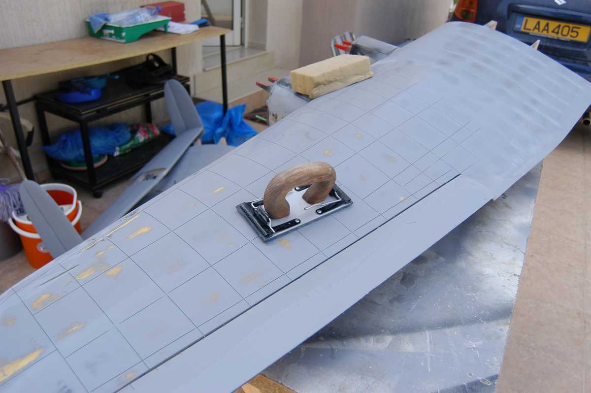

It was the only bit of shade around at that time of day and i could not take it inside because of the smell of the paint, i pit it on the ground because of the wind
14 Jul 2014 19:43 - 14 Jul 2014 19:44 #137 by THE BLACKBIRD
Replied by THE BLACKBIRD on topic The Cyprus LANCASTER
Got it all sanded back to the panel line tapes
It took as lot to get the tapes off as it did to fix them on :S
So now iv started the wonderful job of riveting, fist time of doing it with glue blobs, and doing each one seperatly
And i need some practice thats for sure
So another riveting day tomorrow :blink:

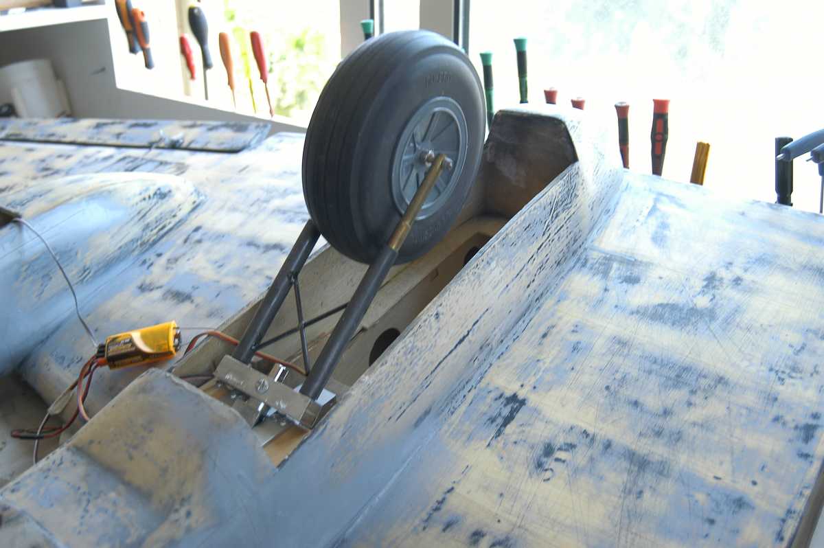

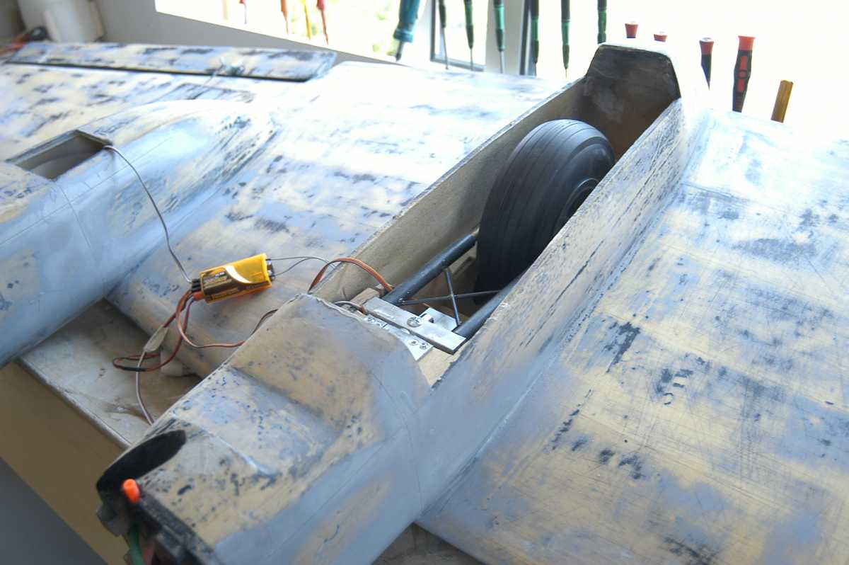

Tonight i started to fit the electric retracts i got from Hobby King along with my home made oleos
They work well, very good value for the money

Mounted the two engines and connected the throttle servos, setting them up so that the inside pair of engines work on the throttle stick and the outer engines work on a slider switch on the same side rear of the Tx, my thinkong being if i have an engine problem i can shut the opposit one down as well :unsure:
I got the retract fitted and working in the same wing
And tried the cowls and spinners
Thanks: Phil Wood, Quorneng, blue123, old fart
20 Jul 2014 19:34 #141 by THE BLACKBIRD
Now thats a big big hole where the wheel goes in , and it will fill with gung from the exhaust so i think ill try to do some doors on it
Thanks: Phil Wood, blue123, old fart

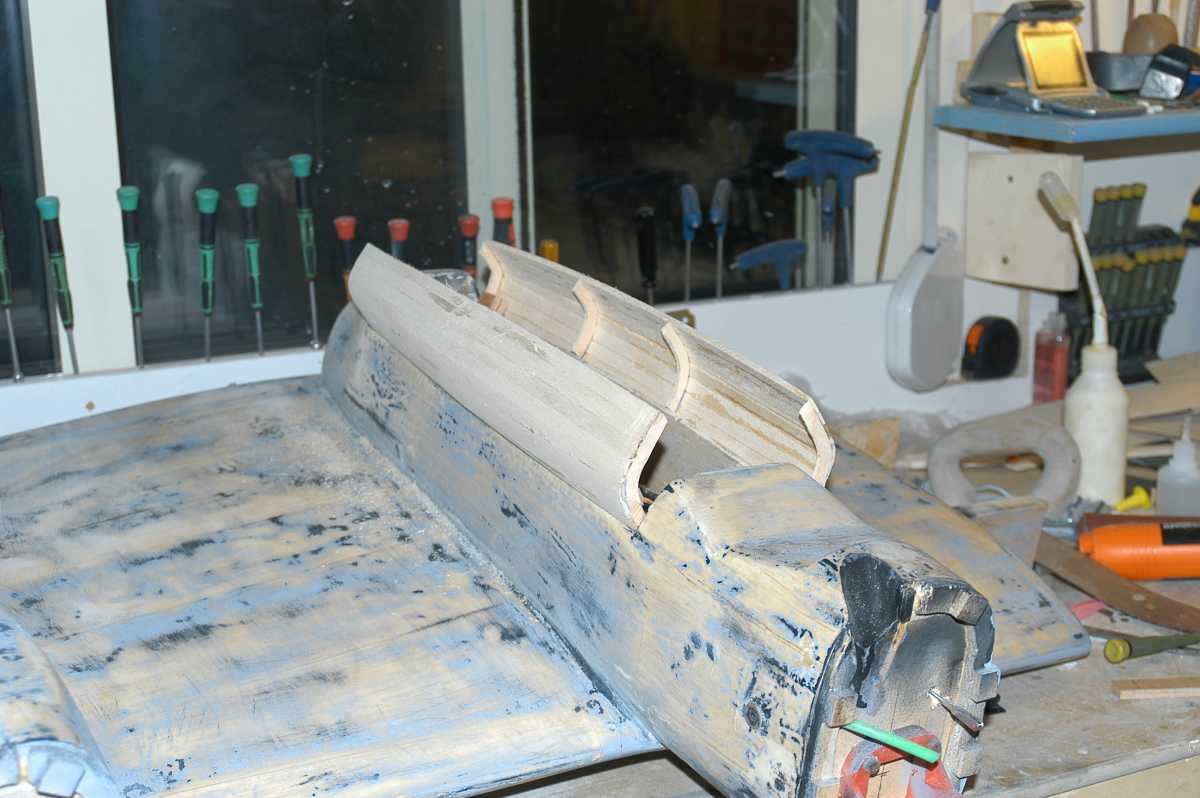

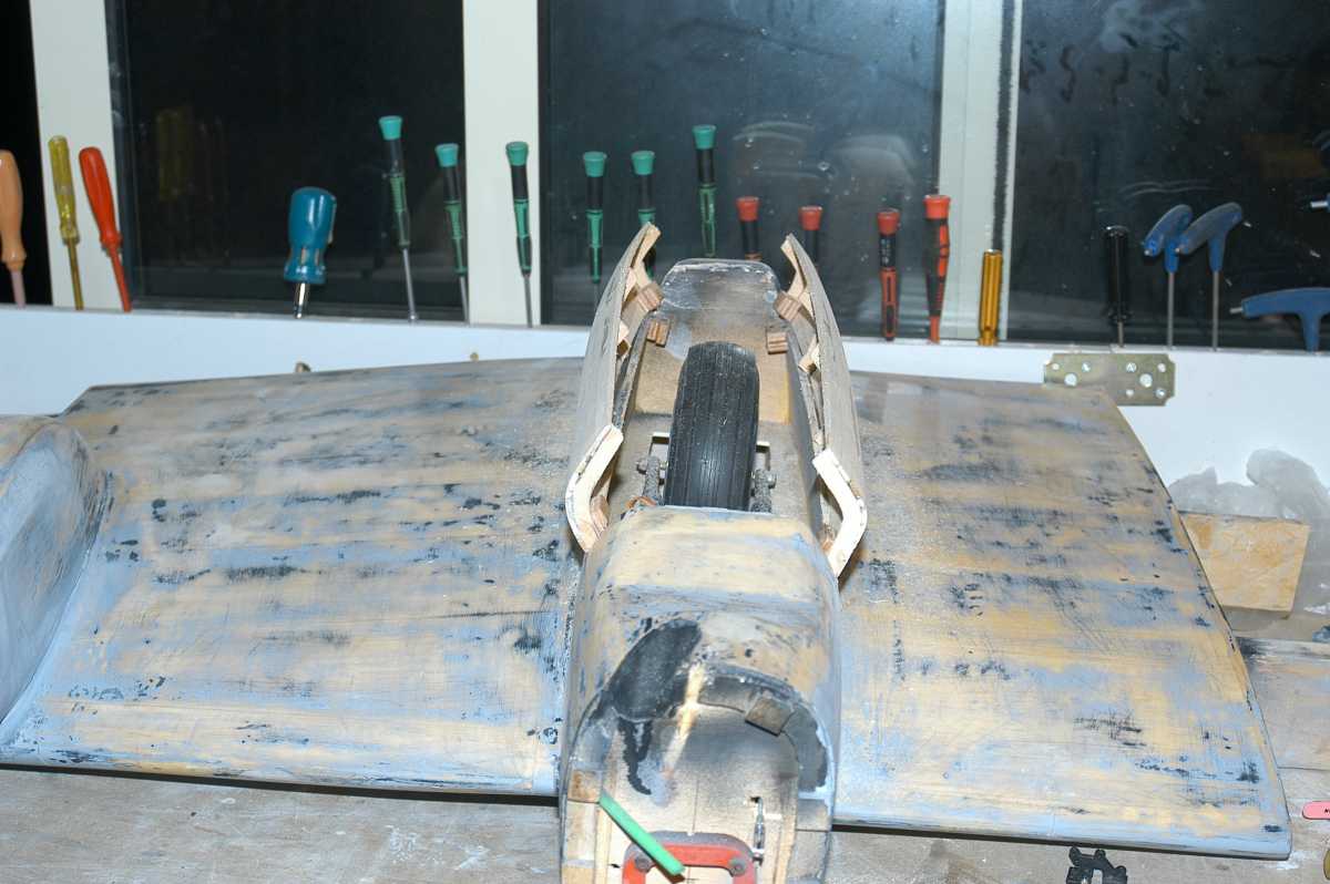

Been faffing about with the gear doors today, not got on to well
Got them planked
And sanded
Had some of these hinges so thought i could use them
No way could i get them to work
Thanks: Phil Wood, Ex-Member, blue123, old fart
21 Jul 2014 19:51 #144 by THE BLACKBIRD
Finished up useing some plastic flap ones that im not happy with but i have the doors mounted
