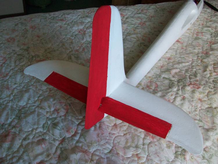

Completed with a temporary Depron pad to prevent the rubber bands damaging the wing, particularly the trailing edge.
And it flies!
Rather sedate and seemed to require rather more 'cruise' power than I expected however after about 10 minutes it seemed to loose power or rather putting on full power no longer made any difference but it continued to cruise ok.
Concerned it was the batteries I landed with no problem (it does float on a bit!) but on picking it up the Depron around the very nose felt quite warm. The batteries were cool.
Further examination showed the motor mounting had come loose so the bell was actually rubbing on the Depron. No wonder it felt warm!
The bit that I rather expected to be an issue (the loose cell batteries) gave no problem at all and each required about the same recharge time suggesting they had shared the load equally.
A bit of surgery on the nose allowed the motor mounting to be reinforced.
At least the CofG is about right so the wing can now be fixed on permanently.

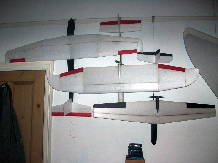

Following my usual protocol I don't video maidens on the basis that if it flies I'm happy, if it crashes I don't want a record of it!
I will video the next flight but the weather forecast is horrid (wind, rain and then more rain :woohoo: )
At the moment it is hanging on the wall along with its 'cousins'
