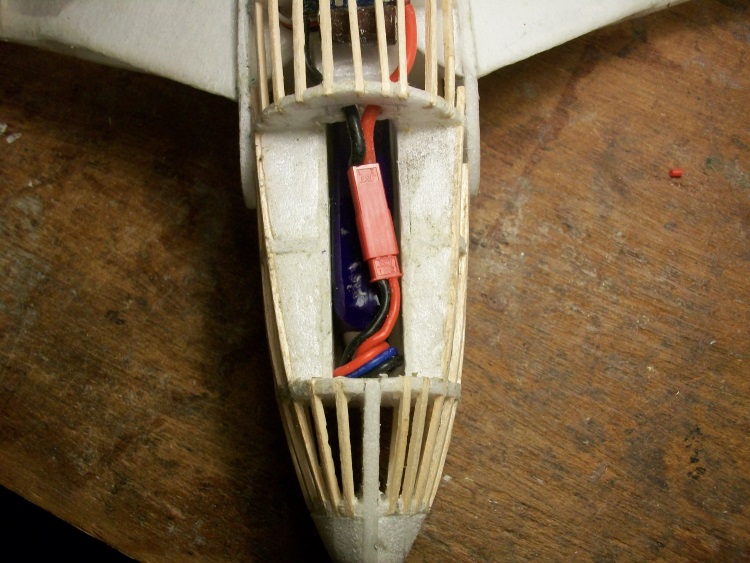

16 Feb 2015 23:15 - 16 Feb 2015 23:18 #36 by Quorneng
Replied by Quorneng on topic An EDF 'Jetex' Vampire
Started making the battery hatch which will include the canopy and then discovered I had made a serious mistake - the battery compartment was simply too small, well actually big enough for the battery itself but not including the balance and power plugs. :blush:
The battery box needed to be deeper to leave room above the battery for the plugs and still get the hatch closed.
The only solution was to completely cut open the underside of the fuselage under the battery box, cut off the box bottom, deepen the sides, add a new bottom, modify and replace the cut away formers and insert new stringers.
All done and dusted!
The battery in the new deeper box with the JST lying on top.
The fuselage can now be covered and the hatch completed.
Just out of interest the radio LED shines pretty brightly through the tissue! :P
However the silver paint finish will probably hide it completely.
Last edit: 16 Feb 2015 23:18 by Quorneng.
Thanks: Phil Wood, , Eric, Klipkopwildlife, old fart, Ex-Member

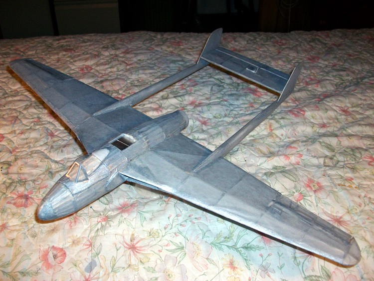

19 Feb 2015 23:49 #39 by Quorneng
It stands out a bit better in silver!
Just a couple of areas to touch up and some roundels/ fin flashes to add.
The paint has added 0.22oz (6.24g) so it now weighs 4.25 oz ready to go. This gives a wing loading of 7 oz/sqft which somewhat higher than the 4.5 oz/sqft of the Canberra although the Vampire's 60% thrust to weight ratio is marginally better.
We shall see. :P
Thanks: Phil Wood, Klipkopwildlife, THE BLACKBIRD, blue123, old fart, Ex-Member

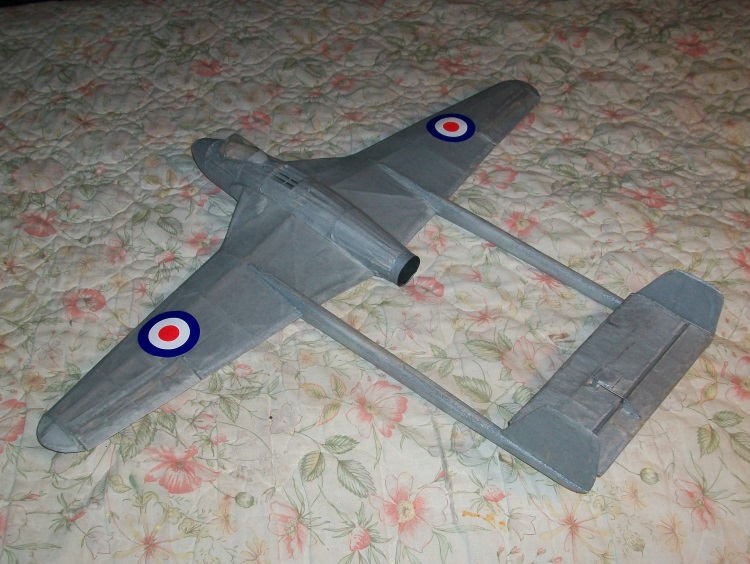

22 Feb 2015 16:04 #40 by Quorneng
Now fully complete and ready to hopefully fly?
Inside of the duct painted black
Roundels added (the boom and fin flashes will have to wait!)
Canopy held on with a front peg and a tiny magnet at the rear.
'Bars' added over the ESC that follow the fuselage line.
It now weighs 4.3 oz (121 g) and has just under 3 oz thrust.
So it looks like 'stick and tissue' and feels like 'stick and tissue' but most of it is actually Depron!
This poses the question, would it be lighter if it was all Depron and no tissue? ;)
Thanks: , Klipkopwildlife, blue123, old fart, Ex-Member
