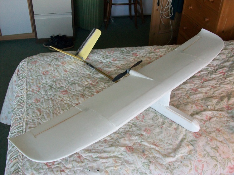

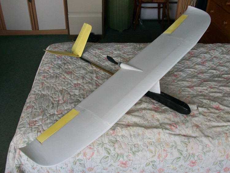

15 May 2015 12:47 #42 by Quorneng
Replied by Quorneng on topic Endurance - again!
Now complete with a limited paint job.
Top
Under
On the grounds black stands out better against a hazy blue sky. :P
Nice this morning, although the westerly is supposed to get stronger, so two flights totalling 56 minutes, by which time my neck was beginning to feel the strain! :ohmy:
Lots of bumpy weak thermals about so smooth 'economic' flying was not really possible but it did not stop the Endurance II from climbing readily power off to the point I kept having to 'bring it down a bit' to avoid loosing it. Despite the black paint it is still pretty hard to see! :woohoo:
However it does not 'feel' quite right with the slightest air disturbance having a disproportional effect. An on-line calculator puts the CofG exactly where it is (27%) although its 'up swept tips' are a bit of problem to input! ;)
What I need is a really calm day to determine exactly how it is flying.
ps
It looks like it is changing to a high over cast which will make it much easier to see! :P
