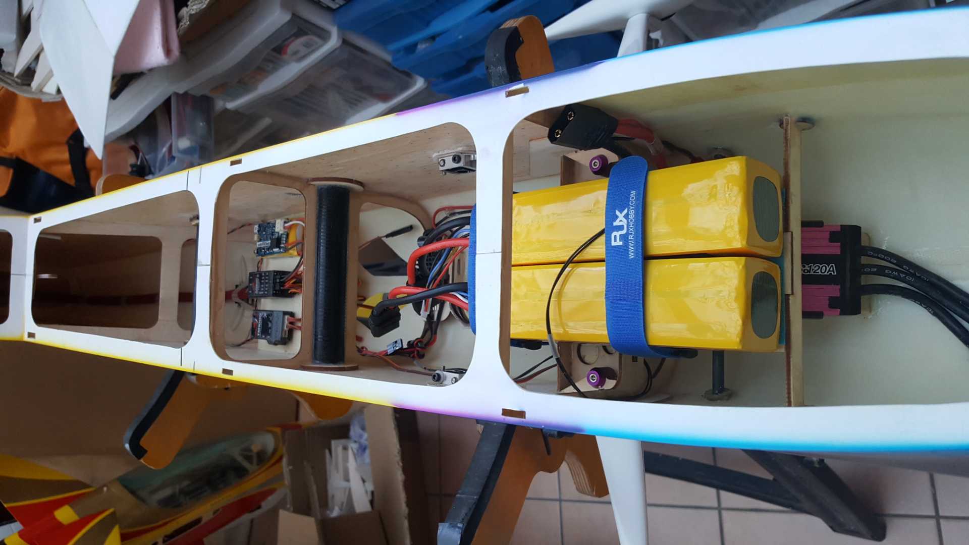

99% complete. Just waiting for the epoxy to dry on the canopy securing lugs and she's ready for the maiden.

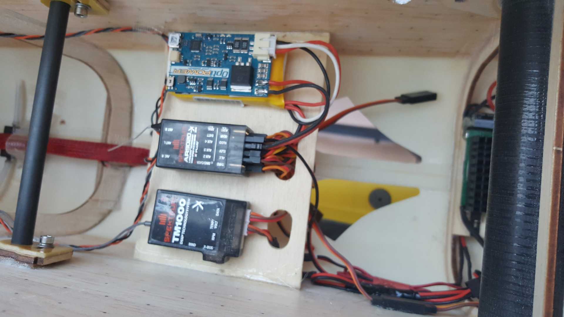

Electronics are in - Rx, telemetry module and Optiguard

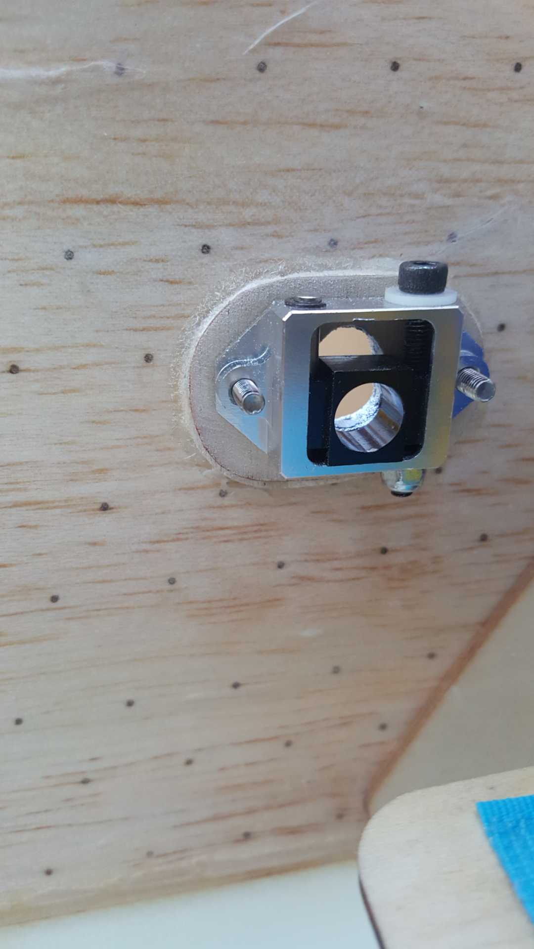

Wing incidence adjusters are in. This took a bit of effort in that I had to jig the plane up and set the incidences so i knew where to fit them. By turning the set screw the black piece rises or falls. A carbon tube epoxied into the wing fits into the hole in the black bit so each wing pivots around the wing joiner tube. Another carbon rod (adjustable and with a securing bolt) from the fuselage going into the rear of the wing secures the incidence.
Then did a trial fit of batteries and did a motor run. Couldn't get the motor to turn despite the ESC arming. :( So messed with the throttle trim still no joy. Reprogrammed the ESC still no joy. :dry: So went and had a cuppa. Came back and set the throttle on max, armed the ESC closed the throttle then gave her a bit of throttle and hey presto motor runs! Clearly the ESC was looking for the high and low setting. :woohoo: I thought the ESC programmer would do that. All sorted now.
So that's it. Just need the weather to improve at the same time that i'm not working and see if she flies or becomes a very expensive lawn dart!!. I'll let you know how it goes either way!
