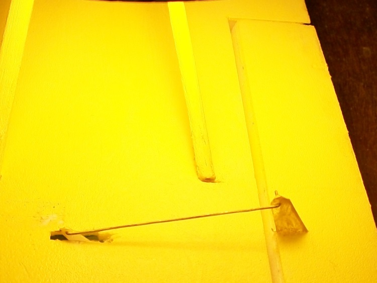

My Super Cub already has considerable mechanical differential. The aileron servo horns are set forward by 45 degrees.
There is no electronic differential available on my humble Futaba 35 meg Skysport 6 Tx!
Apparently the full size Cub also needs a boot full of rudder with full aileron deflection to overcome adverse aileron yaw.
