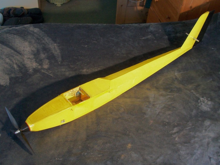

The completed fuselage.
With an 1800 mAh 2s on board it weighs 263 g (9.25 oz)
My best guess at this stage is the complete plane will come in close to 420 g (14.8 oz) which is just a bit heavier than I intended.

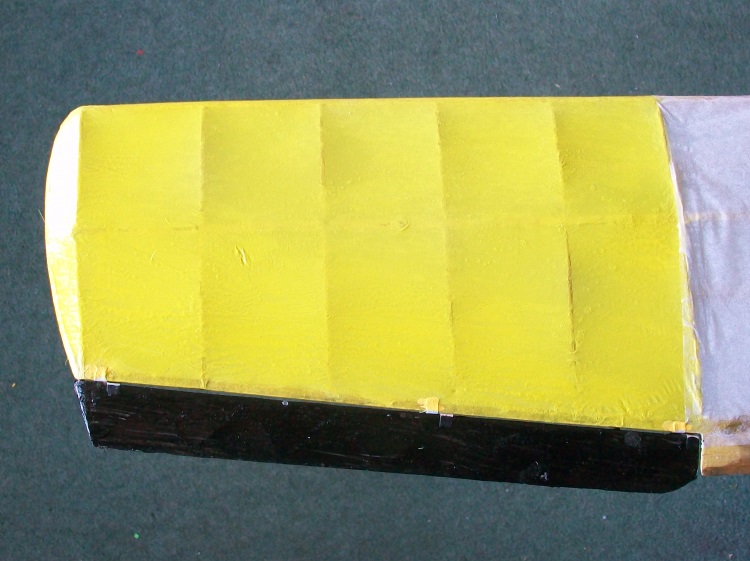

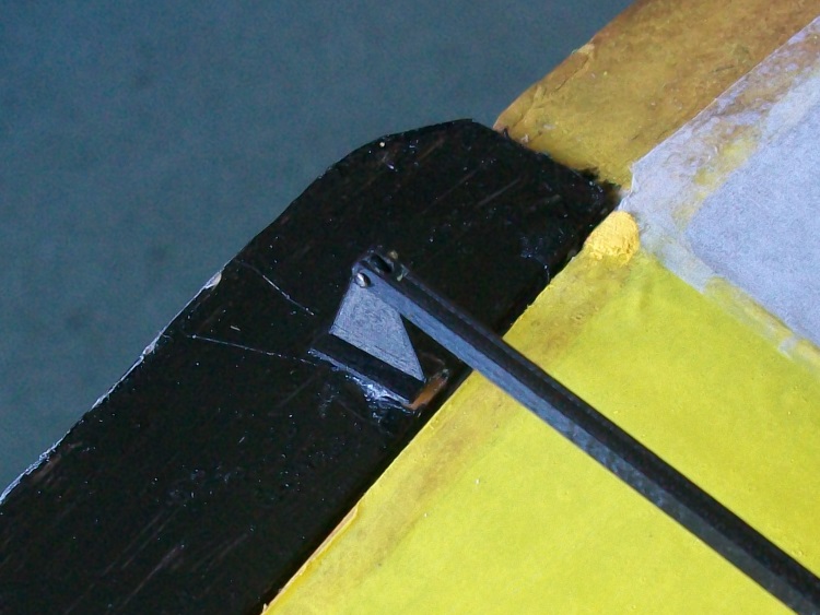

The first aileron attached to the painted wing tip.
Uses cloth 'two way hinges' as I used in the original.
The final bit of my OCD about weight.

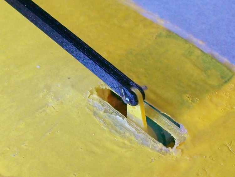

Printed, hollow, forked end, servo links.
The aileron horn is printed as well.
The only metal are the hinge pins.
I had intended to paint the whole wing but it does add a bit of weight so only the tips will be yellow in contrast to the black ailerons. The rest on the wing will be just doped tissue.
Nearly finished but of course just as the weather starts to break!

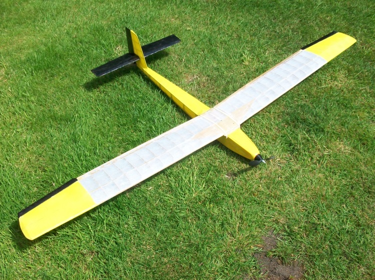

Now complete and basking in the sun!
Would you believe when setting up the aileron throws I discovered I had set a horn one spine out! :ohmy:
By adjusting the servo travel it is still flyable but doing so makes a bit of a mess of the differential action.
Can be fairly easily fixed but it will require some tissue to be cut out and replaced!

Just got back from its first flight! :)
As I feared with an all flying tail plane it is almost impossibly sensitive in pitch or rather it is when compared to the rather feeble ailerons so full aileron and count to three before much happens but put just a tiny bit of unintentional fore or aft stick movement as the same time and its either a stall turn or a spiral dive! :woohoo:
Still mustn't grumble. It really does float about as you might expect from a free flight plane and I am sure it will be a bit better once I get that aileron servo horn on the right spline! ;)
