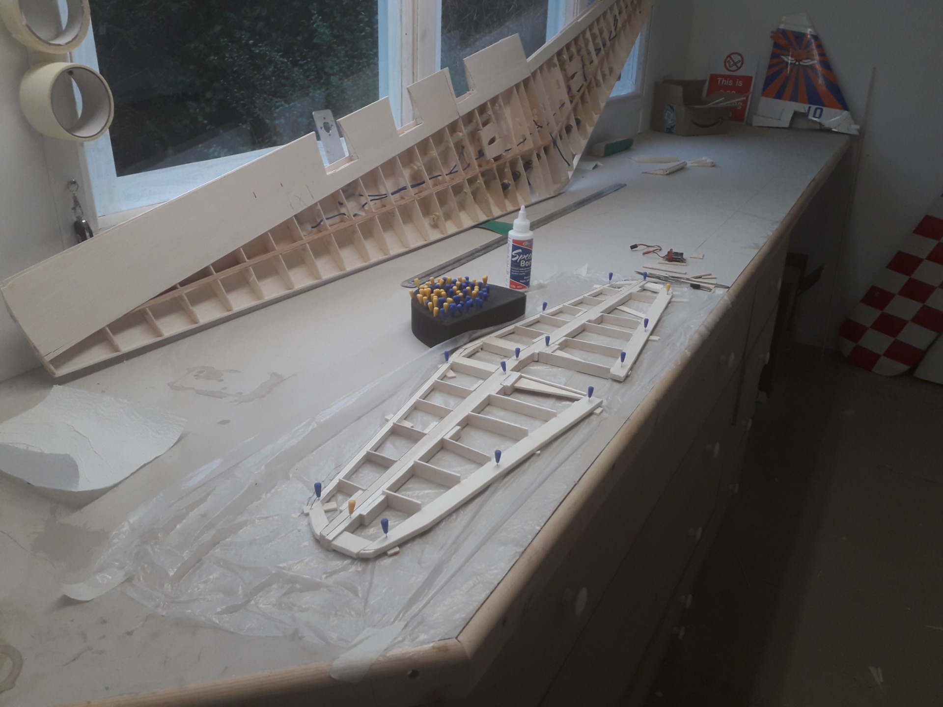

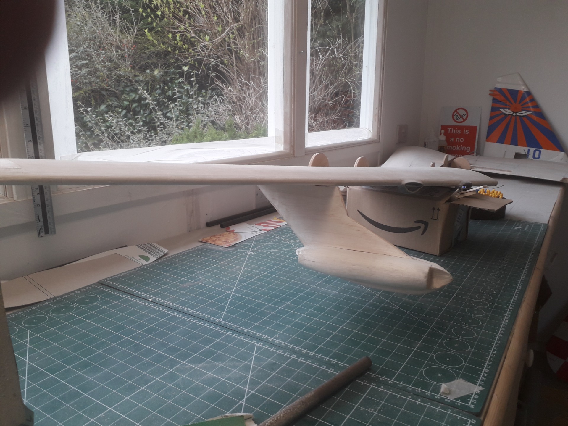

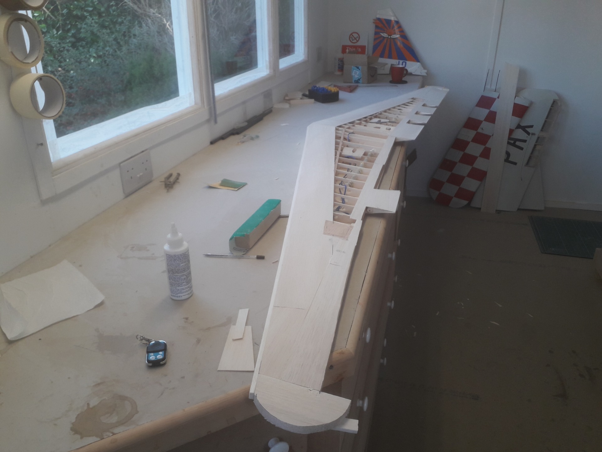

04 Mar 2020 17:56 - 04 Mar 2020 17:59 #95 by THE BLACKBIRD
Replied by THE BLACKBIRD on topic Six Turning, Four Burning
I progress Yavas yavas, the wing is all sheeted and i made a start on the tail feathers and fin, i have some retract units that i brought back from Cyprus, the 3 units weigh 526g , the built wing weighs 974g dont think thats to bad for 110 inch wing, it just fits in across my shed

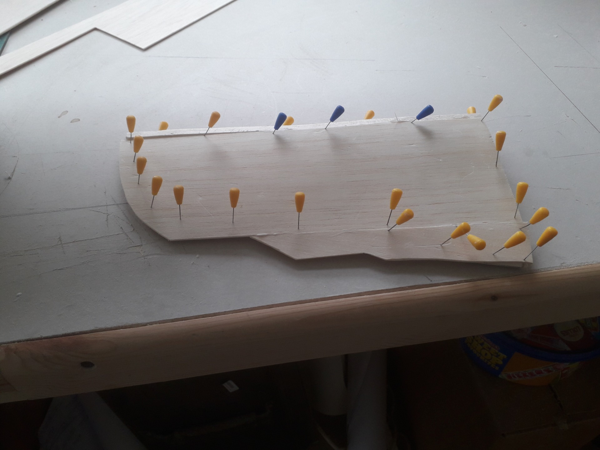

06 Mar 2020 17:00 #98 by THE BLACKBIRD
In an effort to keep the back end light i kept the structure of the fin rudder and tailplane as light as possible and sheeting it in 1/32 sheet
Only problem my clumsey arthritic fingers/ hands cannot cope with such flimsey things
Recovered in 1/ 16th now

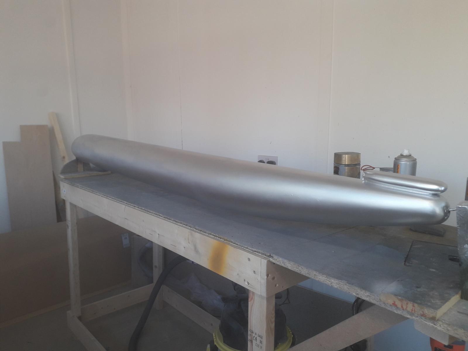

09 Mar 2020 21:04 - 09 Mar 2020 21:10 #99 by THE BLACKBIRD
After a multitude of coats of paint
Filling, sanding i think the plug is finaly ready
Thought i would look at the turbines, looking at pictures on the net i think they are something like this they are quite a lump, made small by the size of the plane
Lot more carving and sanding, this will be the plug for doing them in fibre glass, at least they are both the same, not like the ducts for the air inlets under the wings for the engines, all 6 are different

10 Mar 2020 13:31 #103 by THE BLACKBIRD
Paul the reasons i have done it this way is to try and keep the rear as light as possible, the round fuselarge will be quite strong without any formers, ill add some strengtheners for the tailplane, wing and nose gear
The other reason is to avoid damage, its a big model and like the hunter i build with balsa fuselarge being a clumsy ham fisted old bugger i damaged the huter every time i took it out, hopefully the fibre glass will help that side of it
Sanded the pod to shape
What you think

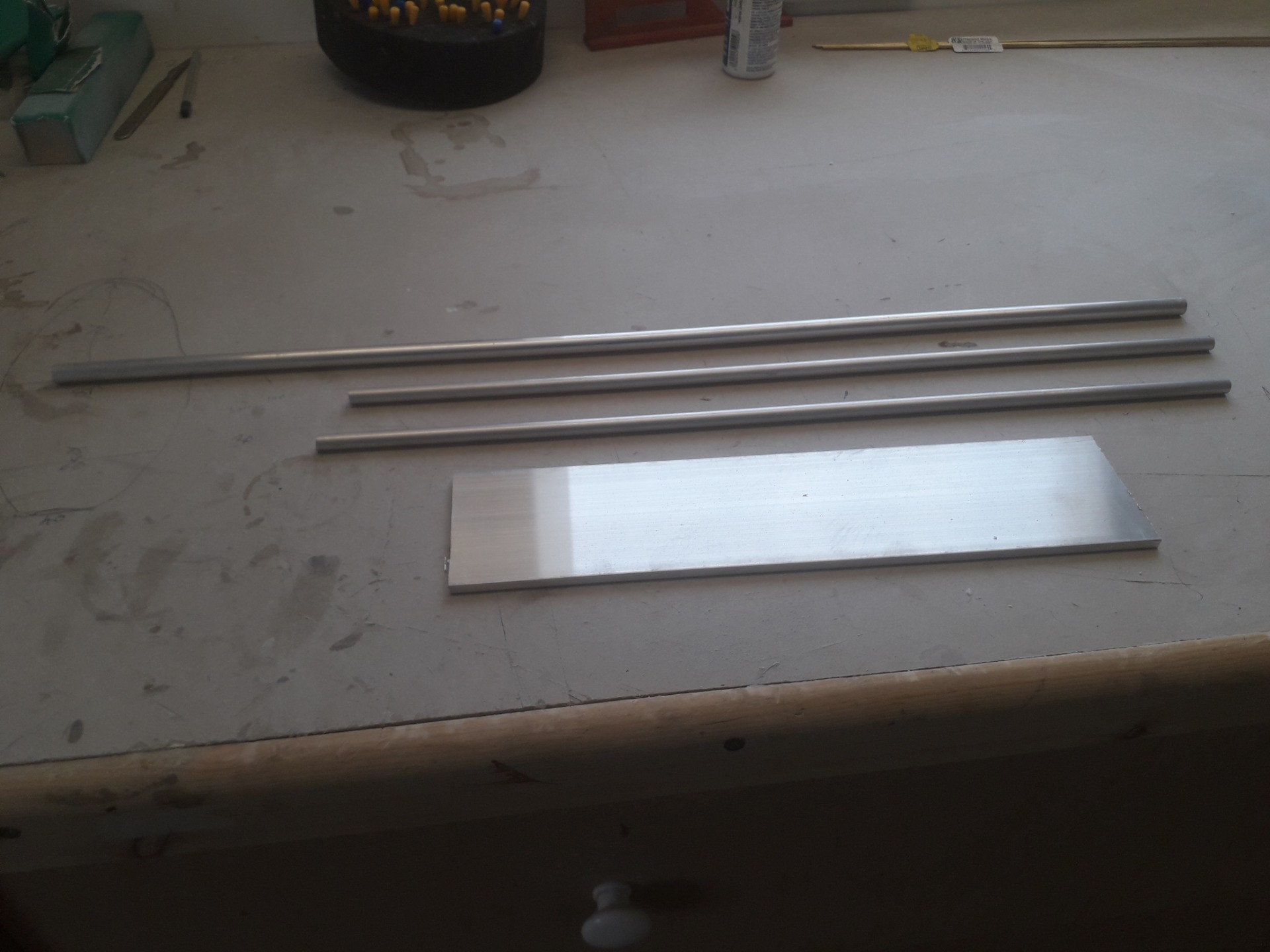

14 Mar 2020 16:29 #105 by THE BLACKBIRD

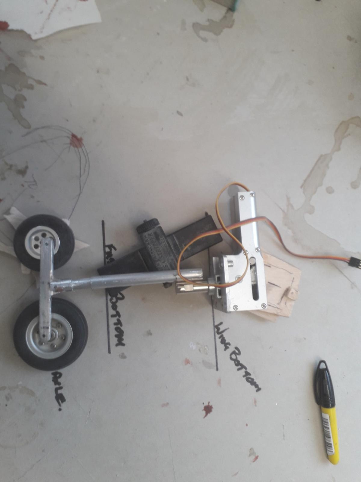

Had some metal arrive yesterday so for a change i thought i would have a go at the main gear with my limited tools
The wheels are all i have at the moment but the larger one is the right size, need to get some springs
