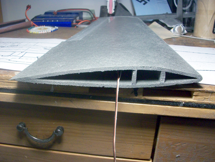

19 May 2021 23:32 - 19 May 2021 23:45 #21 by Quorneng
Replied by Quorneng on topic Hawker Sea Hawk
The wings are proving to be rather slow to do.
The LH wing complete.
The top and bottoms wing skin as simply pulled over two shear webs.
Apart from having to sand quite an area off to achieve a fine trailing edge the real problem is the considerable force that is required to 'form' the wing section with 5 mm foam. This requires the joins to be held in place for 24 hours for the glue to go really hard.
I only have 9 clips so I can only make one wing panel every 24 hours. :ohmy:
Last edit: 19 May 2021 23:45 by Quorneng.

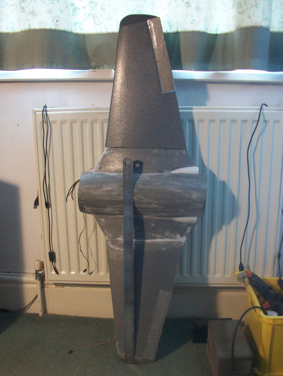

21 May 2021 12:28 #22 by Quorneng
Limited progress but the wings are now glued to the centre section with the ailerons and servos installed.
The wing is sitting like that leaning on the radiator as the RH wing has only just been glued on. :woohoo:
Rear fuselage next.
Thanks: Klipkopwildlife, THE BLACKBIRD, Ralpharr2001, paul d, crash happy

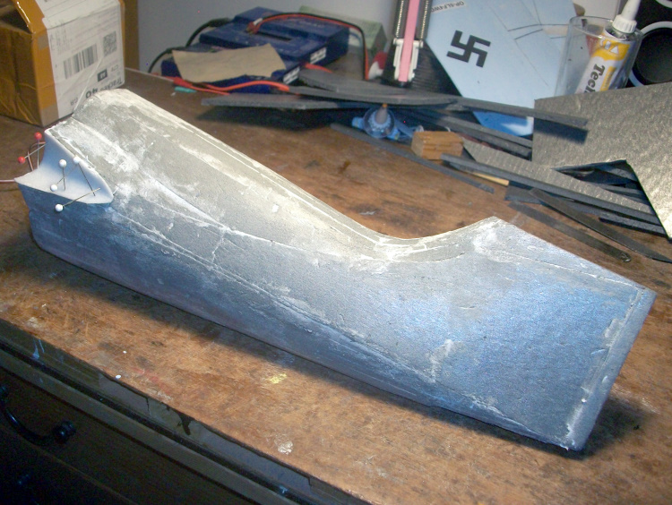

25 May 2021 23:46 - 25 May 2021 23:46 #28 by Quorneng
As I feared joining the rear fuse to the centre section required some rather creative adjustment or put another way drastic surgery but got there in the end. :P
Apart from splitting the rear fuselage down the middle and adding a substantial 'gusset' to get the two parts to have the same circumference a substantial part of the top of the rear fuselage had to be cut away and significantly 'adjusted' and then glued back in to get the fuselage 'top line' anything like right. Hence the masking tape. :woohoo:
After all that the bit that has come out reasonable well is the rear fuselage exhaust fairings.
When you consider the total exhaust area against the fuselage cross section you can see why the Sea Hawk had only a 'modest' performance. I fear mine probably will too!
Last edit: 25 May 2021 23:46 by Quorneng.

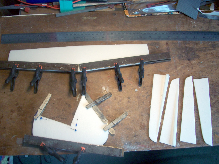

26 May 2021 14:13 #30 by Quorneng
Eric
Its £6 for a 3mm sheet. It was £2.50 5 years ago! Which is rather more than the rate of inflation. :woohoo:
Apparently Webbies are importing it from Germany where it is still sold although I believe it is actually made in Lithuania.
It is the 'aero' quality or in other words lighter but considerably more flexible than the original stuff.
I still have a small piece of original 6 mm as well as some 6mm Aero. It like chalk and cheese! :(
Tail feathers under construction using 3 mm Depron.
Although from my limited stock rather than the new sheet. ;)
