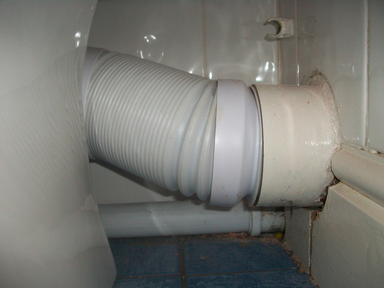

I looked at them but in my case not only did the pipe have to offset side ways to the rear but upwards as well. Only one with a flexible section could do that.
Top view showing the rear offset.
Side view showing the vertical offset.
It works well enough. Just have to hope the flexible bit lasts!

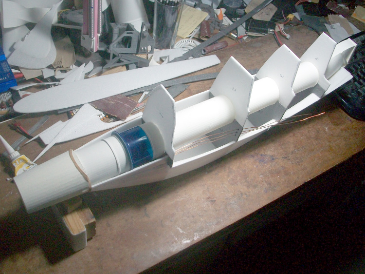

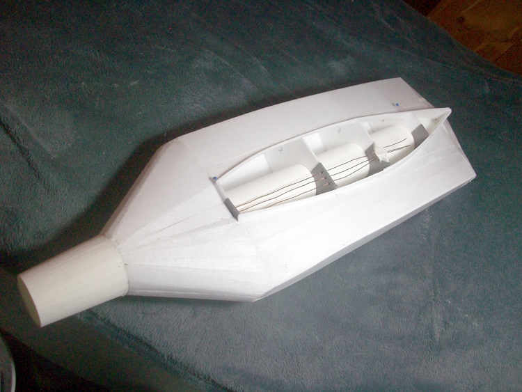

Anyway it has allowed a bit more progress with the Lippisch.
The full duct glued in place in the half shell and the RH formers added on top.
Note the the three magnet wires leading back from the EDF. Exactly where the ESC will go will depend of the battery position and I have no idea where that will be!

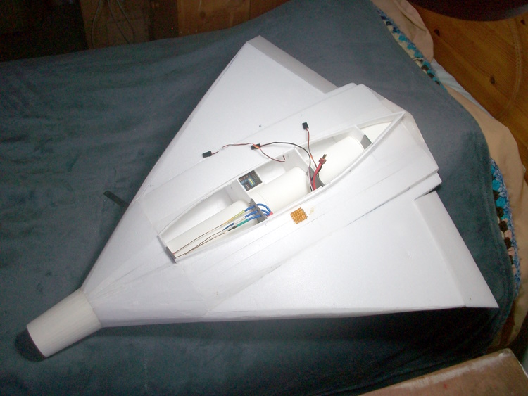

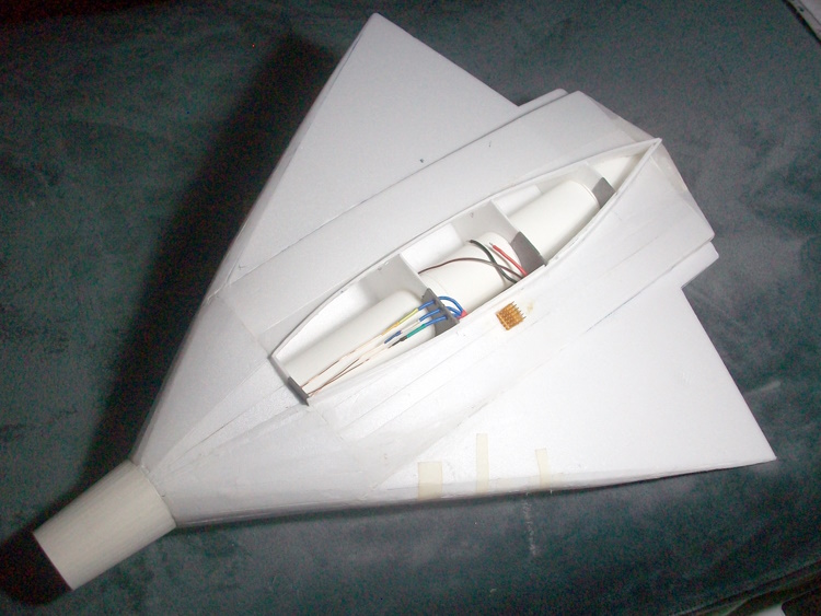

10 Feb 2023 20:39 - 10 Feb 2023 20:41 #27 by Quorneng
Replied by Quorneng on topic Lippisch P13a
A bit more progress,

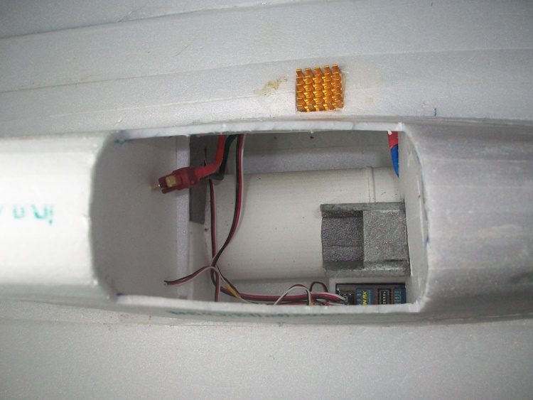

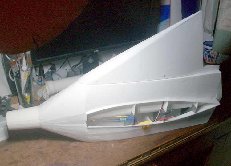

The fin/cockpit is glued on.
Although in more or less the right place for the cockpit the hatch is a bit over size to make fitting the battery a bit easier,
The battery box.
With a complete nose to tail duct the battery was always going to be mounted over the duct. It is slightly off set to the right to counter the weight of ESC mounted on the left.
The battery position fore and aft is a guess and puts the CofG a bit further forward than I originally imagined but I guess I can live with a bit nose heavy given its questionable aerodynamics.
