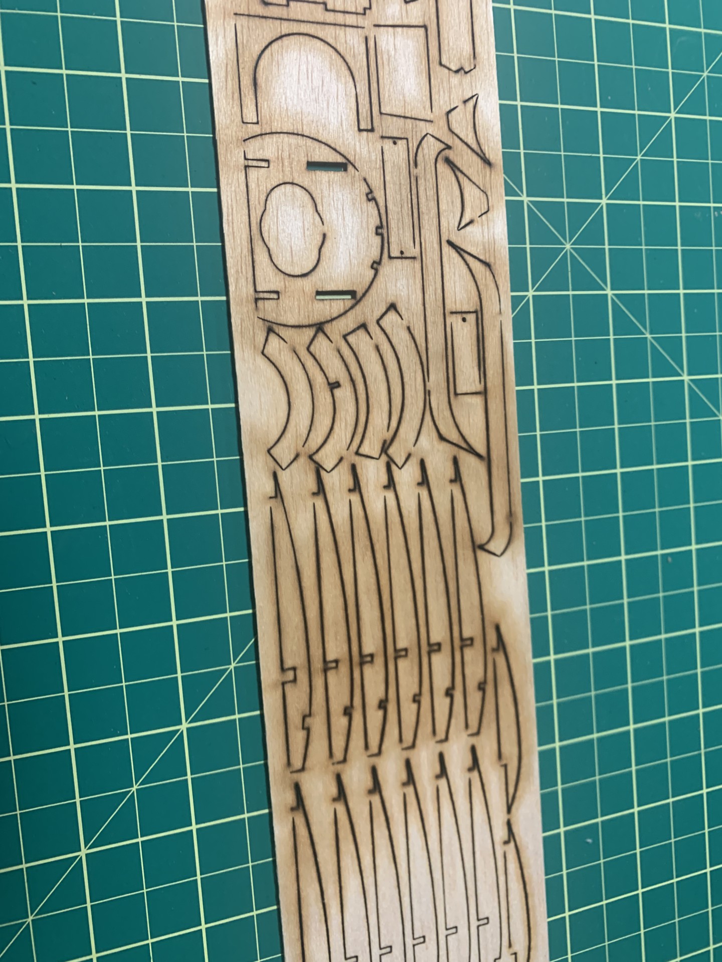

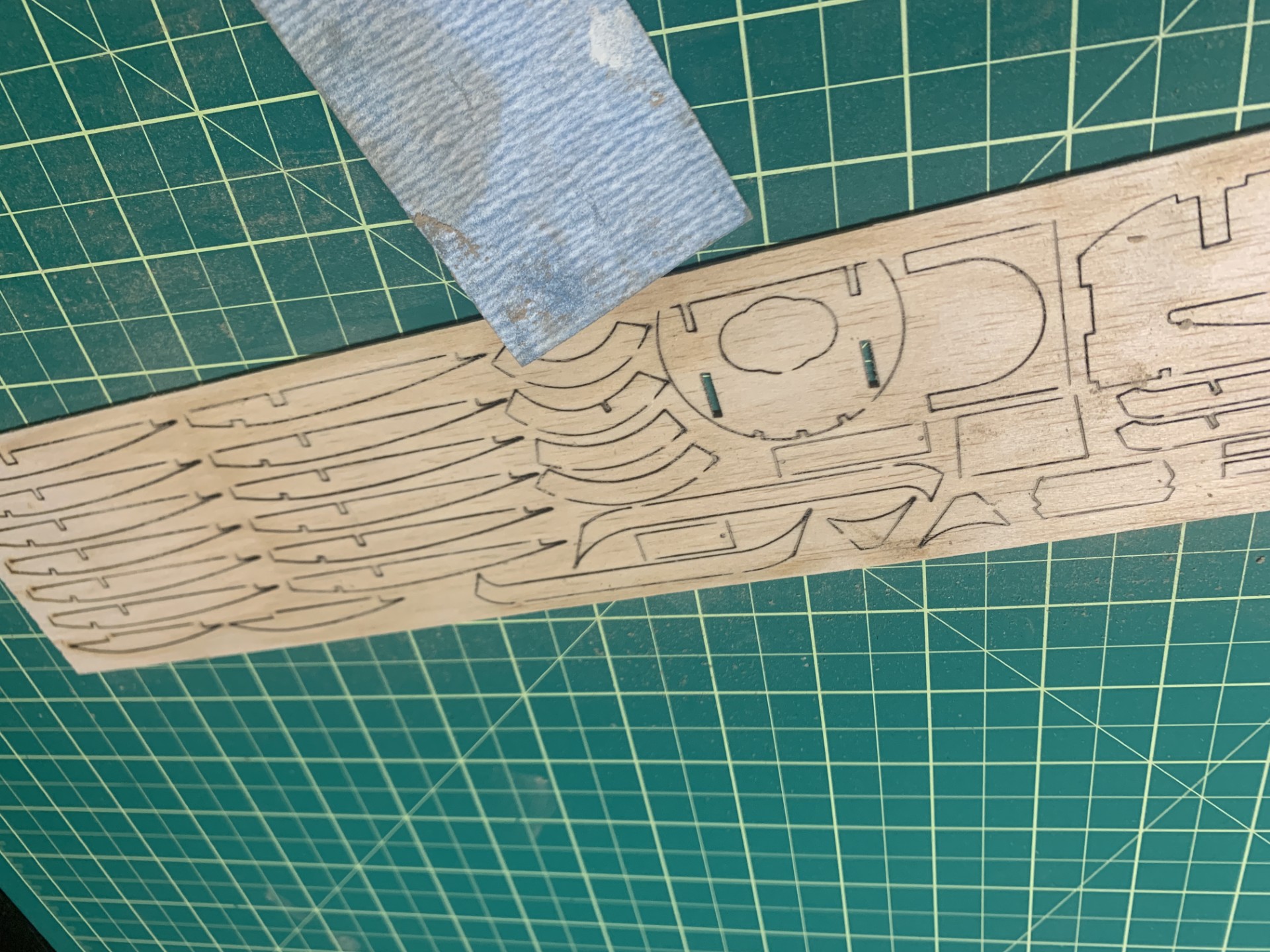

24 Nov 2024 04:54 #12 by old ugly
Replied by old ugly on topic Fokker Eindecker E111
i finally got started on this model.
the lazer cut sheets of balsa having the burnt marks, i quickly sanded with 320 sandpaper while they were still attached to the sheet. then before gluing anything  i sanded the edges slightly.
i have the sides glued up.

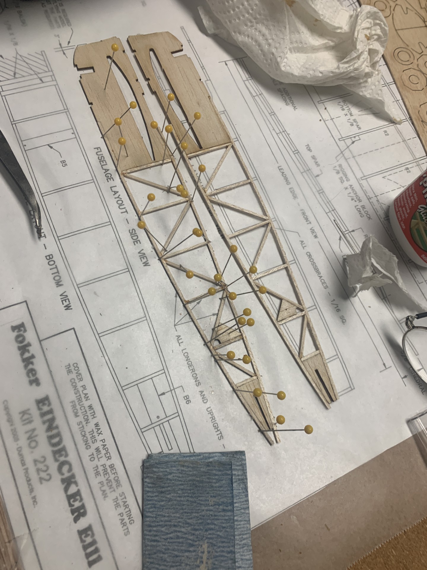

25 Nov 2024 04:56 #13 by old ugly
a bit of progress today

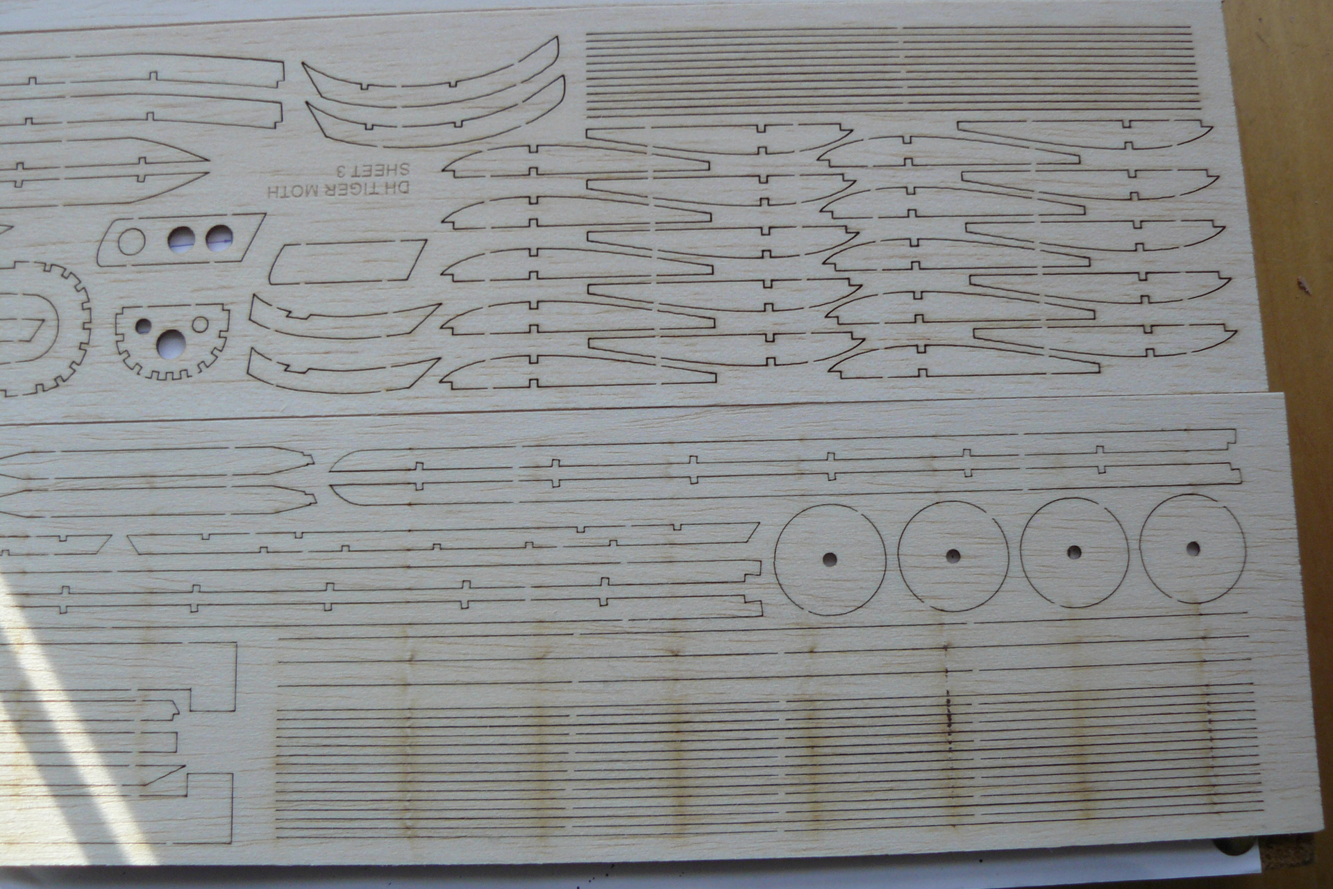

25 Nov 2024 11:57 - 25 Nov 2024 11:58 #14 by Magpie
Replied by Magpie on topic Fokker Eindecker E111
It looks like a nice neat build.
Was the engine a moulded plastic bit & were the curved balsa bits at the front ready formed?
The laser cut sheets look cleaner than on my lysander.
These are the sheets from a VMC Tiger Moth I've just bought on Ebay. There is no scorching, just some contact burns on the reverse side.
Dumas seem to use much fewer tabs than VMC.
How are the sheets held in a laser cutter? Is it a vacuum bed?

25 Nov 2024 14:09 #15 by old ugly
the engine is all pieced together from balsa and cut dowel rod. it is a bit of fiddling.
i don't know what is up with Dumas models the scorching seams to be getting worse. it is a pain. i have another brand coming . from Dare models. lets see how it looks.
