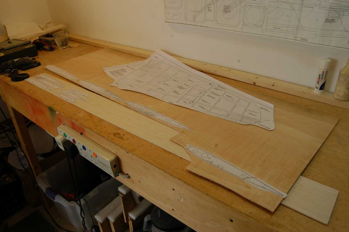

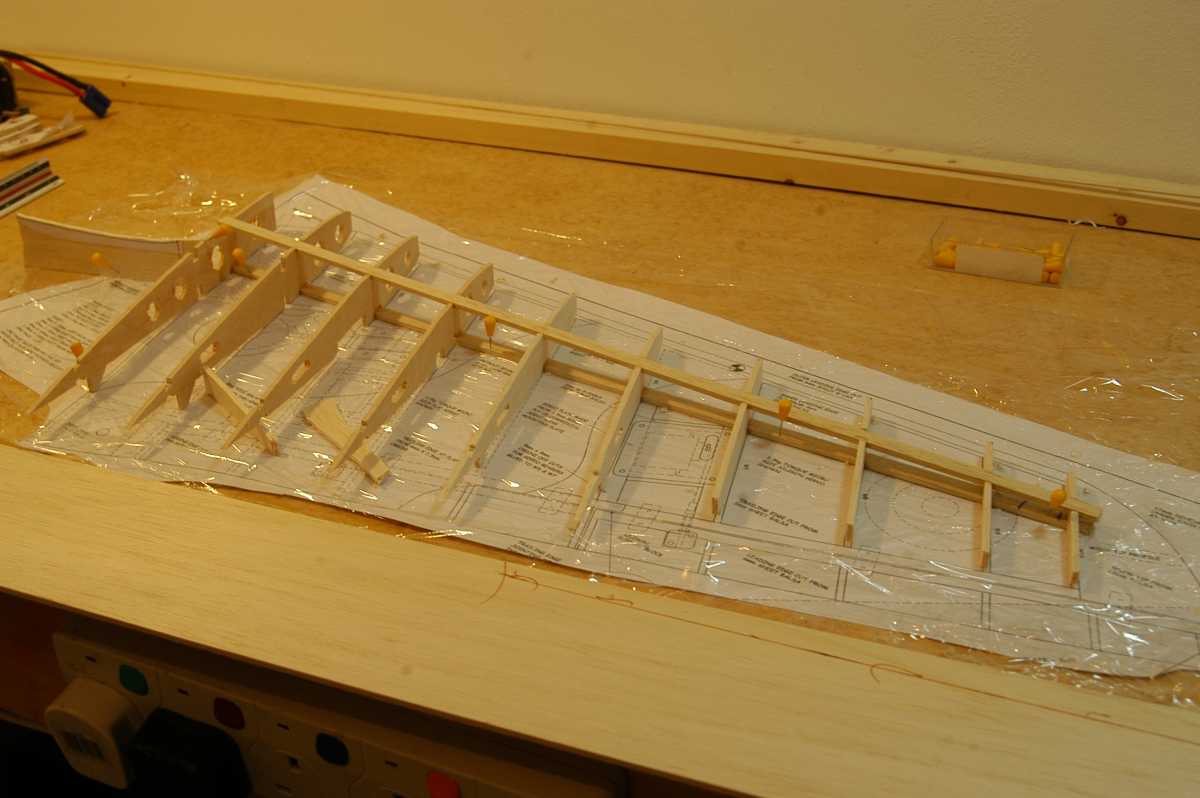

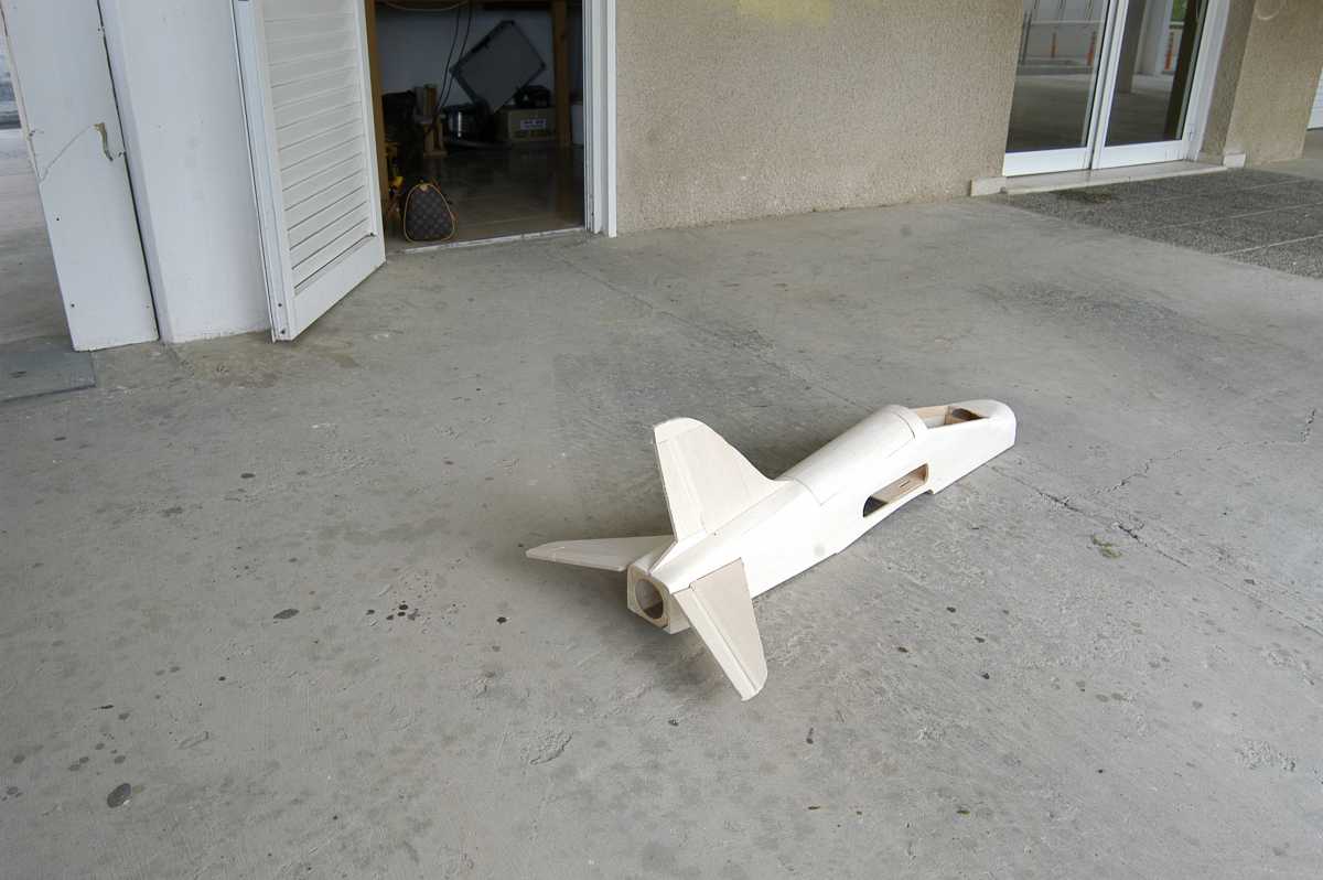

Drawn up the fuse sides and formers, sides in 6mm balsa and formers in 3mm light ply, that's the material that I have to hand
This is where im missing some pics of the cutting out and first assembly
So it jumps to this stage
Seems a bit chunky so I will see where I can lighten it a little, looking at the Dr Mad Thrust 80mm fan on a 6s 5000 lipo
as I have three of them left from the SR71

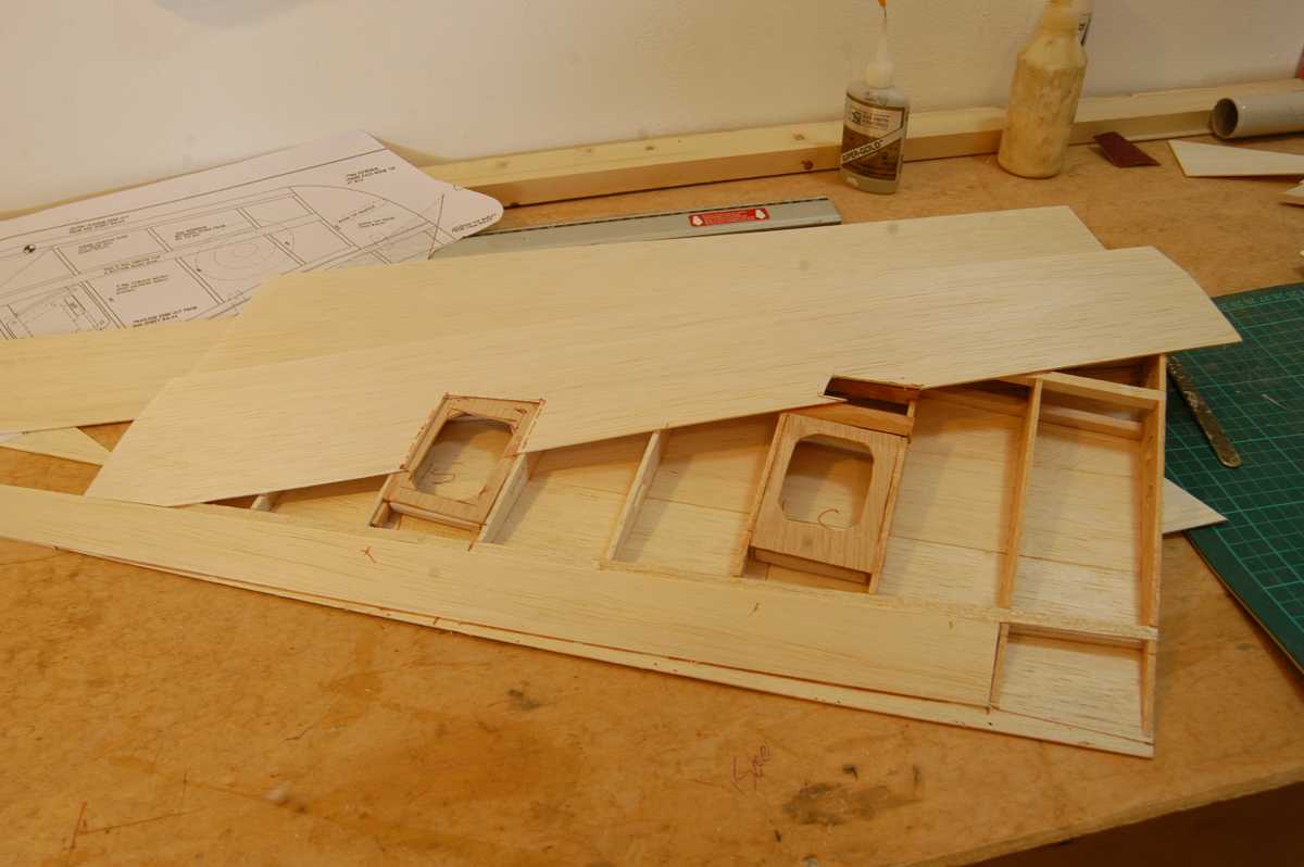

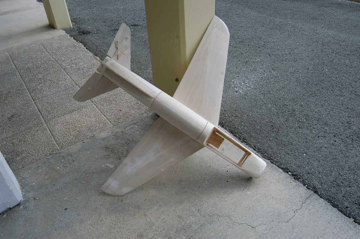

Cut the tail feathers and fin dry fit them
Then started on the wing
Sheeted the top
And built the ailerons and flaps, ill fit the bearers for the retracts and servos then sheet the bottom
Funny that Andy, it is one aircraft I have never wanted, so many of the about, but it was a free plan and it looked like it could be blown up to a turbine size model with some small mods :)

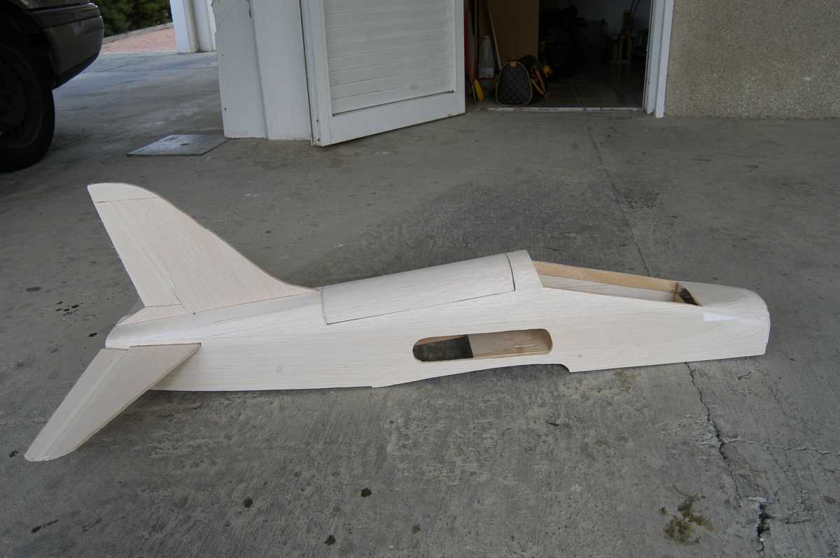

A little more today, not much as I have not felt like modelling
Done the ply frames for the servos and the retract mounts, fun guy this TN, he has hardwood for the servo mounts and
6mm light ply for the retract mounts, I have put in hardwood for the retracts and my favoured method for the servos
Sheeted the bottom and the tip block and finished building the ailerons and flaps
Last edit: 25 Oct 2015 16:27 by THE BLACKBIRD.

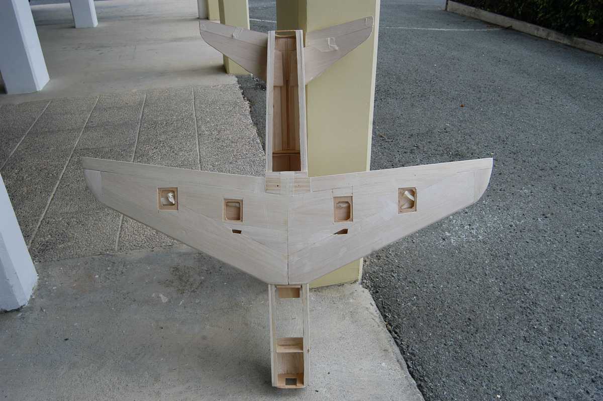

Put it together

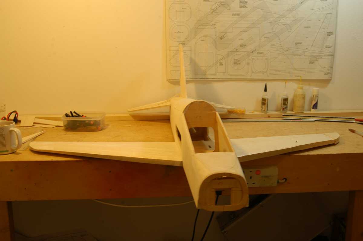

Joined the wing and finish sanding it and fitting it to the fuse
need some blue foam now so I can make the moulds for the canopy and air intakes and maybe the tank that fits beneath the fuse
about done the woodwork until I get the EDF unit, and I don't want to spend the money :( until I get a new turbine, and that's along way off yet,
