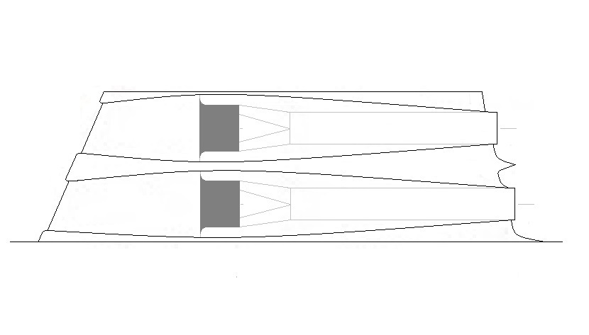

So initial thought on the Comet.
I have to work out the best EDF option whilst retaining scale size inlet and exhaust.
This is the wing root using a 30 mm EDF with the scale exhausts set to 85% of the FSA.
Those small exhausts mean the EDFs fit in easily but the complete Comet comes out pretty big - like 60" span. :ohmy:
Whilst such a size is not a problem in itself it has to be remembered there would only be 12 oz thrust maximum so it really would have to weigh no more than 18 oz all up.
I fear that may be just a bit too optimistic! :woohoo:

Some more options.
1. Fit the biggest EDF that would go inside, like this.
The issue with this is the exhaust would only be about 55% of the FSA so rather inefficient.
2. Use small EDFs but reduce the size of the plane so the exhaust will be under size but hopfully not too restrictive, about 78% FSA, something like this.
With 30 mm EDFs the Comet would come out at 1000 mm (40") span.
At this sort of size it could be built in one piece both saving weight and adding robustness.
The downside is the 30 mm EDFs are relatively expensive. I can get 70 mm one 22% cheaper but at that size the Comet would have a span of 2300 mm (90"). Impressive but a definite no/no!
The first task is to buy a single 30 mm EDF and build a test duct (with the 78% FSA) to see how much thrust is available compared to the same fan in free air.
That will then determine if it worth proceeding..
