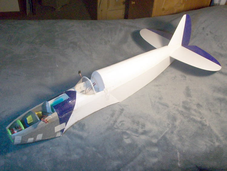

Slowly started repairing the Depron Ballerina. First salvage and repair what is basically sound of the badly crumpled fuselage.
Importantly I have managed to 'save' enough to the fuselage to cover the coplete fuselage wing mount which saves much tricky work to refit the wing bolt nuts. In theory it is just? a matter of building a new nose and grafting it on.
The wing itself suffered only minor tip damage so has already been repaired.

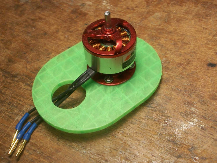

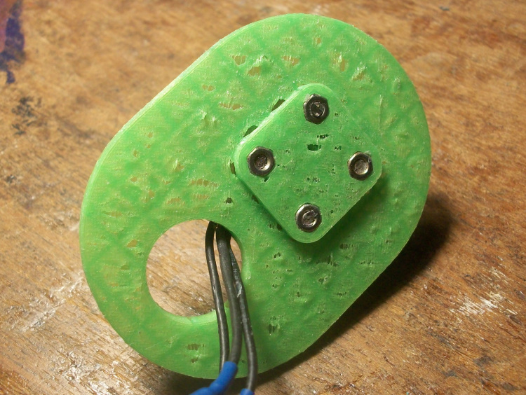

I have already 'printed' a motor bulkhead to replace the broken ply one.
No real advantage in strength or weight but as the motor is bolted on to the bulkhead printing does make it easy to arrange for the nuts to be 'captive'.

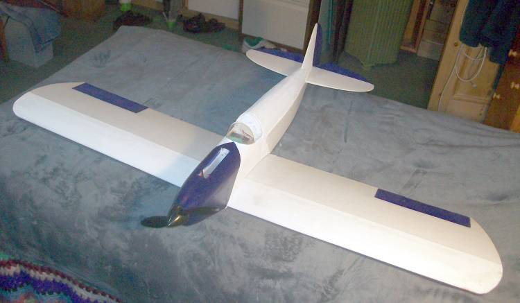

The 'no wheels' Ballerina is all back together.
2 weeks from this:
To this:
All tested with a new rx. Just the battery hatch to add.
With the Big Dragon's old wing aileron replaced, the aileron arms on its new wing extended and the strong easterly preventing any flying means the 'repair list' is now actually getting shorter.
Just the nose of the EPS Hawker P1052 to finish off and the nose of the Depron Airbus A350 to repair.
