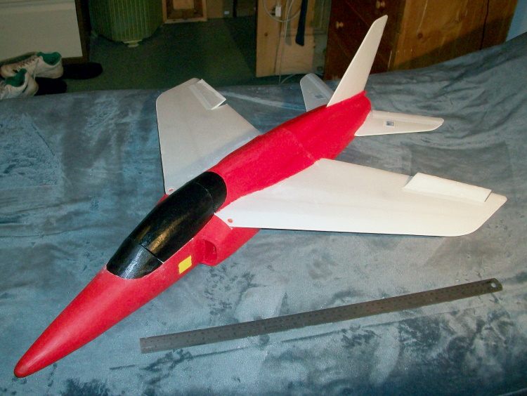

It is nearly finished.
Simple paint scheme no fancy detail. The wings still need a light coat of white and magnets to hold down the canopy.
Couldn't be bothered to wait any longer for the servo reverser so I cut out the LH servo and turned it round 180 degrees.
It is now orientated the same way as the RH one and I tested them to make sure. ;)

The Gnat is now complete.
Its stab rx was 'liberated' from the Ballerina and suitably adjusted to match the Gnat's servo directions.
Without the battery it weighs 338 g (12 oz) so comes in at 447 g (15.75 oz) with its 1500 mAh 3s. A bit heavier than I expected but should still fly ok.
It really needs a more efficient rather than a more powerful EDF.

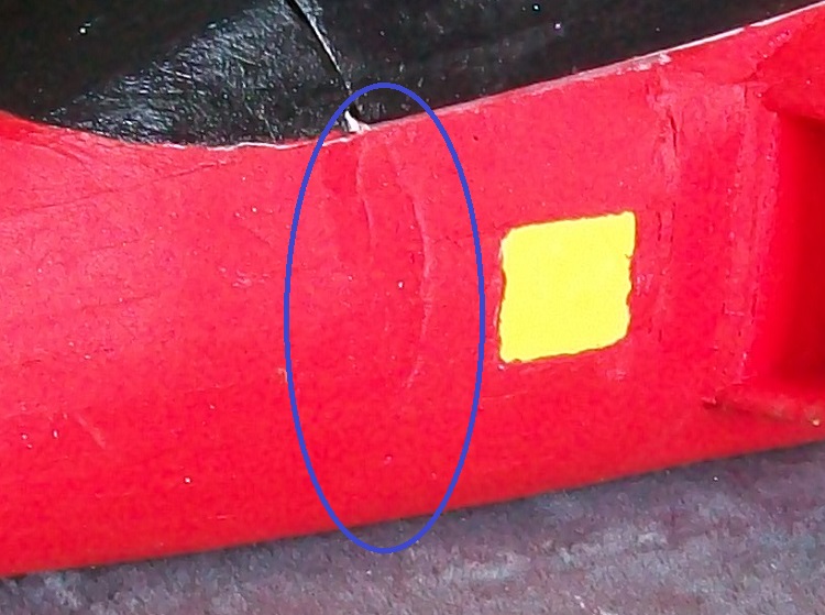

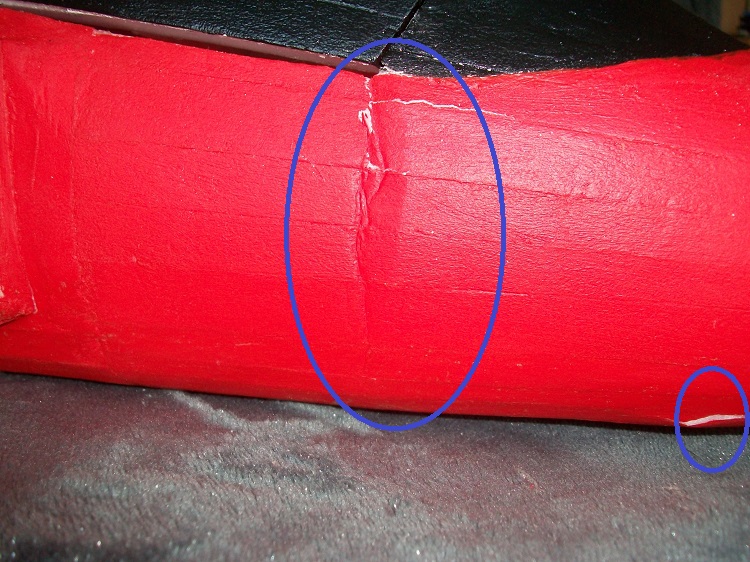

The cockpit canopy sprung open and remained in the tree.
The reason.
A compression "shake" to use the timber term and its the same on the other side the result of a sudden upward blow on the nose?

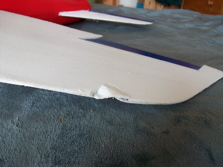

The LH wing hit a branch and 'dinged' the leading edge.
Gently squeeze the wing damage into shape and used the canopy to force the cockpit area back into shape and try again knowing lots of RH stick would be needed.

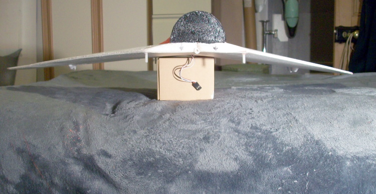

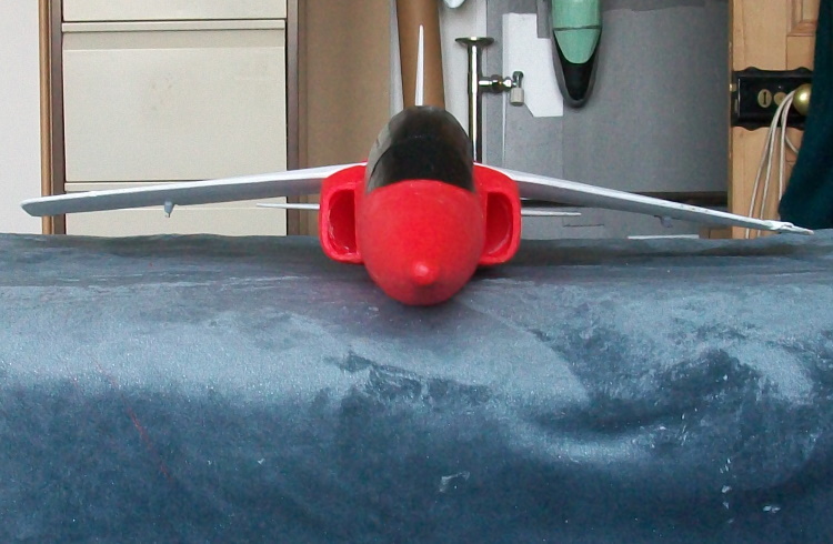

So what is wrong?
A picture tells a thousand words. :ohmy:
A serious warp to cause a LH roll. :woohoo:
No wonder it needed so much RH input to fly straight in fact with its small scale ailerons it is amazing it could be controlled at all.
Of course I should have spotted this. :angry: It is amazing how good the Mk1 eyeball is at spotting defects - once you know what to look for! :dry:

crash
In the southern part of the US Depron is not favoured as it softens and distorts readily if in a car in strong sunshine.
Not much of a problem in the UK ;) so heat and manipulation is the answer to curing warps in a Depron sheet covered structure.
Heat gun on the floor, press the trigger with your foot, to leave both hands to hold the offending section in the desired position in the hot air stream. The fact your hands are in it as well ensures the temperature keeps under the Depron actual 'softening' limits.:ohmy:
Maybe not perfect but much better than it was.
And the leading edge repaired and the paint touched up.

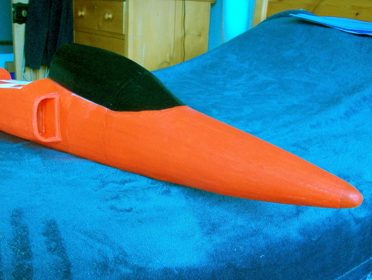

07 Mar 2020 14:16 #74 by Quorneng
Replied by Quorneng on topic Folland Gnat T1
Just to complete the picture the fuselage is now fully restored.
The nose also needed some minor internal repairs as part of the battery box had come loose from the impact of hitting the branch.

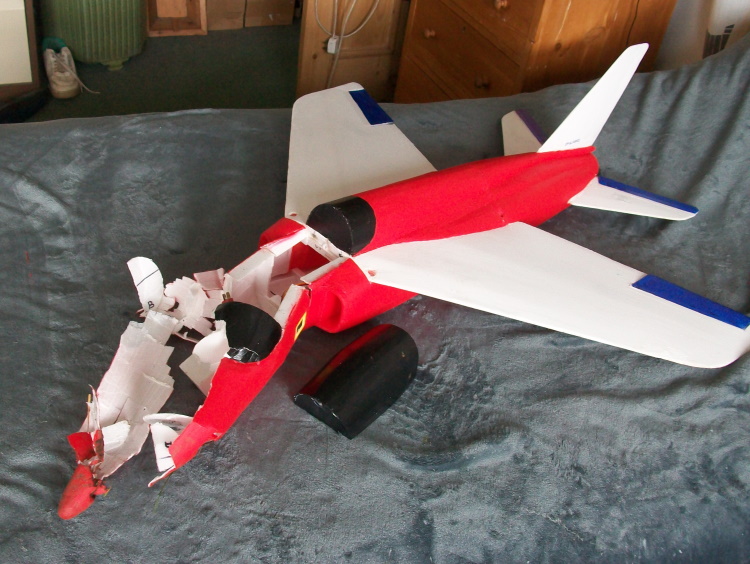

Oh dear!
And I was wondering what to do next.
1st error
The weather looked good and not too windy (at times). I should believed the weather forecast and not been deceived by the sunshine and mild conditions.

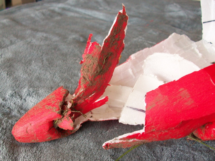

2nd error
I forgot to switch on the gyro.
As I launched at full power a sudden gust, but at almost 90 degrees to the direction of launch, resulted in a severe roll to the left. Just managed to catch the roll but not the descent into the ground still at full power and at quite a shallow angle. The ground is very soft and pitted from dog walkers foot prints so there was little chance of any sort of slide just a dead stop. The nose block ended up buried 2".
As usual with these Depron structures it seriously crumpled so it looks 'terminal' but crumpling absorbs energy so the rest of the structure is completely undamaged and everything still works.
All it needs is a new fuselage from just ahead of the intakes. Simples!
