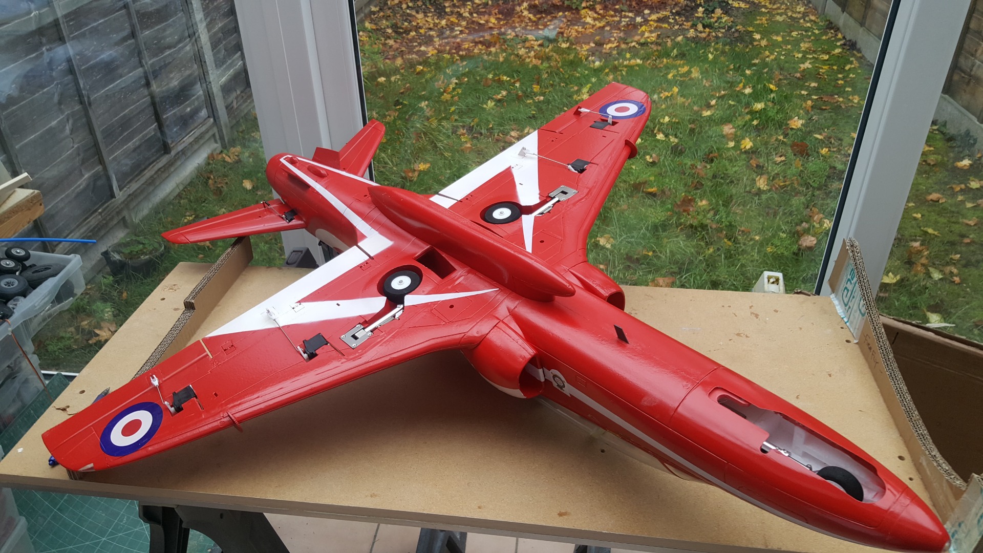

As a belated birthday pressie I bought a Freewing Hawk. A friend that I fly with has an Avanti S which flies really nice but the lack of scale doesn't do it for me. So reading the various reviews that said the Hawk was as good as the Avanti but with scale appearance. So I pulled the trigger and bought it from Motion RC.
The version I bought is the upgraded performance version with the 2957 - 2210kv inrunner motor and sprung oleo's. Comes complete with just the receiver and battery to supply and fit. 6S 4000mAh battery recommended.
Delivery was 5 days and is really well packaged. The model itself is well finished in Red Arrows livery, although the pilot is wearing a green flight suit, so that needs sorting. Assembly is not complicated and the instruction manual is well written, not in Chinglish!!

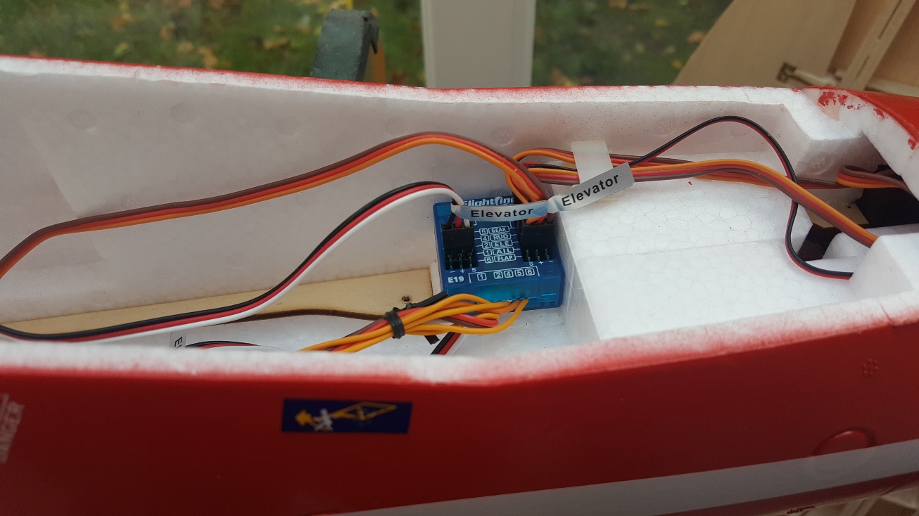

To pull the servo leads from the back to the front they supply a pull hook, nice touch.

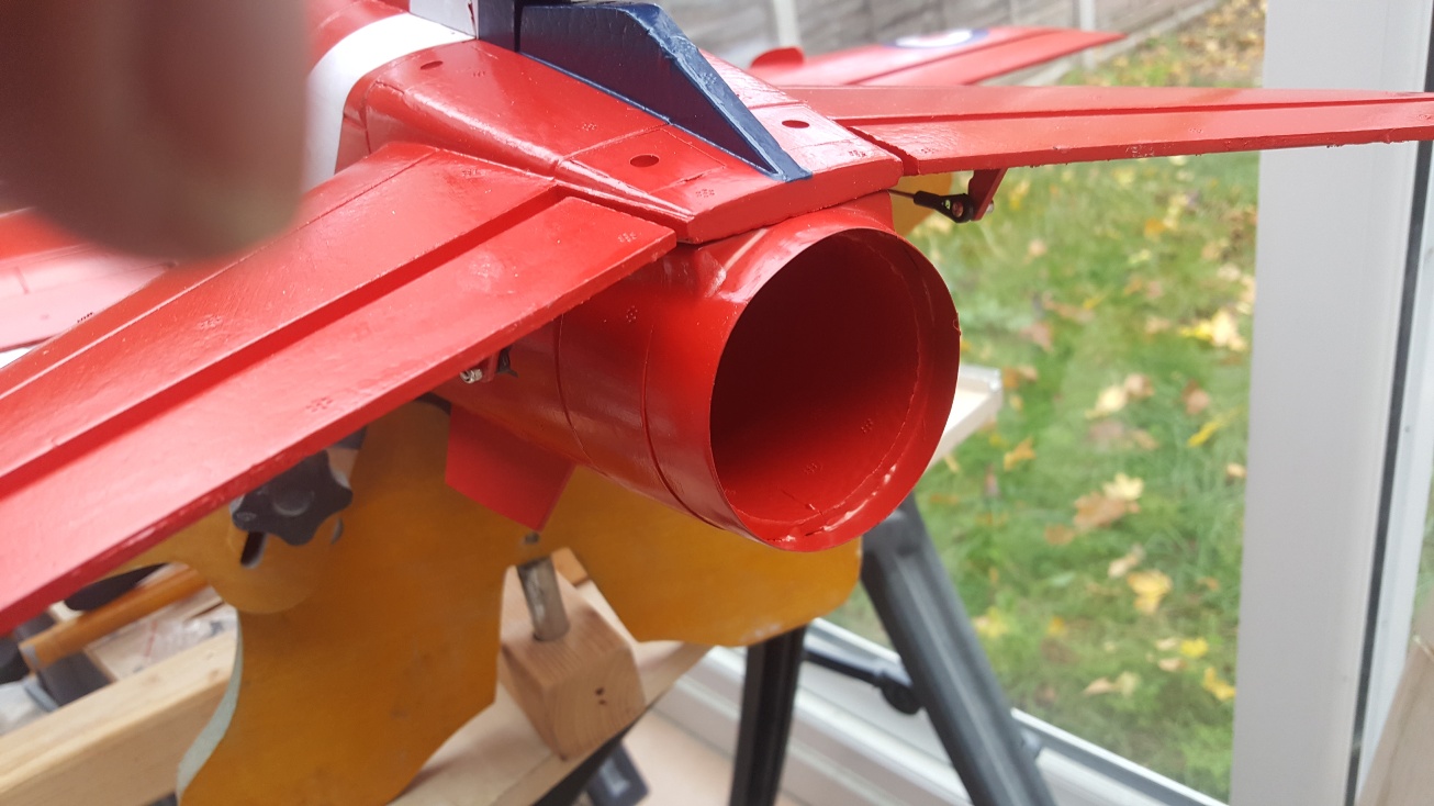

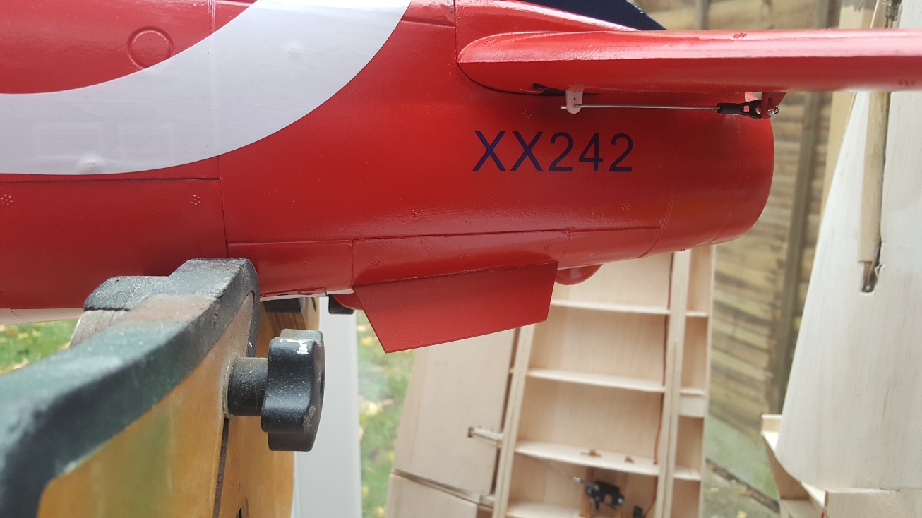

Tail feathers first
Connect servos to the built in connection box which also provides power to the LEDS

So with it assembled I painted the whole airframe with WBPU gloss varnish ( Johnsons Diamond Hard Floor Varnish) to give it some ding protection and also give it the gloss finish of the Red Arrows.

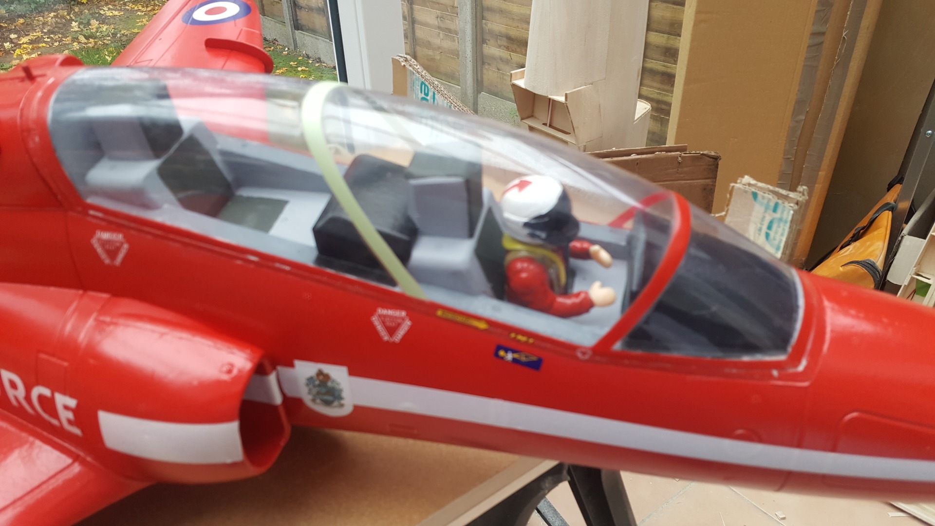

I carefully lifted the canopy of its base with a thin coffee stirrer and dressed up the cockpit. The pilot is secured with two small screws so he was quickly released and painted with a more authentic red flying suit. A bit of matt black for the instrument panels and some matt green for the seats.
Cockpit before
After
