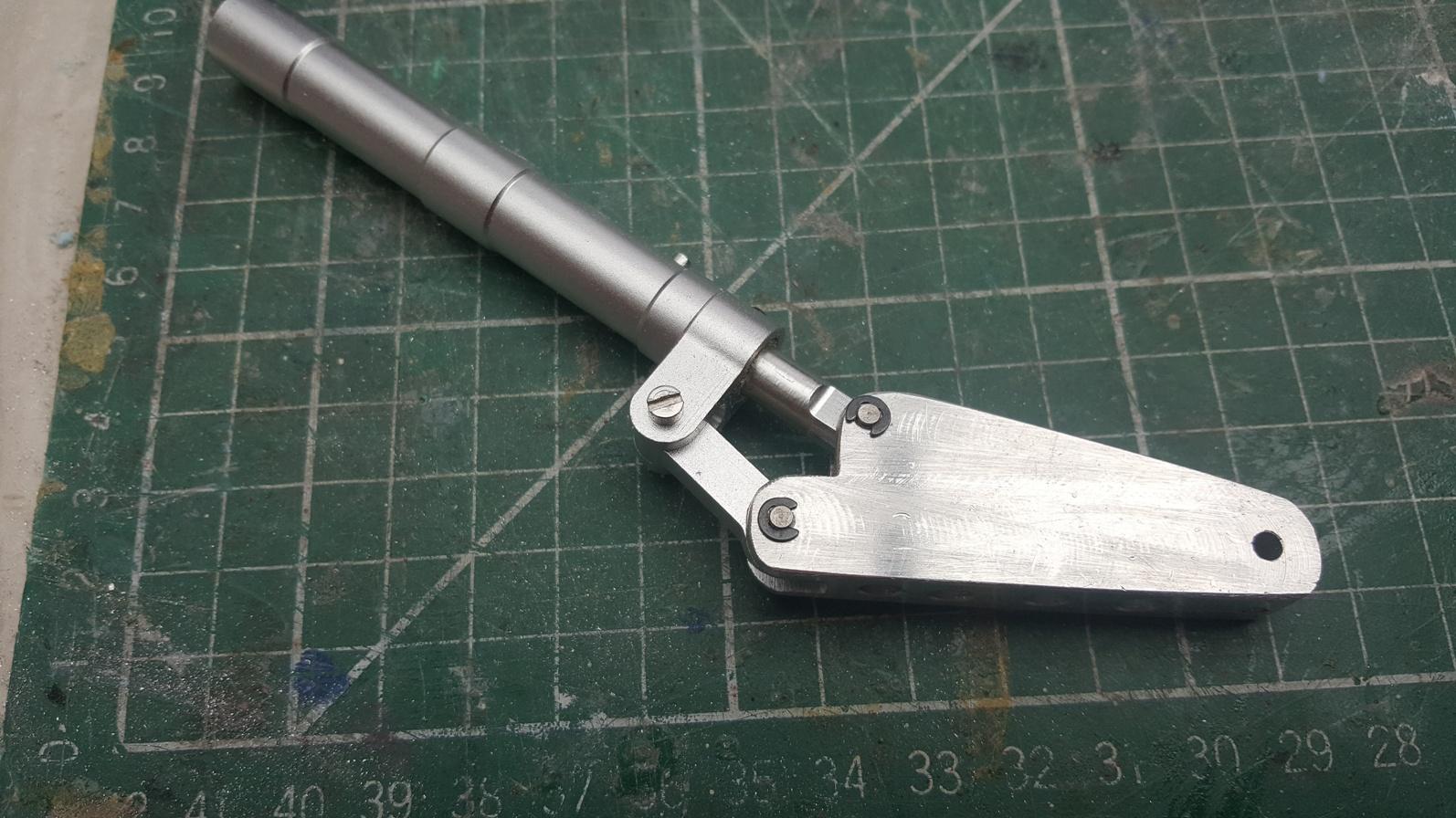

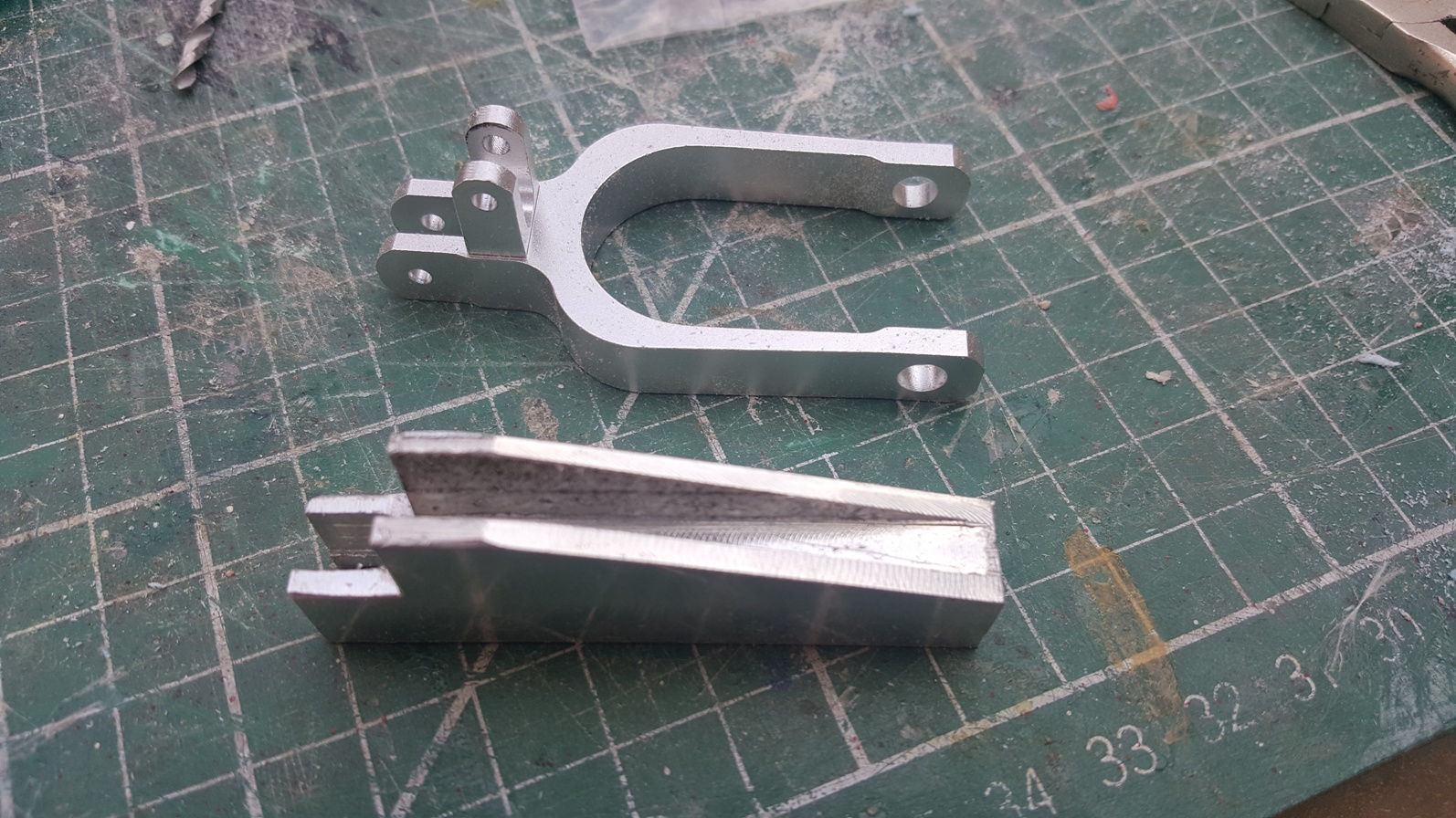

Had a pleasant Saturday working on the Vulcan. Modified the nose leg from a single wheel to twin wheel. This required milling out a new knee section. Photos explain it easier than writing it up.

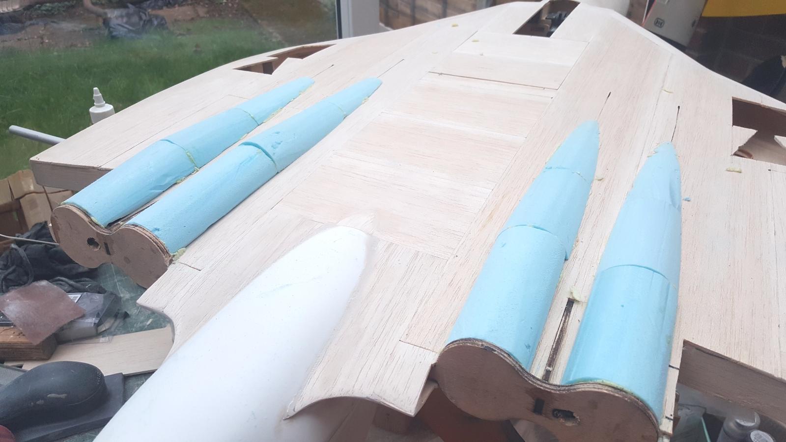

Then hot wire cut some round sections from blue foam. Cut them down and glued them onto the underside. A bit of filling and sanding and they will be ready for epoxy glass coating tomorrow.

Replied by crash happy on topic Avro Vulcan build
Ralph, have you found a foam that epoxy doesn't eat ? If so please tell me the brand ! :)

Hi Crash
Not found a foam thats glue safe. So have to use different glues and resins. A bit of a PITA. Which resin to use on foam depends on the resin base. Polyester based resins eat foam. Epoxy resins are generally foam safe. The G4 Pond Sealer i'm using to cover the Vulcan is polyester based so eats foam. I will cover the foam sections with epoxy resin and the wood parts with G4. Most epoxy glues are foam safe. I use white wood glue and polyurethane glue to fix my foam parts down then cover in epoxy resin and glass (25g/m).
Most cyanoacrylate superglues eat foam, look for foam safe superglue.
Last edit: 14 Mar 2020 18:55 by Ralpharr2001.
  • Ralpharr2001
14 Mar 2020 18:52 #40 by Ralpharr2001
Replied by Ralpharr2001 on topic Avro Vulcan build
Quorneng wrote: Ralph
That's an impressive bit of engineering!
Thanks Q. Its nice to take a break from the wood bashing and play with some metal for a change.
15 Mar 2020 06:52 #41 by crash happy
Ralpharr2001 wrote: Hi Crash
Thank you very much, that's very useful information. :)
15 Mar 2020 09:14 #42 by Eric
Replied by Eric on topic Avro Vulcan build
UHU POR contact adhesive is foam-safe. It dries a bit rubbery, though, so you cannot sand any runs or dribbles off once it has set!
Thanks: crash happy
15 Mar 2020 11:32 #43 by THE BLACKBIRD
Replied by THE BLACKBIRD on topic Avro Vulcan build
why dont you use the same as Simon on his depron models
Thanks: crash happy
15 Mar 2020 13:07 #44 by old fart
Replied by old fart on topic Avro Vulcan build
crash happy wrote: Ralph, have you found a foam that epoxy doesn't eat ? If so please tell me the brand ! :)
I've never known epoxy to eat foam. :huh:
15 Mar 2020 13:34 #45 by crash happy
Mister old fart. The two pack epoxy glue is fine but for some reason epoxy primer eats it. Go figure ? For 90% of my glass fibre work I use polyester resin, which definitely eats it. If I can lay glass tissue on foam using epoxy resin I will be a happy man. :)
