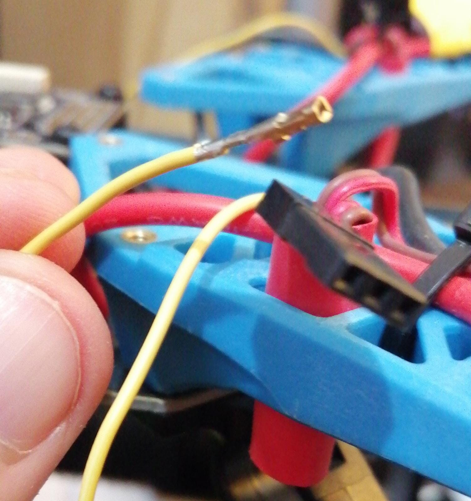

He's also popped the data wire out of the ESC plugs and tucked the rest away nicely. I'm guessing he means we only need the yellow.

27 Oct 2020 21:37 #14 by Eric
Replied by Eric on topic Polydrone
Mike put - He's also popped the data wire out of the ESC plugs and tucked the rest away nicely. I'm guessing he means we only need the yellow.
Trying to figure out what you are doing, here!
The esc's will all require volts in from the battery, and if they ALL have a bec built in - which is what it sounds like - only ONE red wire should be connected to the rx, to provide it with 5v.
All four esc's will require the data line, and the ground (black wire) connected to the rx, or they will not be fed with instructions to power up the motors.
If the ground wire is not connected, the data on the yellow cannot flow - no circuit!
Thanks: admin, Klipkopwildlife
