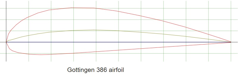

The Ford Trimotor apparently used the Gottingen 386 wing section at the wing root.
It looked like this red line.
Which is similar to what you have on your model so it is more or less true scale.
However it is a very thick high lift wing which is why Ford used it, however it does work at all well at small sizes, very small in your case.
Not in anyway a criticism, I was just pointing this out.
Your plane will certainly fly but with its scale thickness wing not as well as it might.

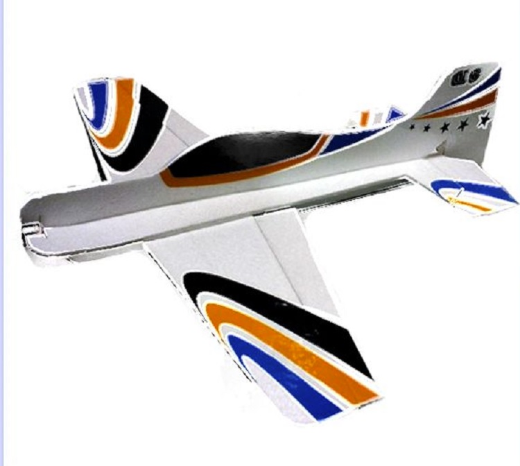

"Shockie" is a class of small highly aerobatic indoor planes that make full use of foam construction and electric power. The are usually entirely made up of simple flat surfaces and look something like this.
I hope this helps.
