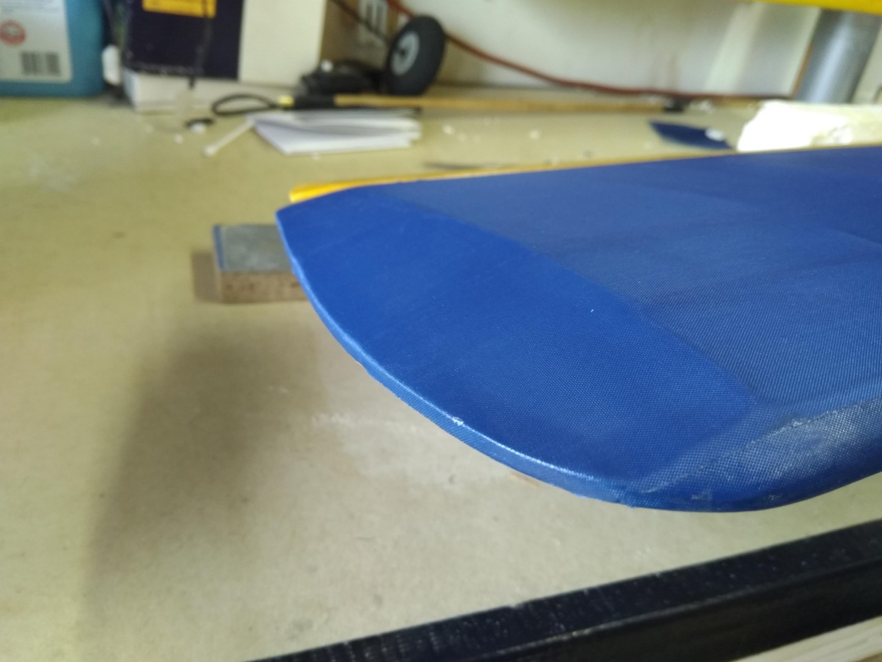

I picked up a damaged tent for £7 last year in Tesco, I've covered one model in it which I ended up digging out of the ground, I'm refurbing an old kit so thought I'd use it again.
It's easy to use but has a waterproof backing so the traditional dope and thinner method of attaching it is no good so I decided to give the frame a couple of coats as usual but use a heat shrink iron to fix it, wow.....poo to a blanket springs to mind!I
The nylon
Ironed nylon
Water spray
Shrinking

Iron temp
It does curves well!
That'll do, ready for dope. It's actually already sealed by the backing but it'll soak up fuel if I don't.

interesting stuff, must be strong but bloody heavy? give the polyester silk a go, it's as light as tissue but many many times tougher.

Heavier than standard, unbacked nylon but super tough, the backing saves filling the weave with dope so it's not far from the traditional method when finished but it is cheap!
I've been using polyester dress lining which is light and tough but you need to be careful with the dope to prevent it from pooling.

The weave of The stuff I use only needs one coat of 50/50 to seal, tissue over the top and another coat and job done.

I vaguely recall a tip - when doping nylon, turn the piece over, so any surplus dope pools on the outside,where it can be teased off or spread out! - (depends on how 'fast' the dope in the can is, compared to the dope with the brush!)
That finished wing looks just like solartex. It reminded me that I once repaired a tent where the pole got punched through the apex. I ironed on a piece of 'tex. It is still attached, and as far as I know, watertight! The tent hasn't been used for nearly 30 years - why I kept it, I don't really know!
