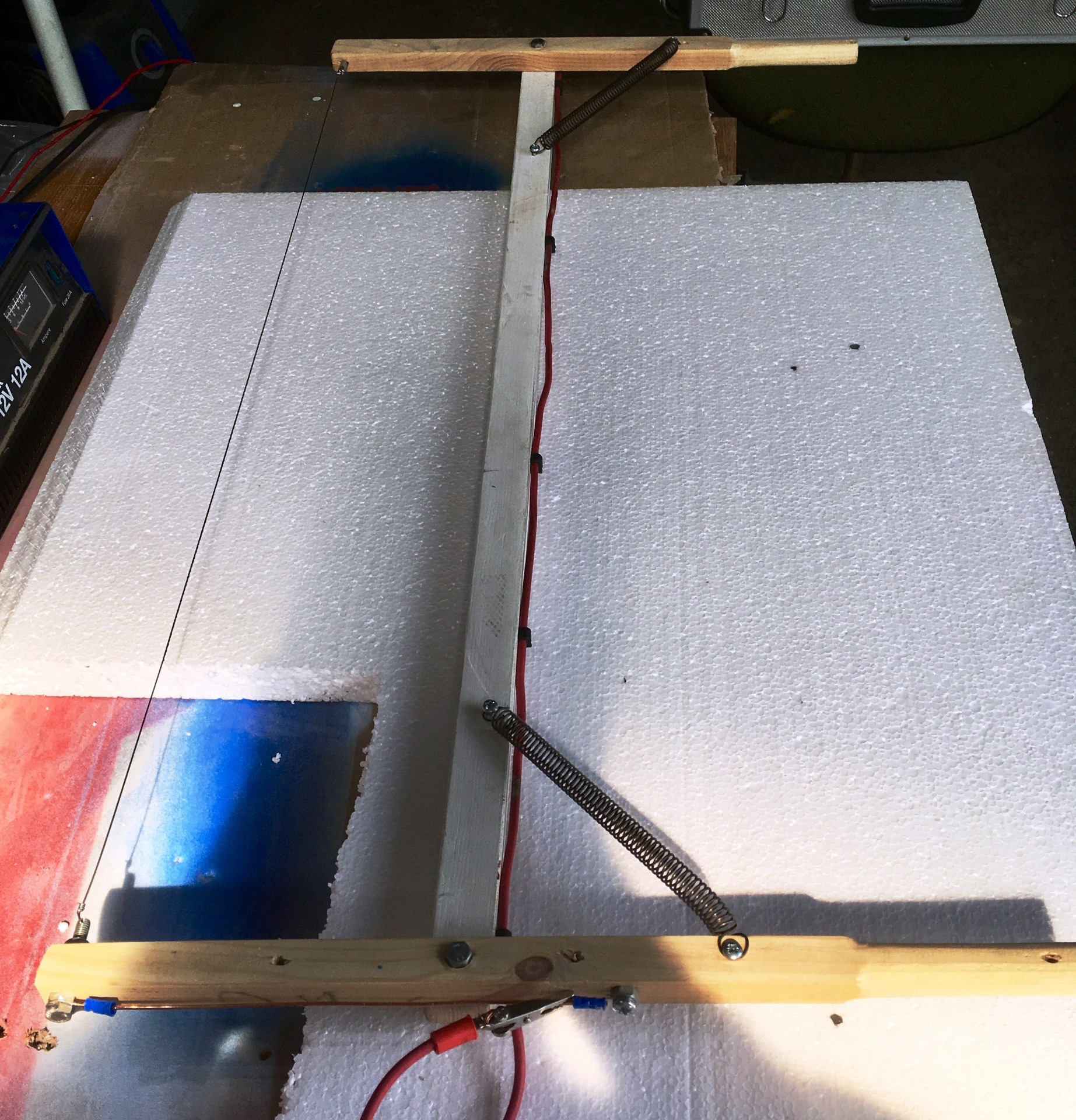

I built this little foam cutter to make thin sheets.
It's just a hot wire suspended over a glass sheet ... it can cut foam into very thin slices.
It can also mass produce foam ribs.

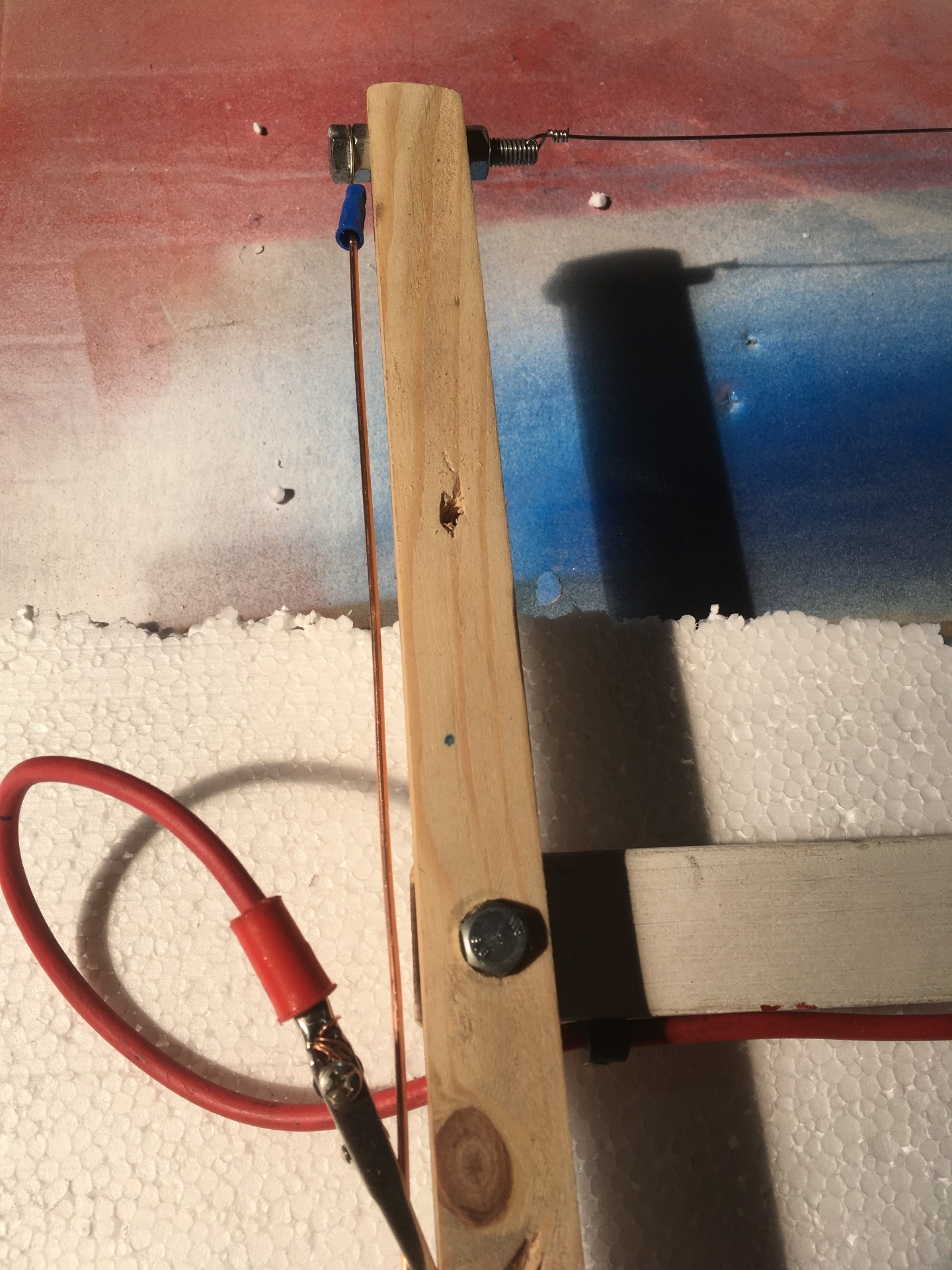

I just knocked up my own version of a hot wire cutter, (idea stolen from Youtube) for cutting wings. runs off a standard 12v battery charger. I used 0.8 stainless welding wire for it's high chromium content. The heat is controlled by sliding the crocodile clip up or down the copper wire on the side to alter the resistance. I would like to fit a potentiometer instead. Has anyone an idea of what I need ?
It cuts well between 3.5 to 4.5 amps if that helps.

A pot to handle between 3.5 to 4.5 amps - you'll be lucky.
Best done with a low amps one controlling a switching transistor!
18 Jul 2019 11:31 #5 by paul d
wouldn't a dimmer switch handle the amps?
18 Jul 2019 11:33 #6 by Quorneng
Replied by Quorneng on topic The Bacon Slicer (Foam slice hot wire cutter)
crash happy
A 10A? brushed ESC controlled by a simple servo tester would do the job as long it had sufficient air flow around it.
I do however think your 'copper wire' method has a lot going for it - simple, reliable and easy to fix!

Just made one small mod to the cutter. Instead of a straight piece of 1.5 mm copper wire, i have changed it for a tight coiled piece of 1 mm. Gives a better variable resistance .

Tight-coiled wire?
Mind you don't burn yourself on it! Think of the old electric fire, with the coiled nichrome wire on a porcelain? core!

I initially used .8 welding wire when I made one, I found that to keep it taught needed a hell of a lot of tension so it dragged a little too much for me, also once it kinks it's scrap. I changed it for stainless fishing trace which suits me better as I've used PVC waste pipe for mine.

Eric. The copper coil being a bigger diameter & with little resistance just gets a bit warm. The welding wire being much thinner & higher resistance is whats generating the heat. As you said it works similar to the old electric fires, only the element got hot not the wiring to the plug. Having said that, I have put it out of the way of any pink bits !
