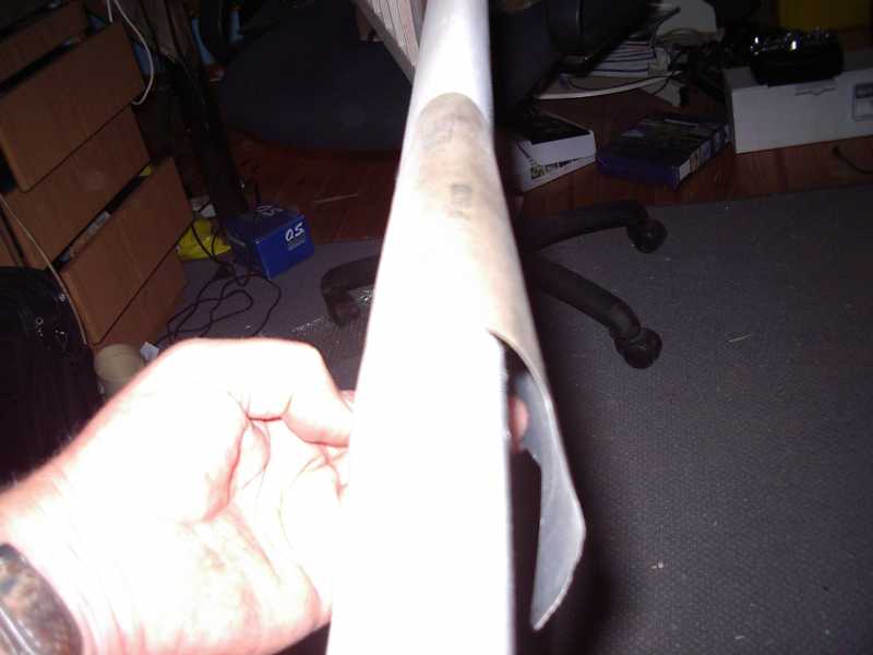

12 Nov 2011 16:15 #34
Replied by Klipkopwildlife on topic Re: Back to basics, building model aircraft.
This is the way I sand anything that needs a rounded edge.
I always use 'wet&dry' for sanding, you can get 4 strips to a sheet.
hold the wing, or whatever, between your knees, hold each side of the paper with your thumbs and pull down each side alternately. Works like a charm.
