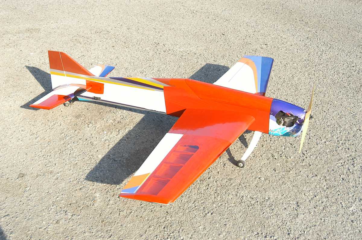

27 Jun 2013 08:51 - 27 Jun 2013 08:59 #20 by THE BLACKBIRD
Replied by THE BLACKBIRD on topic The Fliton Inspire F3A rebuild
Got my camera back so here's some pics
But now i have a BIG AIR HOLE the other side where i cut for the side mounted engine
and where parts of the crumpled cowl fell out
Must have had my brains somewhere else to have mounted it sideways :silly: :silly: :silly:

27 Jun 2013 08:59 #21 by Ex-Member
Replied by Ex-Member on topic The Fliton Inspire F3A rebuild
looks a lot better that way round BB.
sometimes we get an idea fixed in our heads and cannot see any other way of doing things.
cut a bit of plastic to fill the big hole sir.
