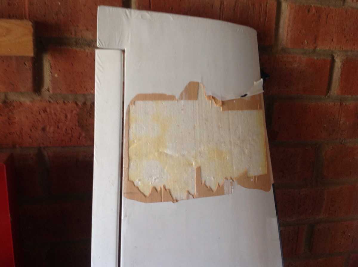

The model I picked up frm eBay needs a bit of a repair to the wing tip, it looks like the wing tip has smacked the ground.
The veneer has lifted slightly, this I have already cut away, the foam core has a slight ridge/crease running from leading edge to tailing edge.
It doesn't look to difficult or a lengthy repair, however I have no experience of repairing foam wings any tips would be greatly appreciated

Dean, a wing-tip is easy! There isn't much loading stress applied to a tip, unless you hit it with the floor too often.
So, as you have cut the veneer away (you should have left it, if it wasn't damaged!), try gently warming the foam core with a hair dryer - NOT a paint stripper!! - and see if the crease will expand itself out. If it is right at the tip, within an inch or so, don't even bother with that! Just use your covering iron, and iron it straight(ish), then it's just a case of re-sticking the veneer, and covering it again.
If you have discarded the veneer, see if a piece of cornflake packet is the same thickness, and use that.
Bond the veneer/cornflake packet to the foam with pva glue, and tape/strap/tie knots in bits of string/use elastic bands and clamp it down, then leave overnight at least, to dry, making sure the wing hasn't twisted.
When it is definitely dry, it is just a case of re-covering with your preferred medium, heat-shrink film, tish, etc. If you use tish and dope, be warned, cellulose dope eats polystyrene, so if there is the tiniest gap in the join in the veneer, there will be a hole underneath it, after you have applied the dope!
p.s. Check your lateral balance when you have finished!

youve shown the model Dean, lets have a piccy of the repair area

I would guess it is about 6-7" in from the wing tip

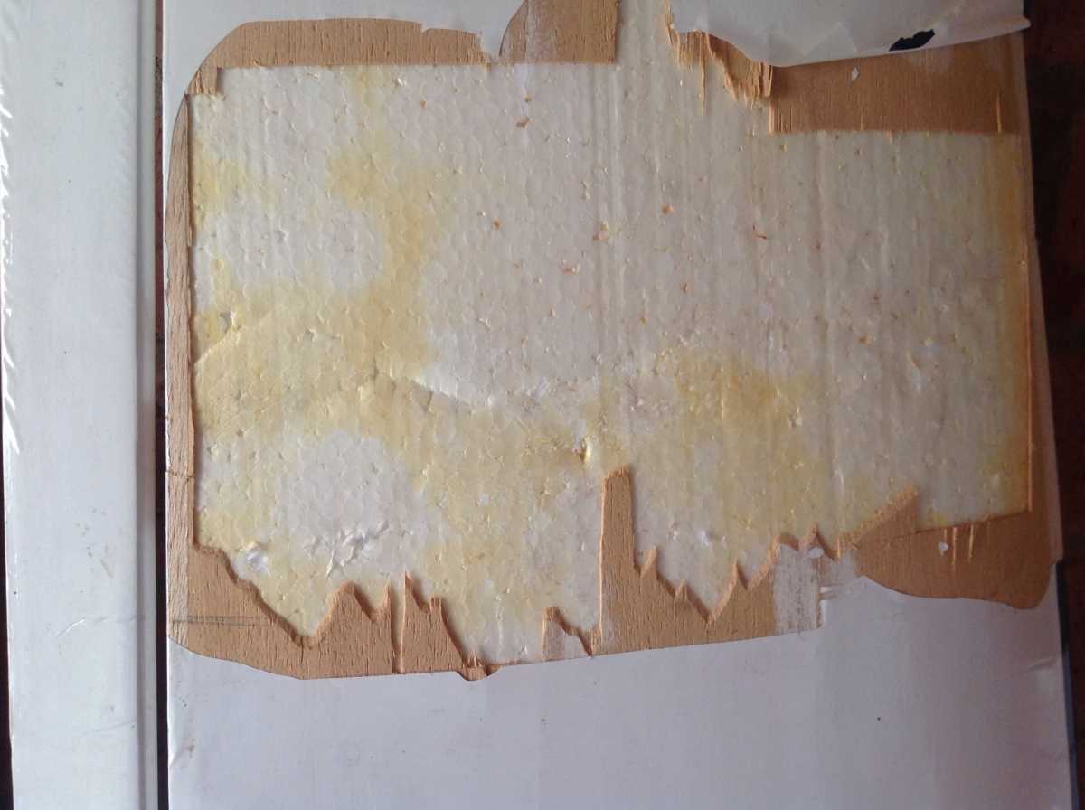

It just peeled off so easily, went to far I think! Will neaten up all the edges and squeeze some PVA between the remaining veneer

You could use 1/16 balsa on that, i would if it was mine with PVA sand it down and cover
I would step joint it to the veneer, just cut 1" x 1/2" steps in the veneer be stronger than a straight joint

Hi Dean no if you cut a straight line in the veneer then just cut 1"long x 1/2" wide pieces out say from the leading edge go 1" along the straight cut in the veneer then cut the 1"x 1/2" piece out, go another 1" along the straight line then cut another 1"x 1/2" piece out dont have to be an inch you could measure the wing across and divide it into equal steps
The best way to do it is cut the steps in the balsa first then lay it on the wing and mark the veneer from it, cut to the lines and you get a perfect fit

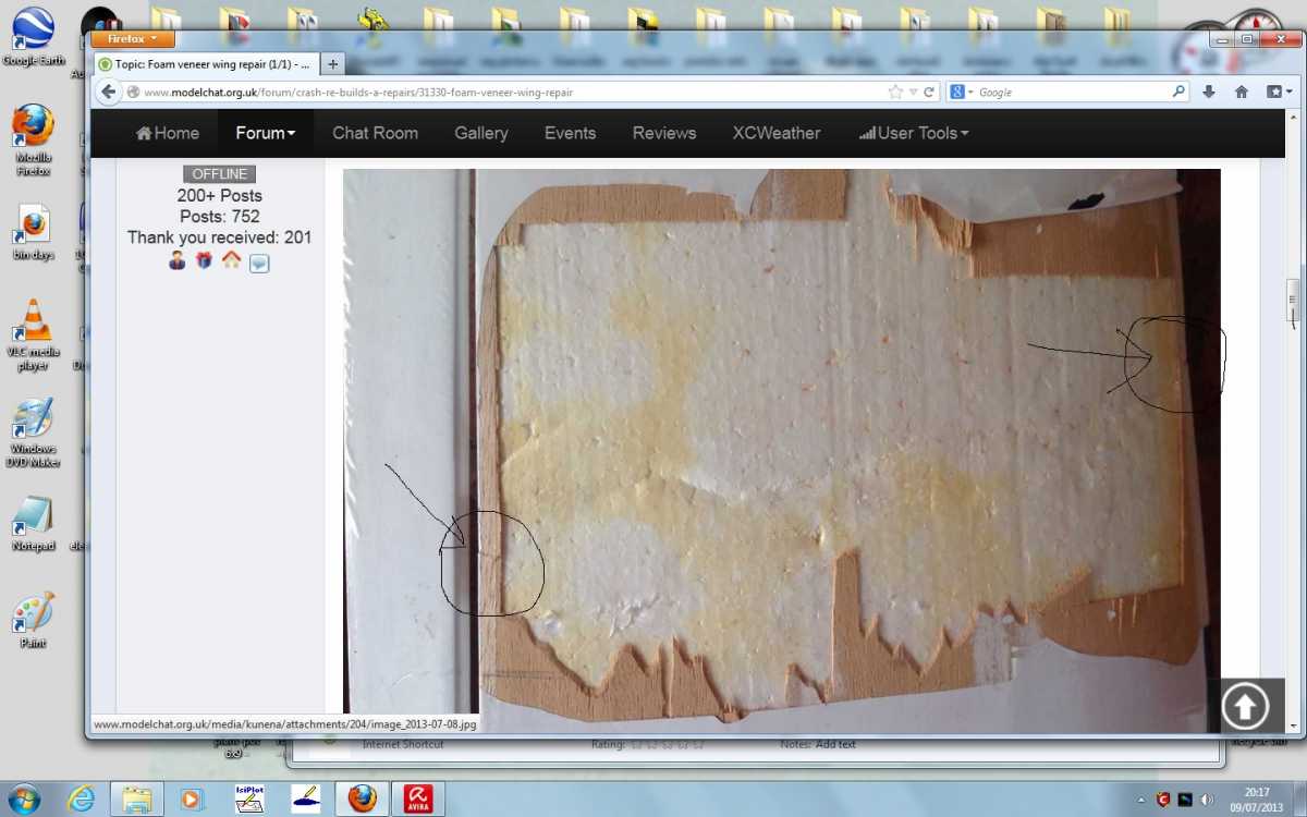

Dean, looks to me like both the leading and trailing edges are broken, you're going to have to cut them out, about 2" should be Ok and glue in some new. Remember you must do 'scarf' joints.

As Klippy said, the leading and trailing edges look cracked, and need mending, because they form most of the strength of a foam wing. All the foam really does is hold the veneer in shape!
Regarding what to use as veneer, I did put - try a piece of cornflakes box, to see if that is the same thickness.

Remove the foam from behind the leading edge so you can get a bracing piece behind it, i would not cut the leading edge and splice it, as you are making two joints, i would run cyno in the crack and fit a 6mm ply brace behind the leading edge well glued with pva
