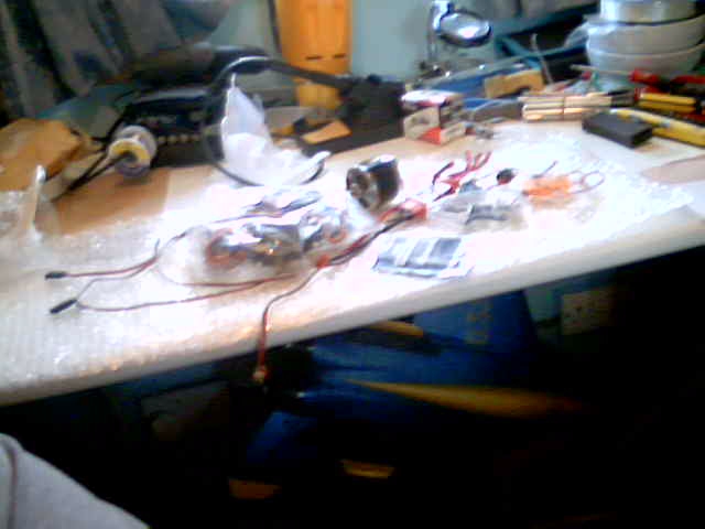

Opened the box got all the electrics to gether
r .
16 Apr 2012 22:30 #2 by Garry Pollard
Replied by Garry Pollard on topic Re: Kyosho spitfire 50
Hi Blue.
Yes as I expected, same as mine. Dont want you to think I am trying to teach your gran to suck eggs, but the flaps , etc are NOT glued in at the factory. Mine was so tight I thought they had done it for me, They HADNT !!!
If you are using the supplied retracts, put a small kink in the operating rod where it joins to the retract servo. I think they suggest this in the instructions
Take your time. It is an ARTF kit, but will not be done in a couple of evenings. There is a fair amount of work to do, but it is well worth it

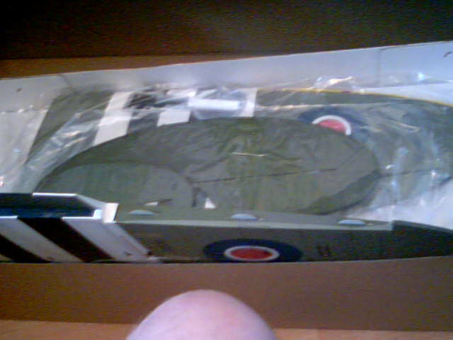

16 Apr 2012 23:43 #4 by Klipkopwildlife
Replied by Klipkopwildlife on topic Re: Kyosho spitfire 50
Hi Blue, and welcome if I haven't said it before. Nice bit of kit, enjoy.
17 Apr 2012 00:44 #5 by Garry Pollard
Left wing all done?????? Not having retracts then :) :) :) :)
17 Apr 2012 01:37 #6 by Eric
Replied by Eric on topic Re: Kyosho spitfire 50
That aileron horn is too far back! You are supposed to have the holes in line with the centreline of the hinge, or you will not get the proper movements!
Is that roundel peeling off, or are those black marks around the white circle just funny shadows?
17 Apr 2012 01:51 - 17 Apr 2012 01:53 #7 by Garry Pollard
Well spotted Eric, must say I missed that completly , but must agree. It is in comletly the wrong place. Be lucky if he gets any up movement at all
Puts a new slant on differential :) :)
Last edit: 17 Apr 2012 01:53 by Garry Pollard.
