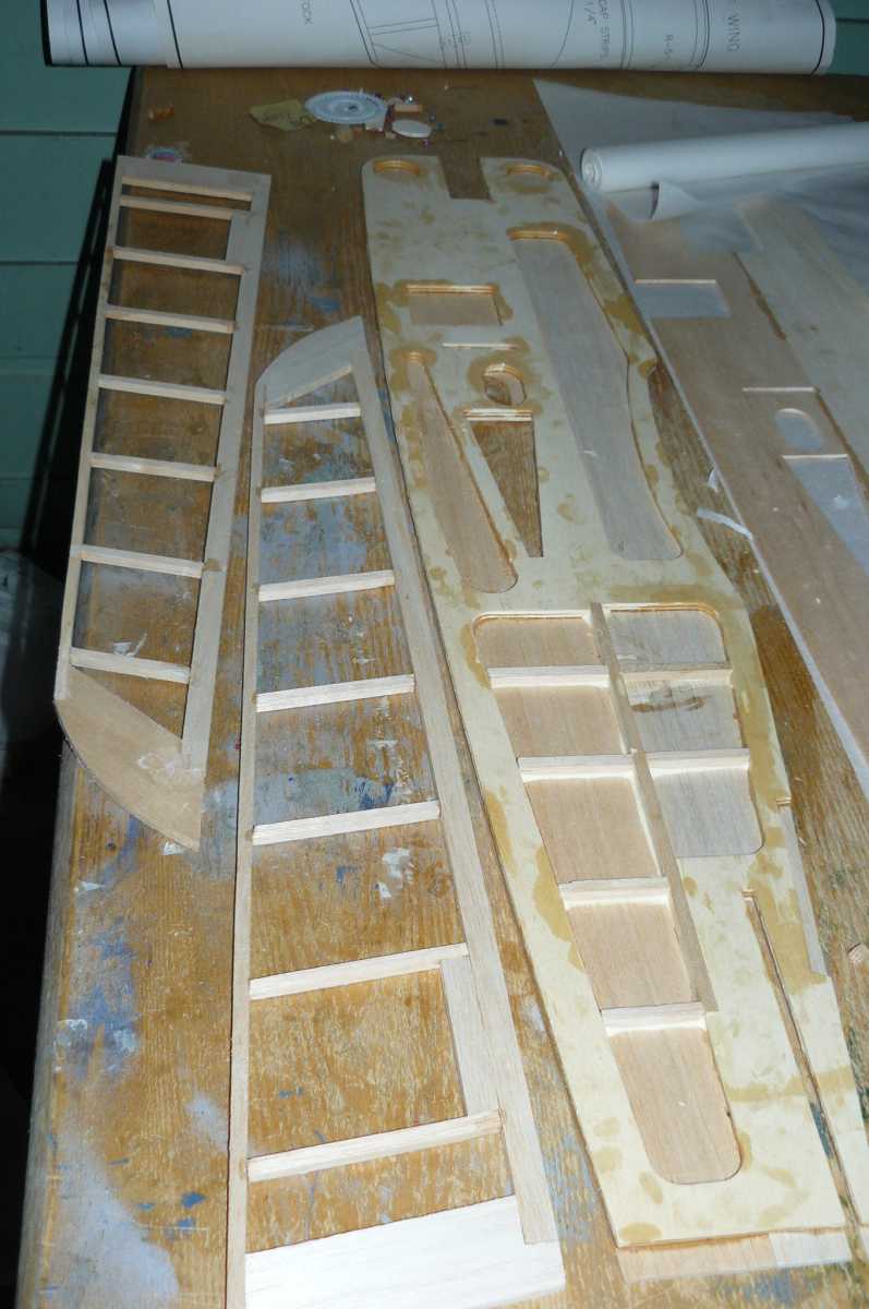

10 Mar 2014 01:34 #19 by a4kskyhawk
Replied by a4kskyhawk on topic bearcat funfly 40
well i have just about done the wings and they are the same size :P . next is the ailerons .

10 Mar 2014 07:23 #20 by a4kskyhawk
some more bits done today, body started and ailerons done.

12 Mar 2014 05:58 #22 by a4kskyhawk
well done very little as worked called, so i have started to sand the edges and get ready for covering.

13 Mar 2014 05:52 #25 by a4kskyhawk
well done a little more today, started to set wings to body. so then i can start to do tops of wings and ailerons.
