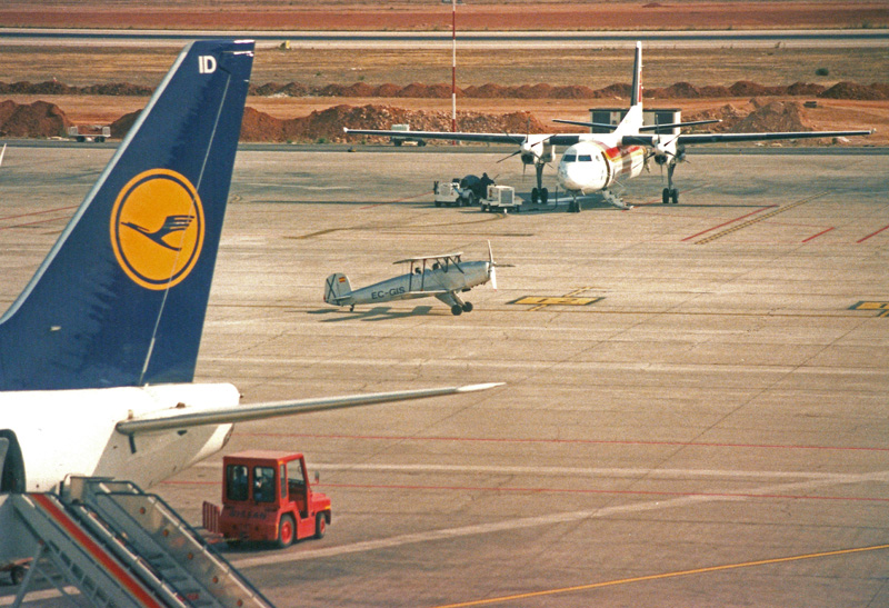

Slightly Off topic, but sort of relevant. This was a Bucker Jungmann taxiing out at Valencia airport amongst the big stuff, a few years ago.
