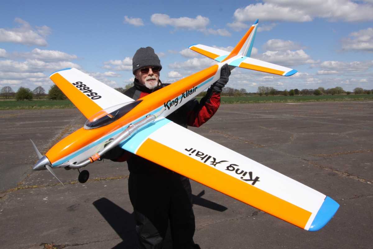

You want inverted running a pipe?
MVVS90,14*8, 80dBa @ 7M
