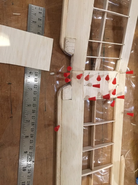

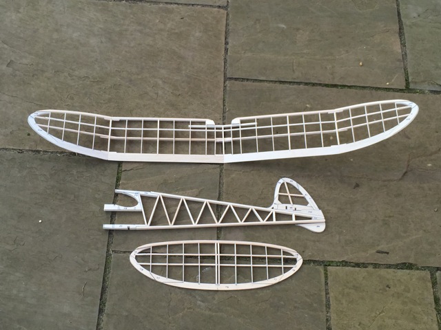

The wings are now off the board and the LE root fairings have been added. Outlines of all parts have also been tidied with a razor plane.
Sanding will have to wait until I can cope with the dust and fuselage formers will be on hold until I can access my bandsaw or similar. In the meantime, the next job will be LE sheeting of both the tailplane and the wing.
I do like the shape of this model, lots of curves....which, of course, is why I chose it! :) :)

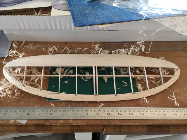

Slow but steady progress today. The tailplane upper front surface has been sheeted and the LE and TE have been rough planed to shape:

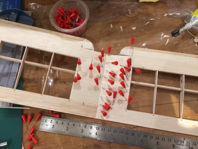

Progress now will be slow. I've cut the LE sheeting for the wing. I'm having to use a slow drying glue (aliphatic resin) to give time to coat the glued surfaces without the glue drying. So, with 6 panels to sheet, and with the drying time for the glue to be dry enough to remove the panels from the board at about 1 to 2 hours, I have up to 10 hours of drying time between start of sheeting and job complete. There's only about 2 hrs of actual modelling in that time though. ;) ;) Good job I have shopping, walking and admin to do today......
13 Sep 2015 20:01 #22 by Ex-Member
Replied by Ex-Member on topic KK Bandit
...and a slow job it was too, the final panel was fitted at 1930 BST this evening!

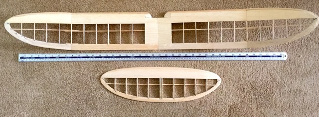

This one is now on hold. The fus and fin have not changed from the above pics, the current state of the wings and tailplane is pictured below. They've been planed, carved, and, where necessary, filled with either balsa or lightweight filler. Work should continue in early November.

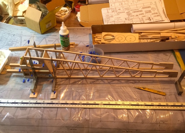

.....which allowed the fuselage sides to be joined. The bearers are dry fit only to align the holes.

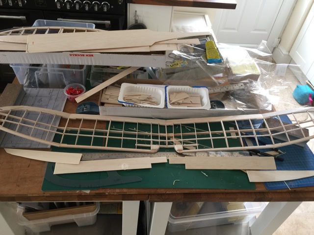

Sanding has also progressed on the fus sides and flying surfaces. Pics of the latter should follow tomorrow.
