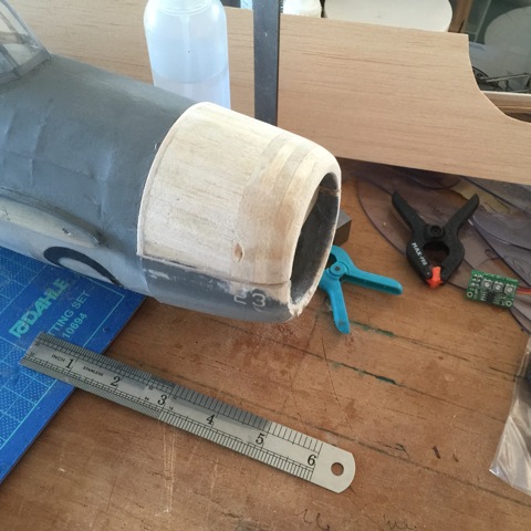

I've decided to modify my FF rubber Wildcat to electric power for next year's open scale competitions. The model was originally built in 2012 for the USA's Flying Aces Club Nationals at Geneseo. It flew, getting into the second round of a three round competition, but wasn't particularly successful. I modified it for British competition by adding some detail and painting it. Again, she flew, but didn't perform.
So, in order to get a more consistent flying performance and flight pattern and to increase the duration slightly, I've decided to convert her to electric power.

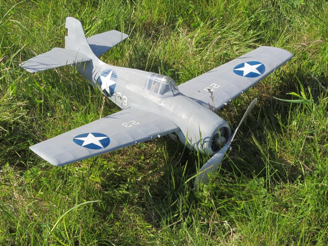

Here's the original model in rubber powered fit photographed in 2013 at the BMFA's FF Nats:

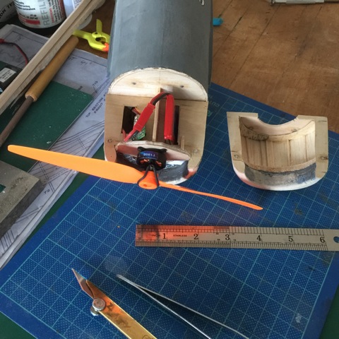

I've cut the top of the cowling off, made up two ply plates to face the join, aded a former to the fuselage and made up a motor mount:
The model's a 1.5 times enlargement of the 1:24th scale FF rubber powered WW II series models published by Model Builder magazine in the early 70s. Mods to the original design have included knock-off wings and tailplane and a change in wing section.

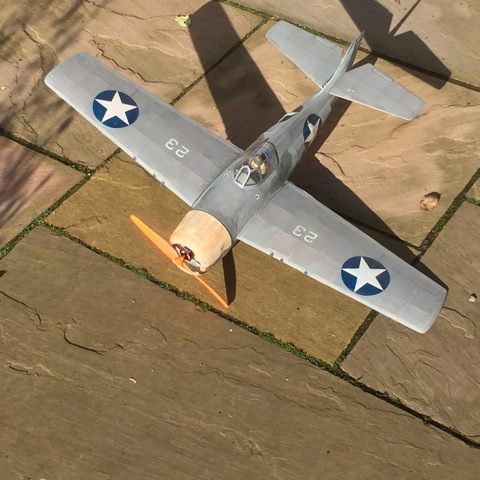

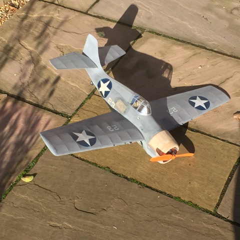

The basic cowl is now complete. Formers have been added, magnets introduced as a fixing device, the upper cowl stripped of tissue and the front end sanded to suit. Second pic show a trial motor/ESC/LiPo/Profiler fit.
The front end needs filling here and there to repair damage, but I'll probably leave that until I've tested her in this new config. I'll just seal the bare balsa with dope which will do for this weekends flying.

The model flew successfully at Barkston in the 2016 BMFA Scale FF Nats fun event when it looked like this:

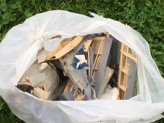

Unfortunately, it met it's demise at this years BMFA Scale FF Nats, when it ended up looking like this:
..and this is all I retained:
