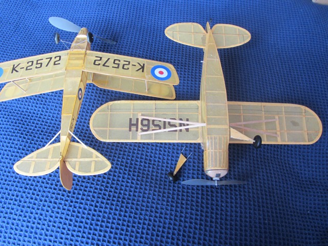

Here's a couple of suggestions for you Nigel:
Spraying - it's the only way to get an effective and light colouring to a flying scale model. A single action external mix air-brush is perfectly adequate and they are not expensive. I'll say no more on the subject and leave it with you......
Coloured tissue covering can be quite effective, but unless you use silver tissue, the covering will always be translucent, and therefore, model-like. Here's a couple of examples, first off, my Veron Tiger Moth with the black markings ink-jet printed onto yellow Esaki tissue. The roundels were sprayed, but I've had success with coloured tissue cut with a compass cutter. You need to paint the back of the tissue first to make it opaque. The monoplane is the KK Piper Family Cruiser, and both aircraft have 'battle damage':
The next one is Kev Wallace's (planekrazy) VMC Tiger Moth covered in silver Esaki tissue with markings printed onto thin paper (airmail weight) and stick on with tissue paste:
  • Nigel
