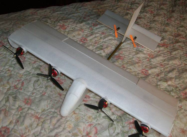

With gales outside there is no chance of testing it so I have done some 'hand held' running.
With the 2200mAh flight battery the CofG is at 24%. Probably a bit far forward as flaps tend to move the CofP rearward as they descend.
With flaps up the elevator produces quite a significant nose up/down pitch and similarly the ailerons a roll force.
As the flaps go down the weight in hand reduces but with a nose down pitch. At about 20 degrees flap even full up elevator only just contains the nose down pitch.
At full flap the weight in hand is small but the nose down pitch is strong. The elevator has little effect although the ailerons remain effective.
Conclusion.
It should fly 'as is' (with a bit of tail ballast) but the maximum usable flap and thus the minimum flying speed will be determined by how far back the CofG can go and elevator authority.
A radical solution to both these problems springs to mind - independent prop wash over the tailplane.
This is sort of thing I had in mind.
In total they weigh 0.8oz which brings the CofG back to 30%, on the spar.
24" span and 6 props and motors!

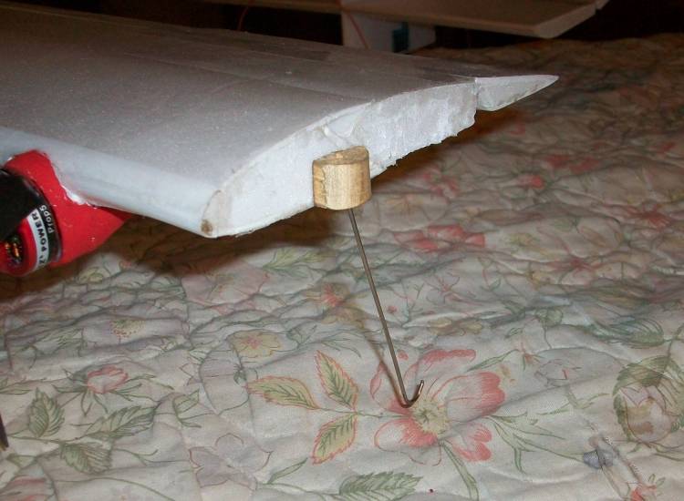

For the next attempt I think will remove the end plates altogether and substitute a simple wire skid to protect the out board props. The end plates are after all only likely to be really effective at significant flap angles which I am some way off using!

The wing end plates have been removed and wire tip skids added.

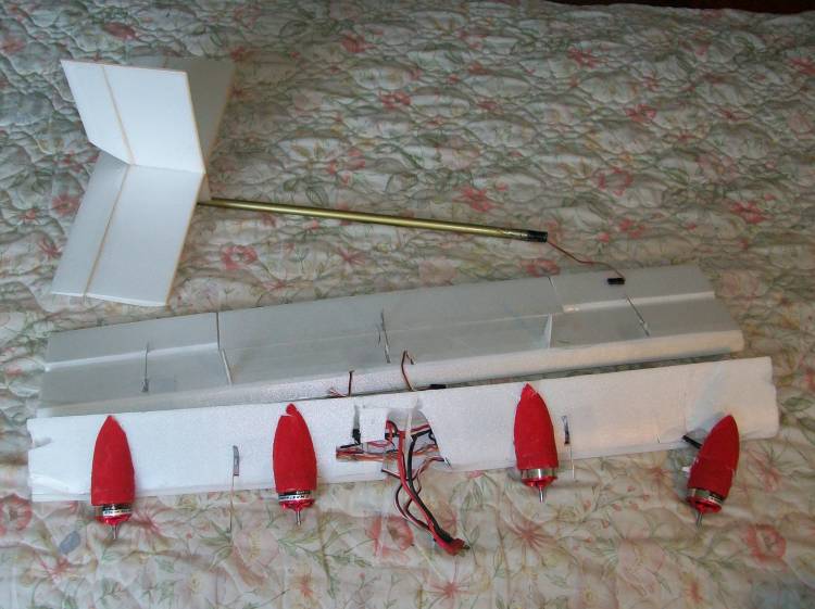

The fuselage virtually destroyed, 2 props broken, a motor torn out, the spar cracked and the wing tip crushed. The tail, boom and the flap sections were undamaged.
This flight did however convince me that it was never going to fly well enough to actually use the full flap movement. It would either be impossibly fast with no flap and impossibly unstable at full flap so a major rework seemed to be required.

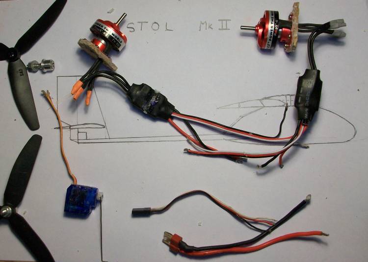

Same configuration but only two motors and the flap reduced to only half the travel.
This would obviously mean vertical flight would no longer be possible but it should still posses a serious STOL capability although with undercarriage it would technically be just SL!

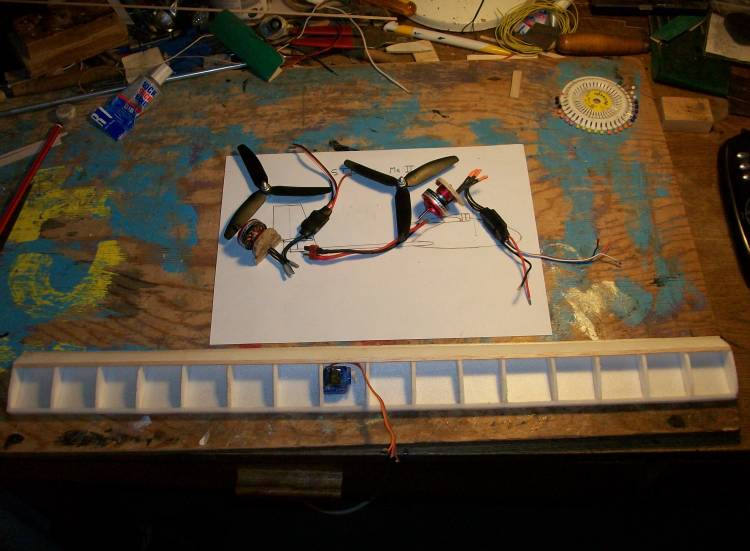

So first salvage the bits required.
A new wing.
With only 2 motors the electrics are much simpler and take up less space.
With the motor centre line raised just above the wing the props should be protected without any need for tip skids.
Last edit: 16 May 2012 23:43 by Quorneng.
