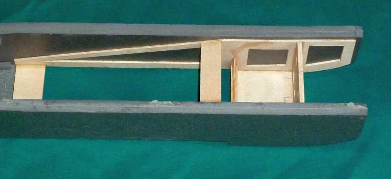

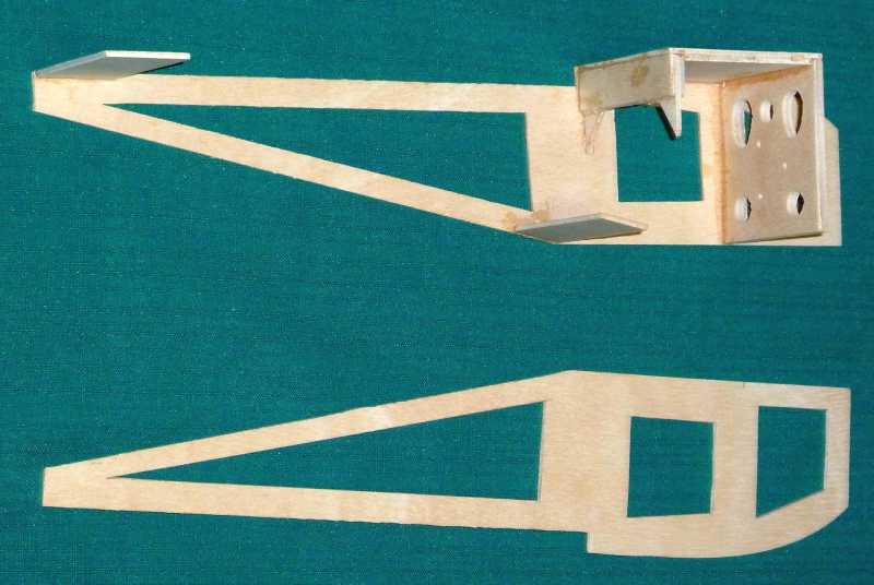

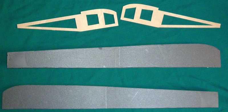

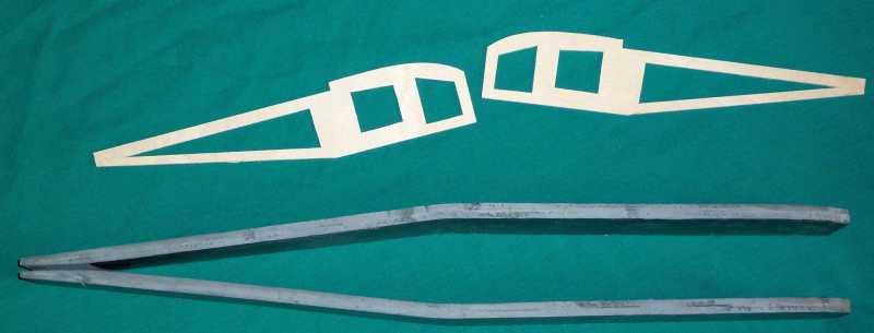

The fuselage side panels and the ply doublers.
The sides are made of two layers of 6mm depron, held bent while gluing, so the shape doesn't have to be bent in when joining.
The two ply doublers are joined by the firewall, undercarriage floor, and a former that will take the load from the undercarriage, and support the battery tray.
Sides glued onto the ply assembly

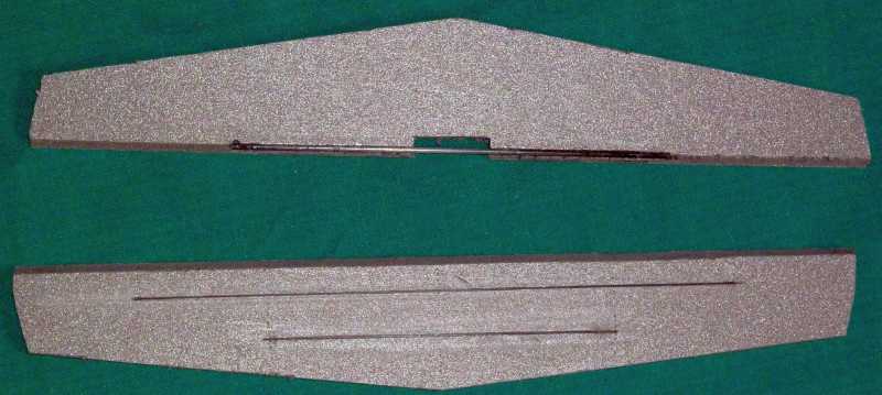

The fid part of the tailplane is stiffened by two strips of carbon fibre.
The elevators will be cut and only held together by the carbon torque tube, just left it in one piece while gluing the carbon in.

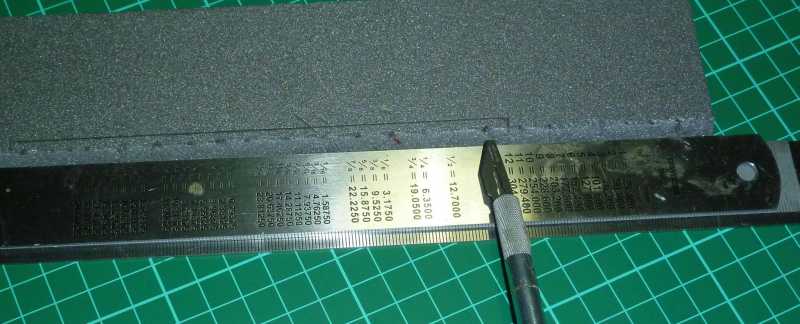

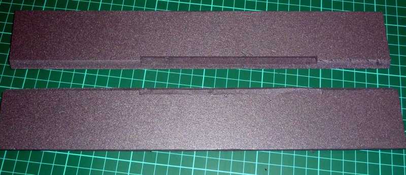

All the control surfaces are hinged on the top edge. Carbon stiffeners are added in the leading edges of the ailerons and rudder. The leading edge is cut at 45deg, so the carbon has to be inset to fit within the profile of the 45deg cut. To get a straight line on the edge cuts, I piled up steel rules as a guide.

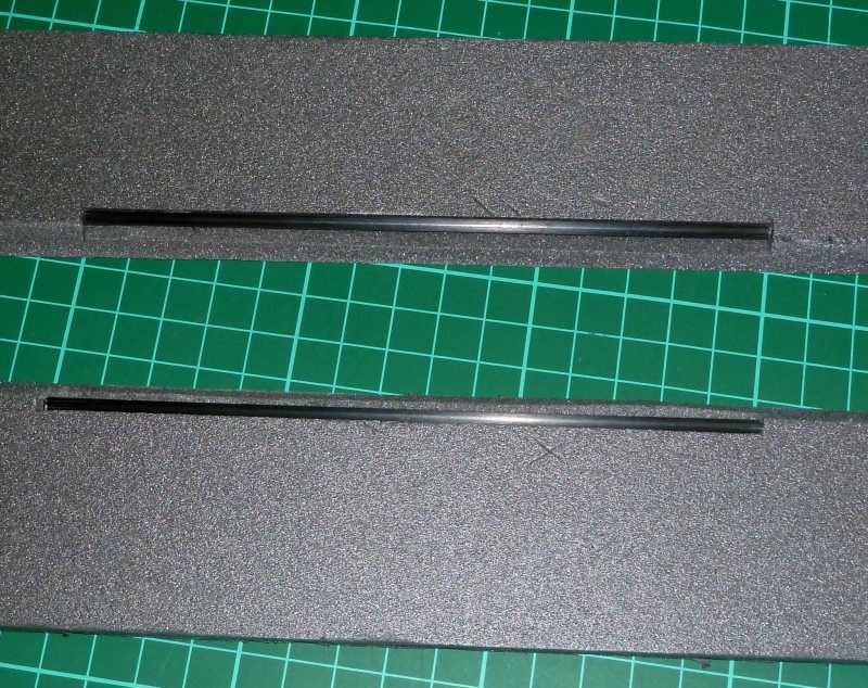

The cutouts for the carbon in the ailerons
The carbon stiffeners in place

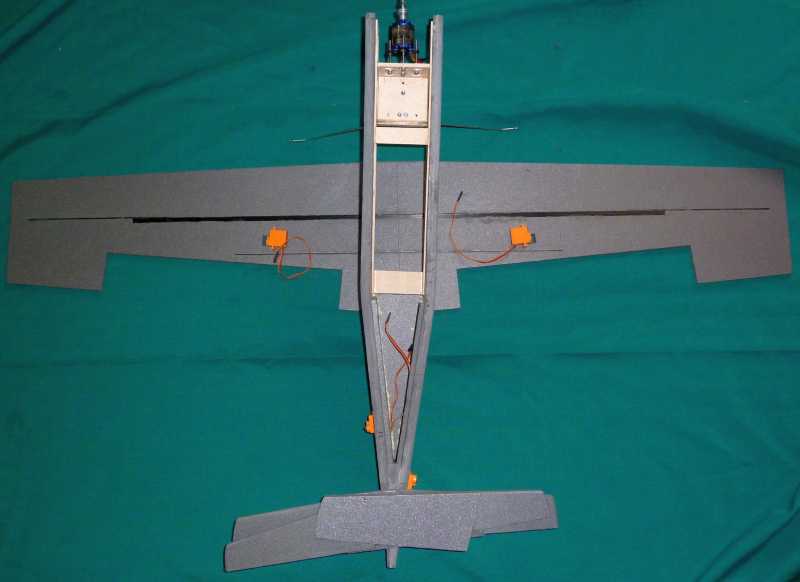

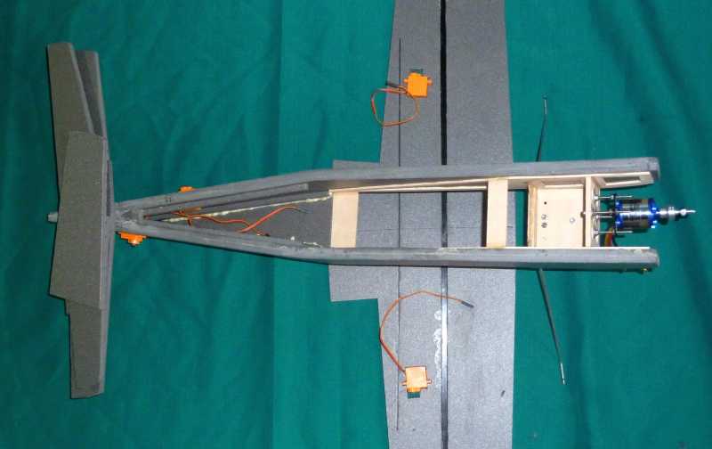

Just put the major things loosely together, and the good news is that the battery will be over the CoG, which is what I had hoped for.
Only major construction now is the rear deck, and then the canopy and front deck which will be removable for access. (although the wings will be bolt on, I hate having to remove wings to change batteries).
