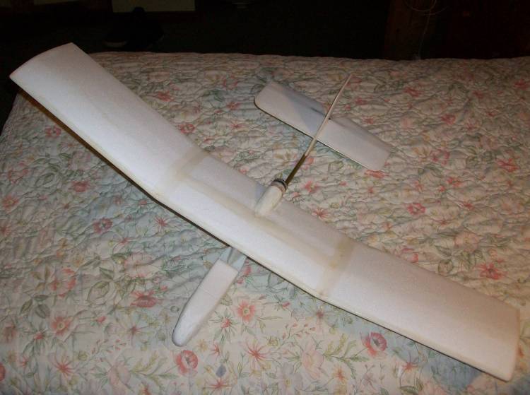

First the wing made up of three 12" panels, the centre flat with generous dihedral outer panels. Rather unusual construction with no spar, just the Depron skins drawn over Depron 'spacers'. At 6.25" chord and 1" deep giving a fairly generous 16% t/c ratio.
In effect a hollow foam monocoque. The two wing joints were reinforced with a tissue bandage glued on with PVA.
The complete wing weighs only 1.2oz yet held only by its tips it can support an 18oz centre load. This represents the stress approaching 8G with a 9oz airframe so it should not break under aerodynamic load. ;)

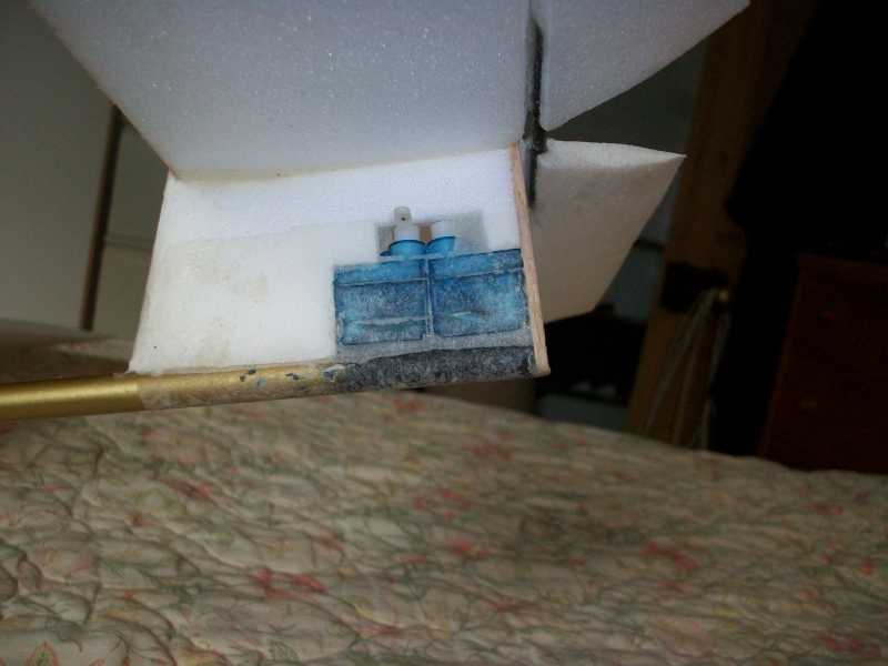

Following my usual practice the rudder and elevator servo are right at the back buried in the fin, in fact they provide most of the support the whole tail feathers. :ohmy:
The wing pylon, tail feathers and the rest of the fuselage are all built up from 3mm Depron (there is still 1/5 sheet left). The only balsa in the whole structure in the fin spar and I am not sure even that was really necessary. ;)
It looks like this.
It even uses my super cheap second hand 2.4 radio (£30 with 2 receivers).
By no means perfect it needed a big chunk (1/2oz :angry:) of lead and a over size battery in the nose but it flies well enough at 8oz all up.
It is being rebuilt to move things around a bit so it should end up 1oz lighter.
