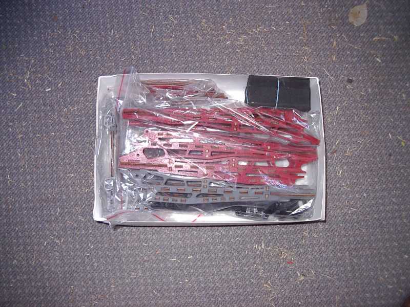

The whole thing arrived in this box

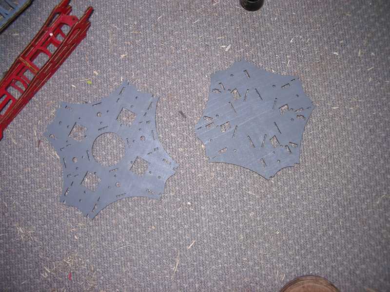

And this is what I found inside
22 Nov 2012 23:31 #7 by The Beard
Replied by The Beard on topic Re: Quadcopter
WOW exiting ---A BOX :woohoo:
22 Nov 2012 23:34 #8 by Klipkopwildlife
Replied by Klipkopwildlife on topic Re: Quadcopter
Notice the complete absence of ESCs and motors, The foam box at the top right is the controller, what is immediately apparent is, it's not a build but an assembly! The motors are in fact underneath the bits! I'm still waiting for the ESCs. The arms come already assembled.

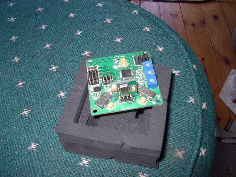

This came from a local guy, he admitted he'd forgotten the ESCs but never sent them to me!:angry:
This is the controller, I'm already worried because there's signs of soldering on the back!:(

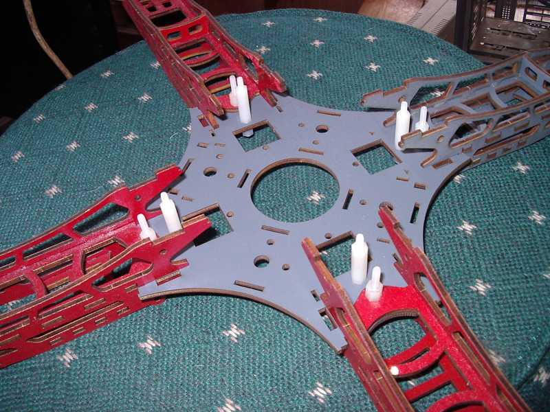

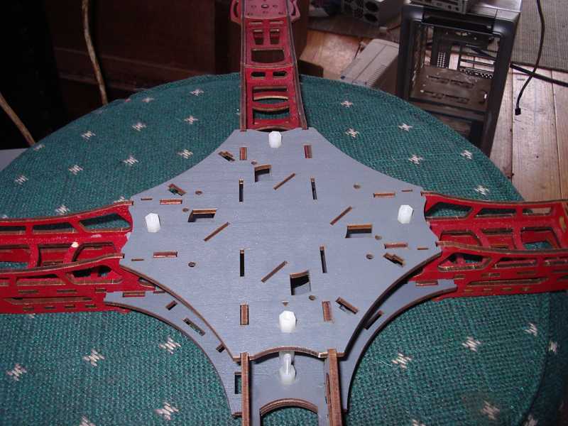

The arms

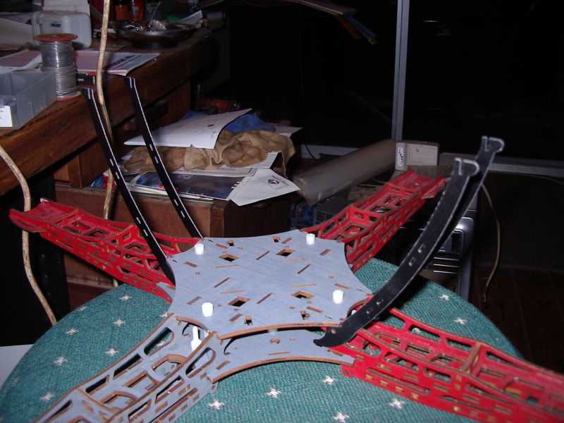

First mistake, I assembled all the arms onto the centre pieces!
You can't get the ESCs in!:angry:
Note one arm is a different colour, this will be the leading arm when flying forwards. The Control board comes pre-programmed to fly + configuration, that is one arm leads. You can re-program to fly X configuration, which I understand is more stable.

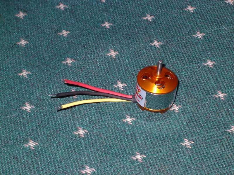

The motors are marked BL-2212/13 and are no-name brand

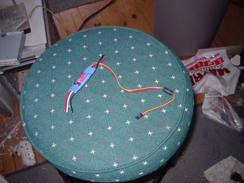

and the ESCs are TowardPro 18amp $9.99
The web site says they are TowerPro, this is a lie, they're knock offs!:angry:

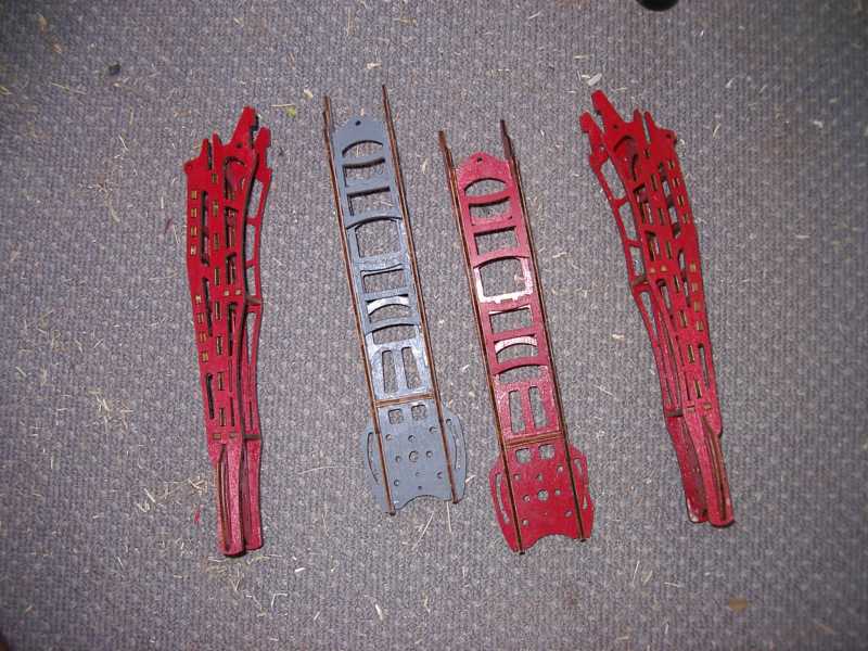

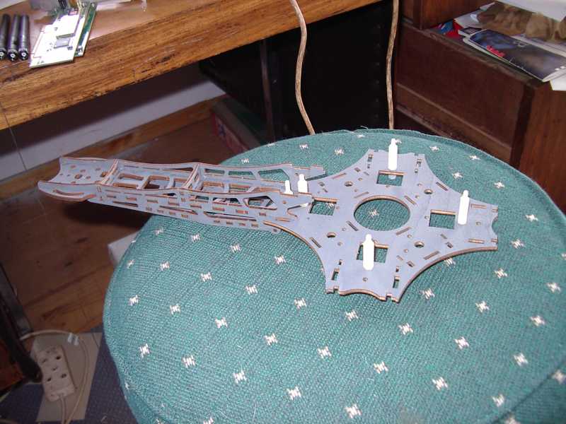

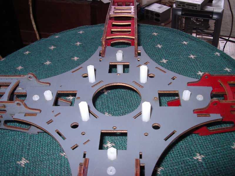

The inner bits have to be separated
And the UC legs
Looks very flimsy to me!
Last edit: 24 Nov 2012 19:25 by Klipkopwildlife.

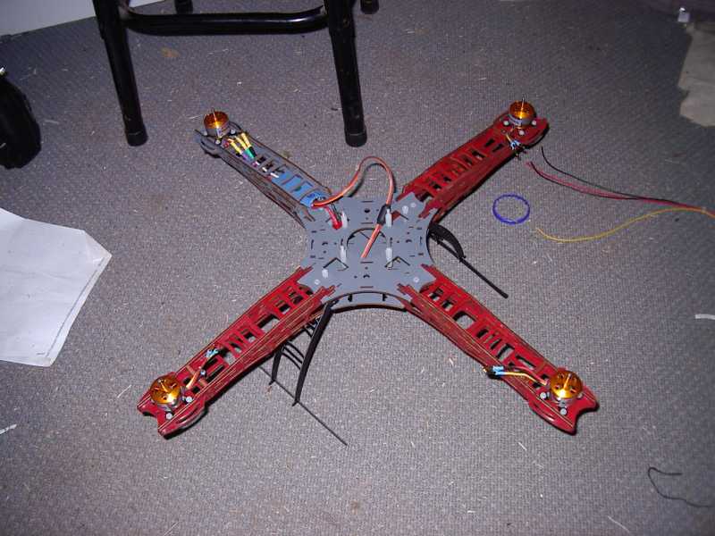

24 Nov 2012 20:15 #15 by Klipkopwildlife

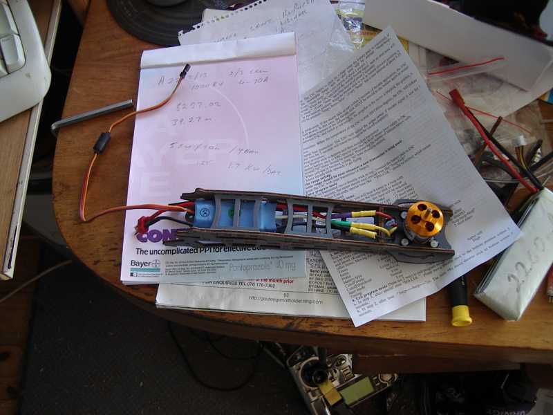

The motors are simple to fit, a large number of 3mm nylon screws and nuts are supplied, once again my local man ripped me off and I had to order more from HK.
I found that I could get the ESC inside the arm.
As the assembly goes on you're conscious of adding weight, do not be tempted to use steel nuts and bolts!
