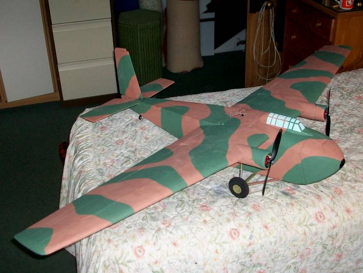

And just to continue the other build thread the Hamilcar is now complete - again!
It weighs 32.3oz with 2200mAh 3s. A wing loading of 7.5oz/sqft and has a good 120W/lb.
But until I have somewhere to fly it and the weather - it stays hanging on the wall!

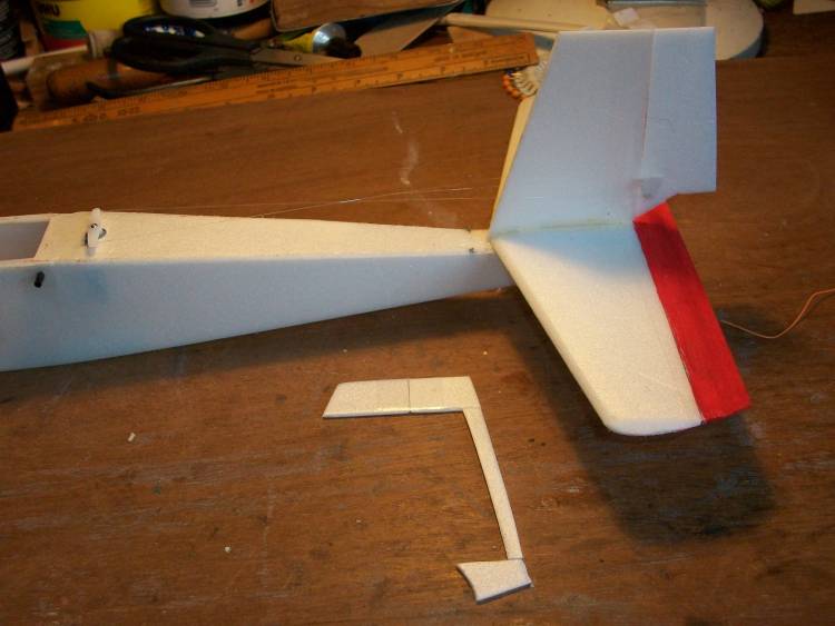

The first ruduction in the Wren's fin & rudder area.
From this (as in the video)
To this
A reduction of close to 30%.
With a further 20% taken off it will have about the same area as the twin fins.
Last edit: 05 Feb 2013 02:29 by Quorneng.

A quick up date on the Wren.
As I hoped it flies just as well with the reduced fin and rudder, in fact in term of handling characteristics its rather better. :)
Still glides like a brick with the wind milling prop. Unfortunately the 10A ESC does not appear to be programmable. :(
So the fin and rudder are reduced some more.
Mostly from the rudder this time.
The remaining area is now quite close to the 'tall' twin fins I had on earlier so if this 'small' single fin is ok I will refit them but at least initially I might leave a small fixed centre fin - a la the Manchester! ;)
