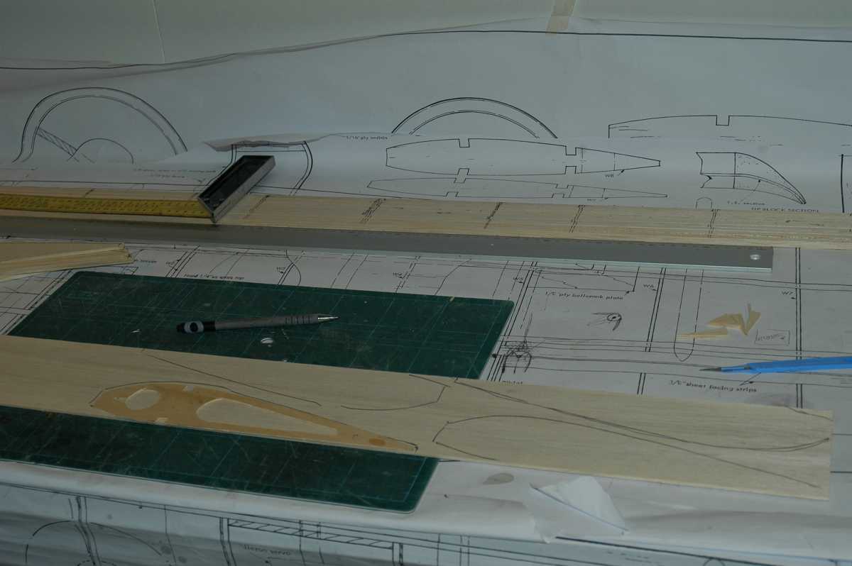

A local model shop said to me if i build these fun fly models he would sell them :unsure: so i thought lets see what is involved, both with time and materials.
I decided to do three all at once, based on the Magic that i fly, ill cut all the parts for all three of them first
So i started on the wings,

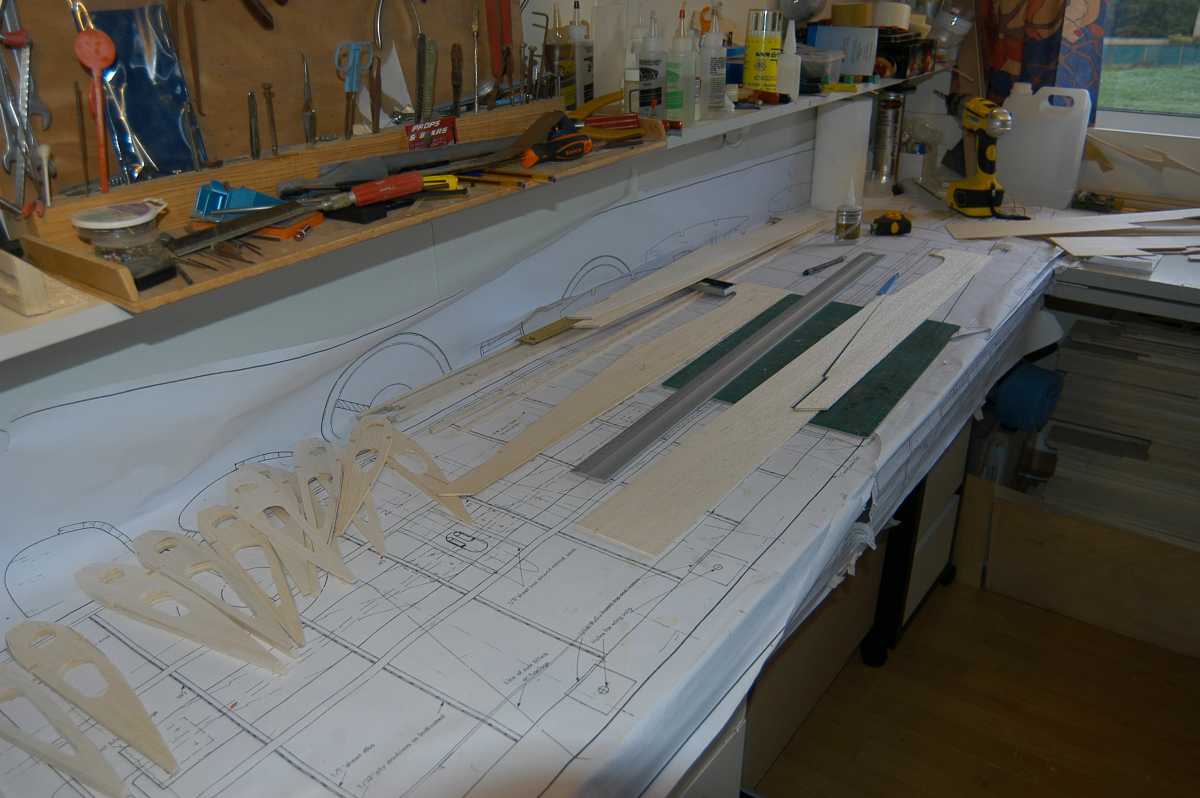

Marked all the 6mmx6mm spars, they are under the square, then cut the blanks for the ribs

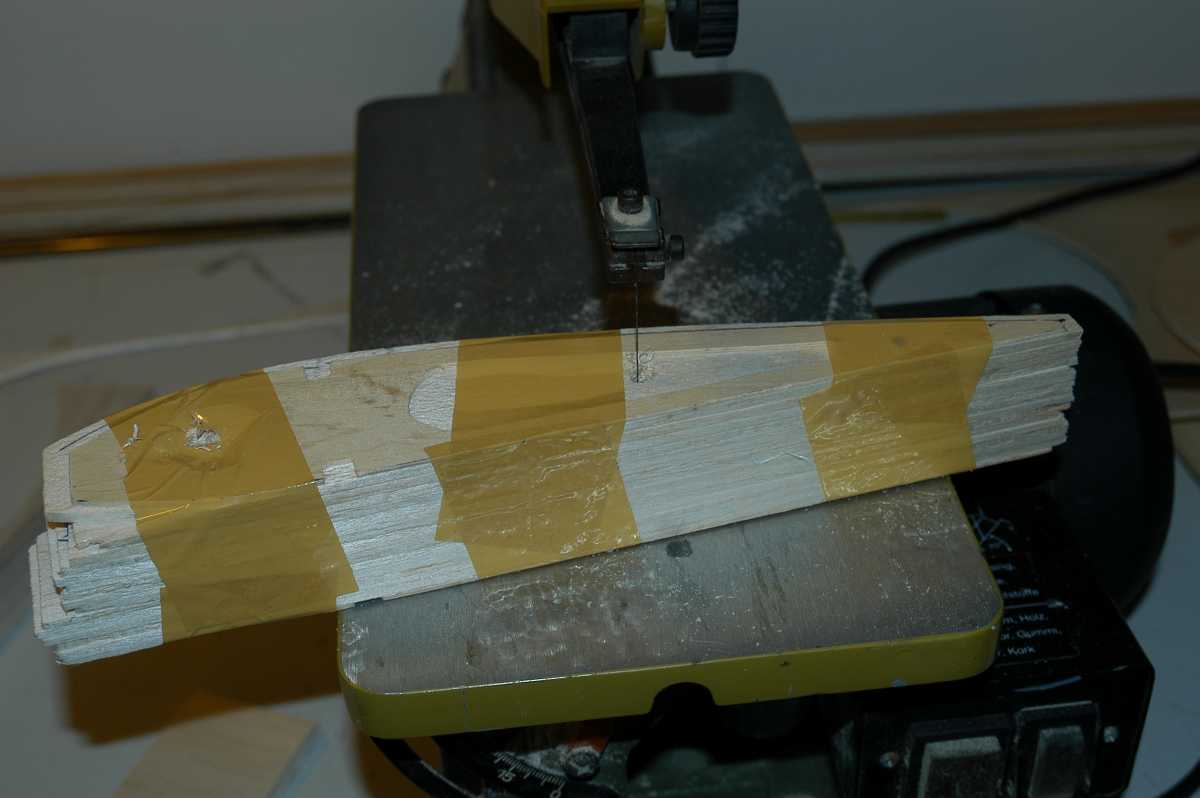

Bound the blanks up and ran them through the saw
Attachment DSC_0120.JPG not found

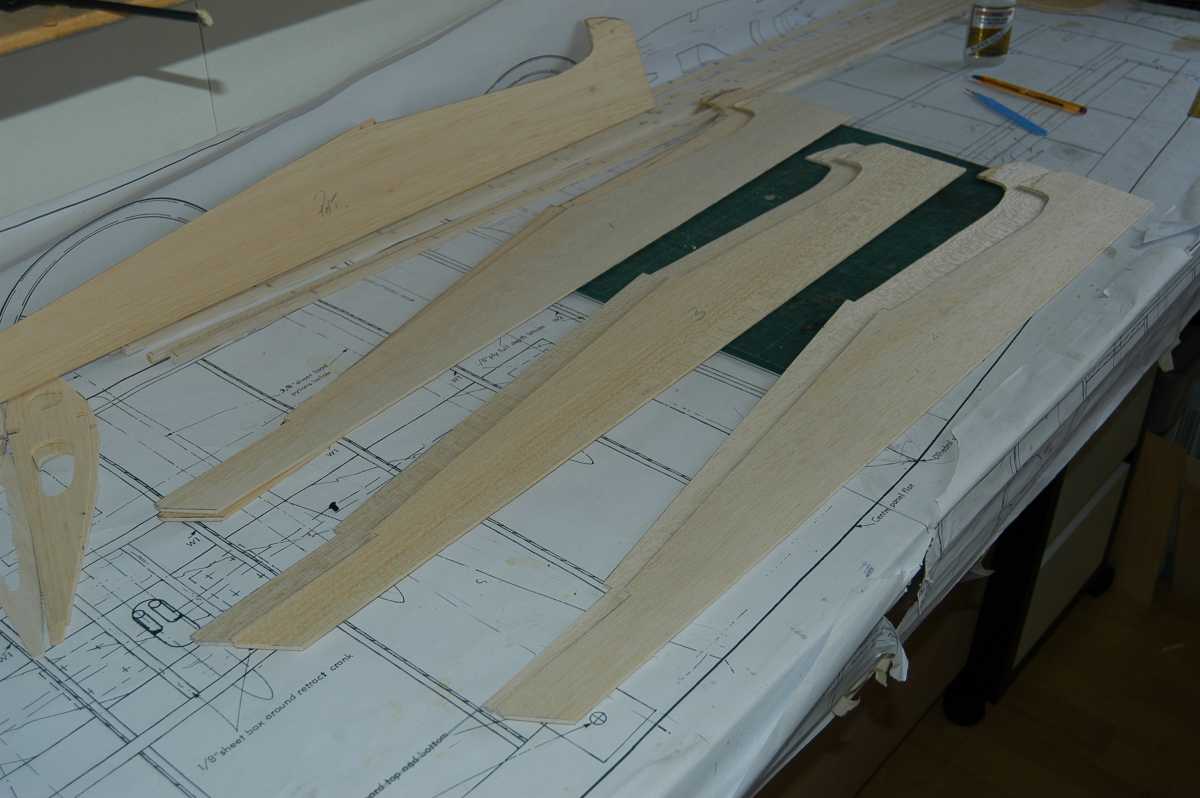

Im not working with a plan, im drawing the parts straight onto the wood for the patern

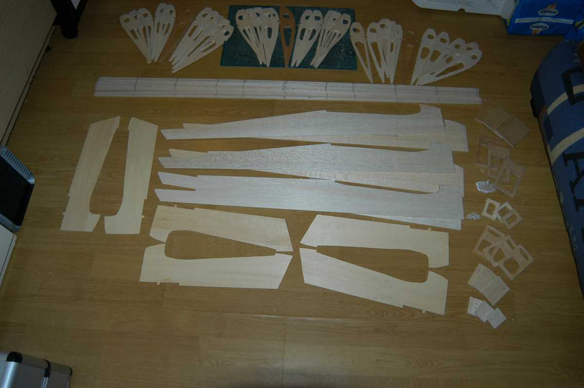

Then i cut out the fuselarge sides from 3/32 medium sheet and 1/16 ply doublers that go from the motor to the rear of the wing
and the 1/4 ply and 1/8 formers

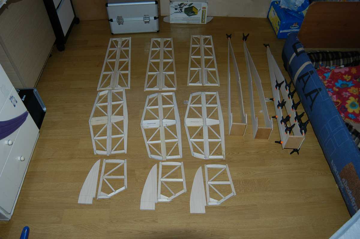

Here are the parts laid out for the fuselarge and wing
Here are the parts for the

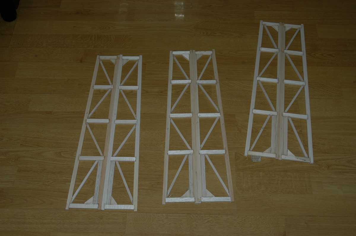

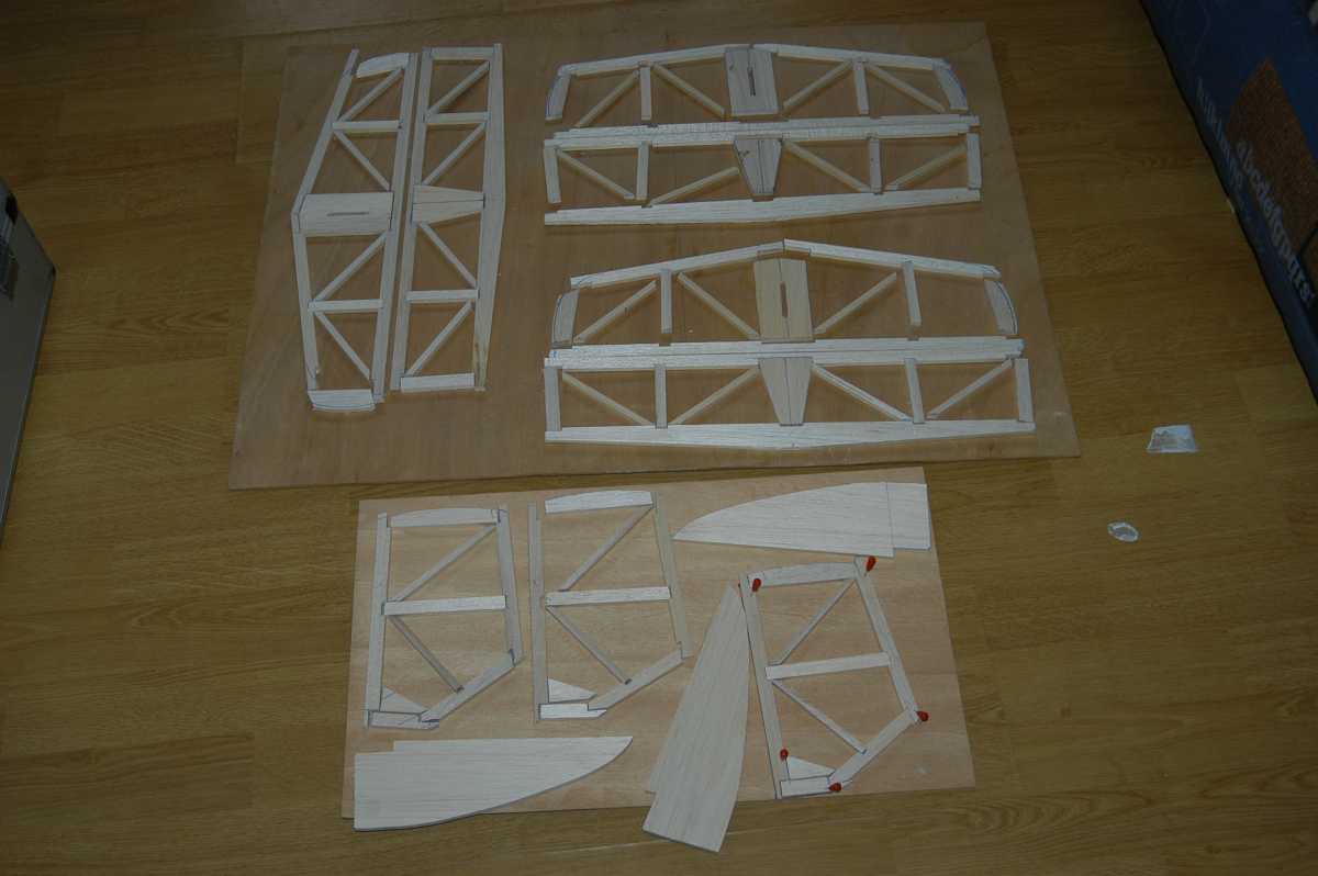

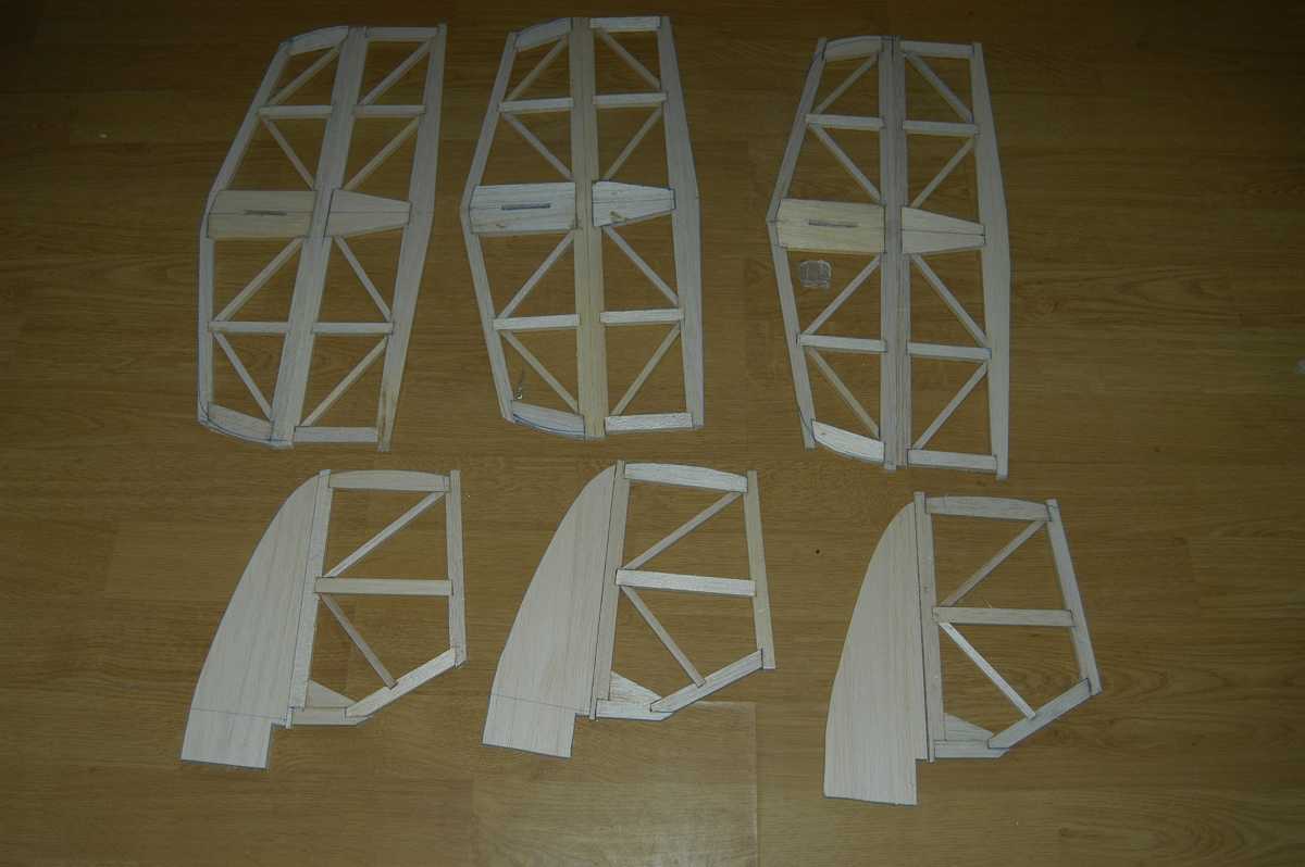

I cut out all the parts for the tail feathers and fin
Then built them up
Then did the same with the ailerons
While they were setting i put together the first former in thefuselarge sides

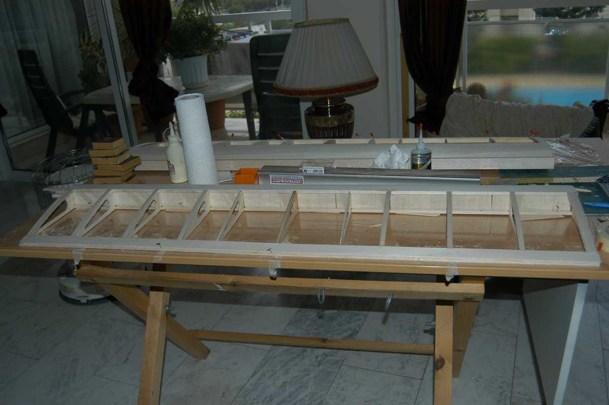

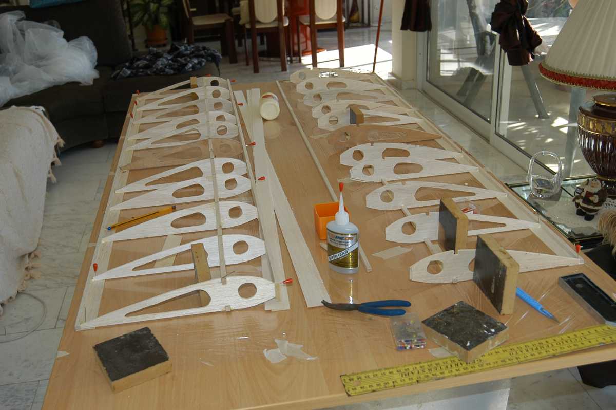

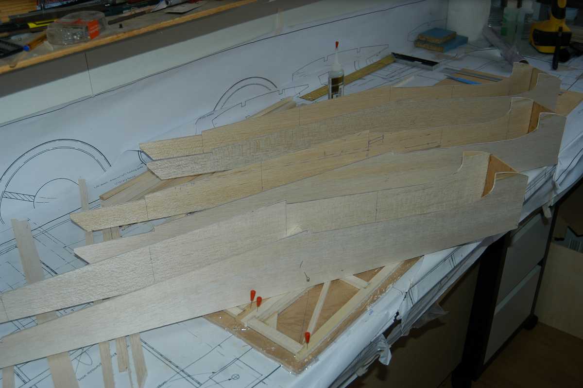

Got started on the wings, they are 1200mm long standard length balsa
Built two at a time
Then the thired one

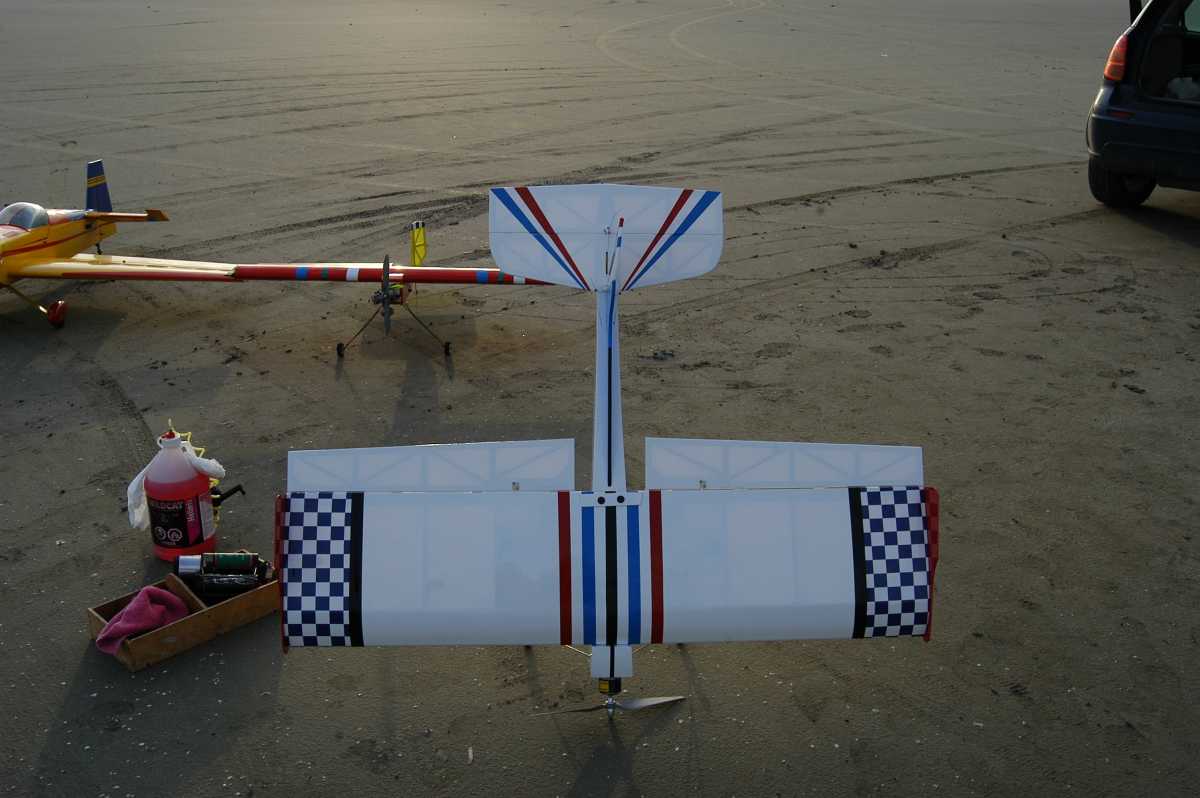

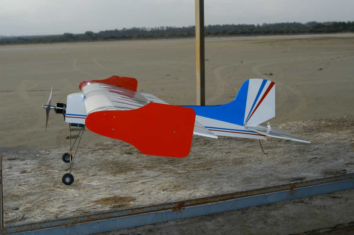

Well i seem to have lost or deleted a whole lot of pictures for this thread including the covering of the model where i managed to burn a hole in the wing with the hot air gun :S :S as the next ones i have is with the first fun fly complete
Sorry about that :( :( :(

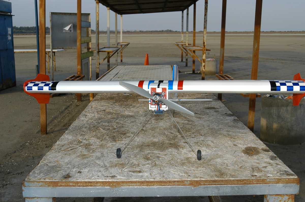

16 Feb 2013 04:43 #10 by THE BLACKBIRD
Replied by THE BLACKBIRD on topic Fun Fly build

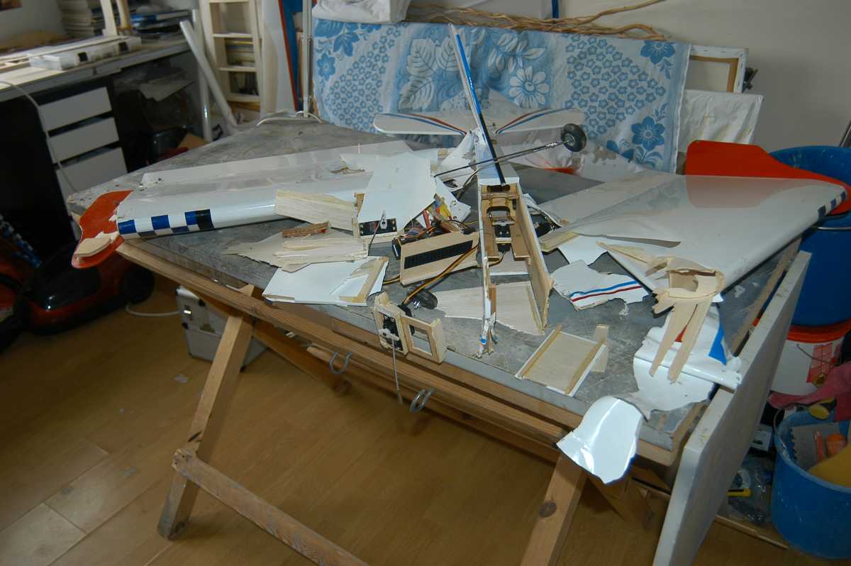

And then five minutes after i took this picture it looked like this
It was flying great, very adgile and smooth when from about 100 ft up it dived into the ground with no responce to my up elevator crys :S :S i thought it was the radio gremlin again but on inspecting the wreckage i found a nut had come off the up elevator control horn, stupid Tony had fogotten to locktite it :ohmy: :ohmy: :sick:
