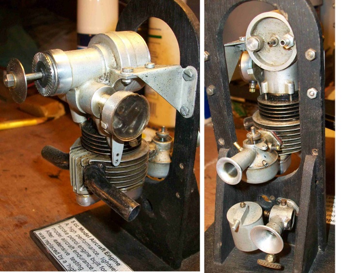

Finally I have decided to 'retire' my Dads home built petrol 5cc four stroke which incidentally was made some 12 years before OS released their first 4 stroke in 1974.
I had hoped to fly it and although it runs fine with a big coil it is hard to start and ticks over poorly on a miniature one. I could buy a CD system but it would require some modifications to install it.
This coupled with its irrepairable nature (at least by me!) means that flying it is too big a risk so it is returned to its original display stand that my Dad made which is securely located in a custom wooden box.
Never intended for aerobatics it has a float carburettor. The original side float version (below) was replaced by one with a annular float and a bigger venturi.
It runs on straight petrol as it has a dry sump lubrication system.

Thats to be treasured, i am well able to do repairs, re the poor starting whats the compression like? pour something thin, like wd40 in the ports, turn it over, does it bubble past the ring? could be it just needs a better ring, and i have a man for that who makes rings for a semi retired living, but, if you just want to display it, fair does, has he any more engineering wizardry? and do any drawings exist for this engine?

Alan
The problem is really its coil/contact breaker ignition system. As its only 5cc it really can't carry too much dead weight.
On an 12V automotive coil it runs very well and starts with the flick of the finger.
However on a miniature 3V job the spark is weak and that's when starting/slow running becomes the problem and without reliability the risk of crash damage is just too great.
In terms of engine hours there is no real problem as it was designed specifically for long life, hence the positive lubrication system. Indeed you can see from the smoke in the video the lubrication is rather too positive at low revs. It really needs an oil control ring as well.

Judging by these drawings, well before computers, and cad, and your posts here, then i would say that you have some brains in your family!! lovely drawings, and so easy to understand the structure and design of the unit, as for the ignition, no idea :silly: but unless you go for a re-machine on the prop driver, and you can time the engine, i would showcase it,

Back to that engine Simon, you could use a Rexel unit and glue the magnet on the points, then position the Hall effect sensor carefully, it'll give you a good spark.
